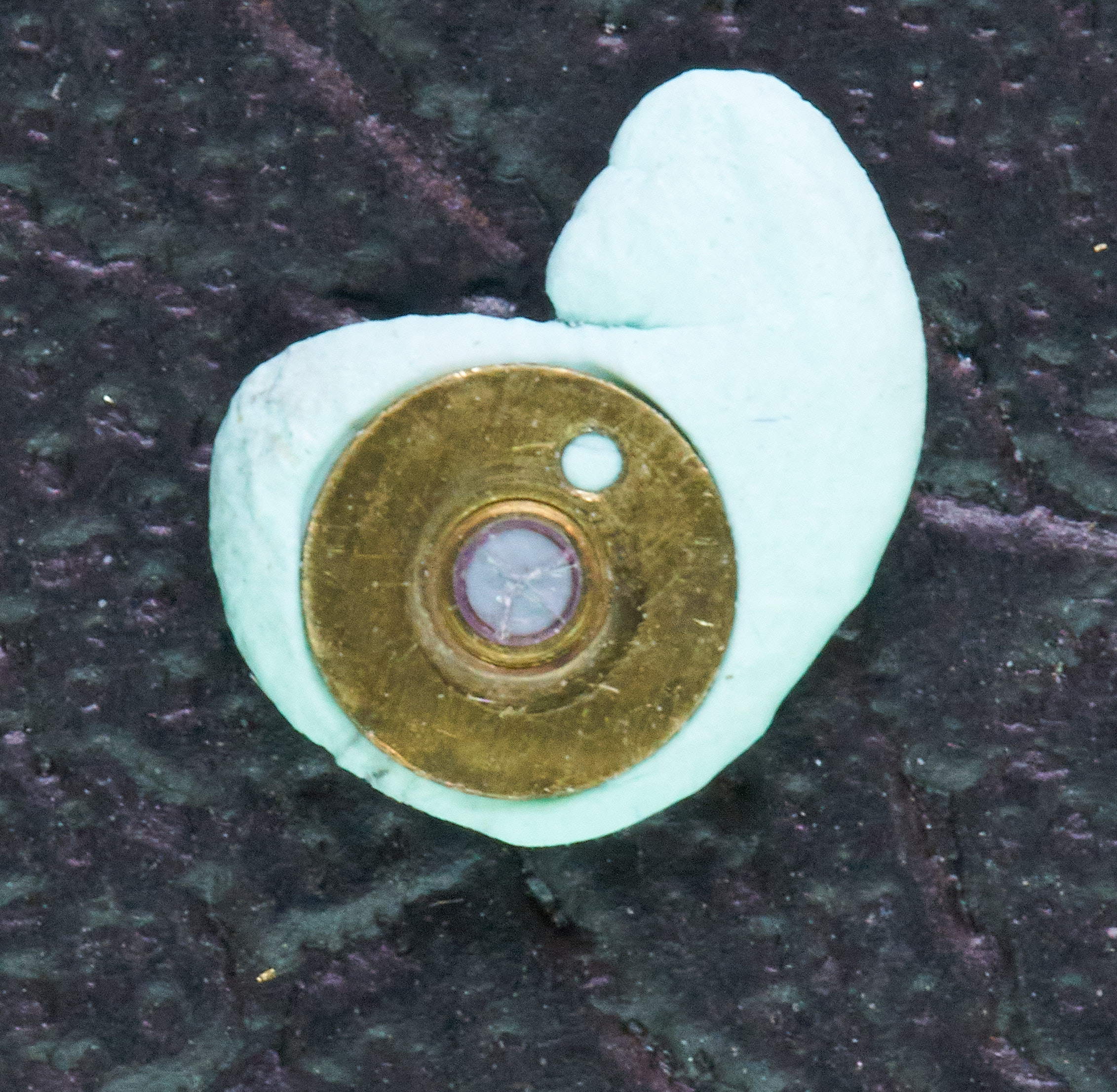

Replacement cap jewel - fontainemelon
And for that money I would much rather have a shiny new Longines or a Tudor 1926 😁 Tom
Areed. Unfortunately, In this case, as IWC donor watches are so expensive, it leaves no room for selling. It took me over 10 years to source parts for an Cal 630 to repair a broken 3740 watch I purchased. Now everytime I see a rare case on ebay, I think twice about passing on them. Thanks for taking the time Alan
