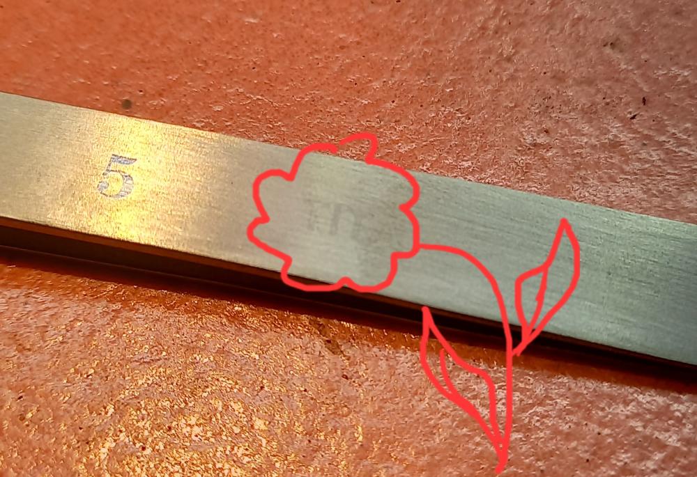

Ok so I've just done a scratch test with some titanium tweezers i bought from cousins six weeks ago for 7 quid. And was very surprised at the results. Using the back of some non magnetic tweezers as a scratch bed. Standard dumont antimag tweezers scratched the test bed very easily, brass scratched a faint dull brass colour  ( removed brass from the tweezers ) and titanium a faint dull scratch. Nothing like the marring obtained from the dumont tweezer.  So i give cousins cheap titanium tweezers a big 👍👍👍👍👍, wish I'd bought the set of 3 now for 12 quid .
