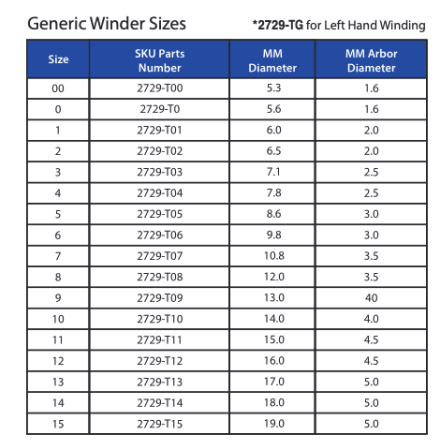

One of the things I will need to start thinking of is a mainspring winder for this sucker.  I can't afford to buy a whole set of them, so how do I figure out which size I need?  I'm looking at a chart that Esslinger has and iit asks for a MM Diameter (is that the INSIDE diameter of the barrel housing (or is it the outside diameter).  Arbor diameter I think I understand.
OR should I just not take the mainspring apart?  The watch is about 6 years old, so I think the right thing to do would be to open it up and clean and lube it.
