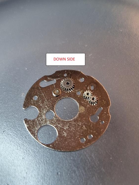

Thank you for your replay! I put up some photos of it without the calander ring, hope it helps!
If you look at the intermediate wheel between the hour wheel and the date driving wheel it looks like it is upside down. It may be the angle but it looks like the pinion should be downward to engage the tenth of the date drive wheel. This could be pressed by the dial and therefore stopping the motion works.
Tom
Also, the missing intermediate wheel is on back side of the plate among other wheels!
Tom
Thank you! I'll take a look at that when I get home soon!
Tom
Never seen a third layer of teeth before but there you go. So that shouldn't be the cause of the problem, seem to work as it should!
It seems to be working after a few winds for a couple of seconds, and then come to a stop. Mainspring issue? Gah, really would like to avoid taking it apart.
