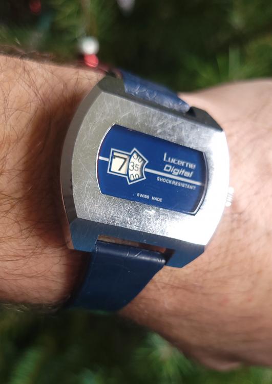

Recently got this guy from eBay. My first jump-hour watch, it was too cool and inexpensive to pass up.
A 1-jewel pin pallet movement was inside and it was not running when I got it. Full service (after losing the one jewel past the edge of the screen in my Fixodrop bottle) and a crystal polish later, and it's ready for the wrist!

2 hours ago, Endeavor said:
That's a great watch! and so is the amplitude 🤔
hah I'm pretty sure it's due to the sounds of pin-pallets being different from a Swiss lever.
I feel like there was some talk recently of a forum user here who'd made software that was more accurate for different styles of movement like this. I'll have to check my bookmarks.
3 hours ago, ManSkirtBrew said:
Fixodrop, not Fixodent, you silly.
You were right first time msb lol. Funny though, maybe worth remembering for dislodged component teeth.
If its keeping time and lasting somewhere around the reserve,  i would wear it.
