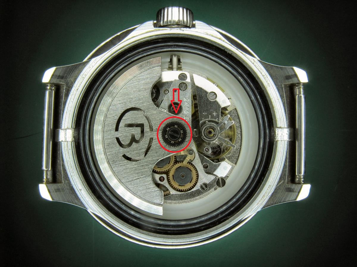

    • The roller table is supposed to be held on by friction. If there is shellac under the roller table it might indicate that an improper repair had occurred prior to this as it would not be held in place with shellac. Sometimes overenthusiastic people re-shellacking the roller jewel will get shellac where it's not supposed to be. Then the picture of your roller it looks kind of damage? It doesn't quite look right it looks like somebody held with a pair of pliers or something? Then your balance wheel has limited quantity of screws? Not necessarily a problem but an indication of perhaps with the other things a prior bad repair perhaps as a guess.
    • Quartz watches like mechanical watches need to be serviced from time to time. In other words the lubrication with time we'll go bad and the watch Will not run or will not run very well in other words oh be slow because the gears are no longer turning properly due to bad lubrication. Then other things bad for quartz watches basically anything dust that normally wouldn't affect the mechanical watch will affect the quartz watch because the quartz geartrain has extremely little power. So looking at your movement up above more than likely you'd have to clean it and lubricated before the new circuit would work.
    • I be concerned if this roller table belongs !   Timegrapher will ask,  where did you get this roller table or balance staff from?   Regs
