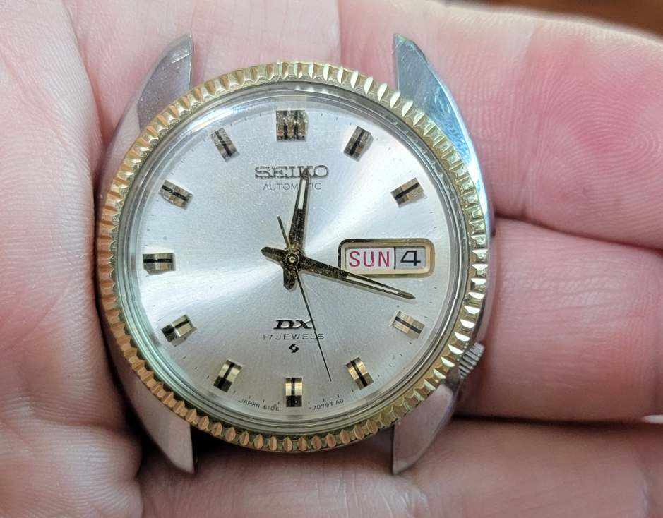

Second Seiko service!  The keyless works were messed up.  It showed up with a busted stem.  The new stem would not insert, so I knew something was wrong.  The setting lever jumper was bent upward and disengaged.  Other than the dealing with diashock and kif, it was a pretty uneventful service of the movement.  Well...it did take me close to an hour to service the mainspring.  I realize now that I had the teeth on my winder closed too much, so as I got close to the end, it was binding.  Lesson learned.  I was having trouble getting the stem in.  First time, I knocked the setting lever jumper off track.  I took it off and did another bend'  Had an issue with the casing but it was my own fault--not paying attention.
Trimmed down the stem and installed a new crown.  Seems to be working fine.
This watch has been worked on before...perhaps several times.  That second hand does not look genuine...maybe replaced during a previous service?  Dunno.
