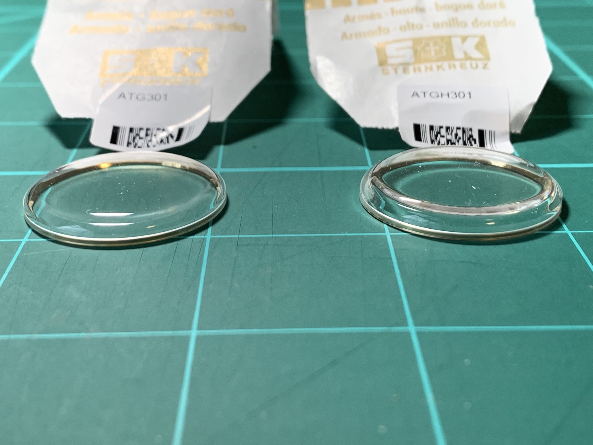

Here's an update in case anyone else is mystified by the array of crystal options out there.
I ended up ordering two crystals from Cousins. The Standard and the High Dome. Standard was closest to the OEM crystal in look/shape/height (although just a tiny bit lower) and High Dome was three or four tenths of a millimetre higher.
I installed the High Dome along with a new leather strap. I'll wear the watch for a few days to see how it performs before the movement goes into my servicing queue. Some related photos:
