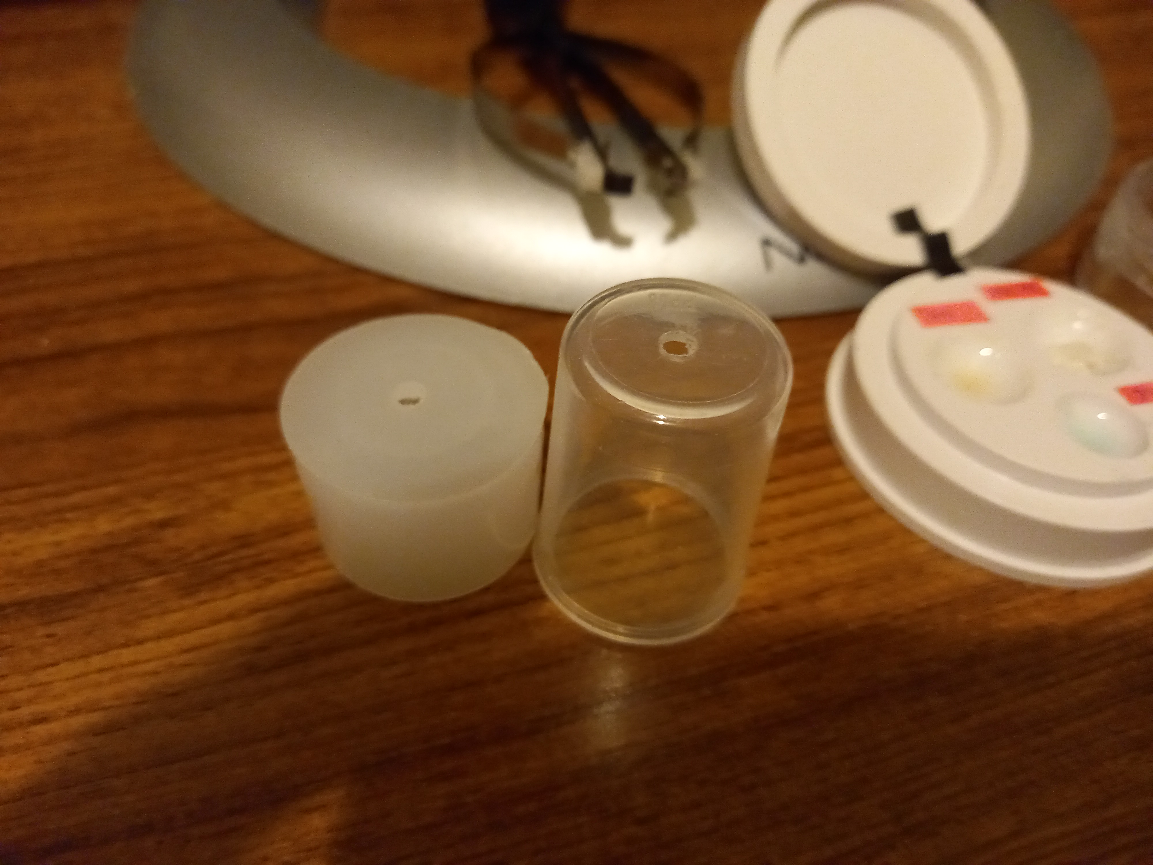

I made a mainspring Barrel press from two different sized shampoo tops. A small hole in the centre of each makes a gap for the arbour.

Better show of Mainspring press

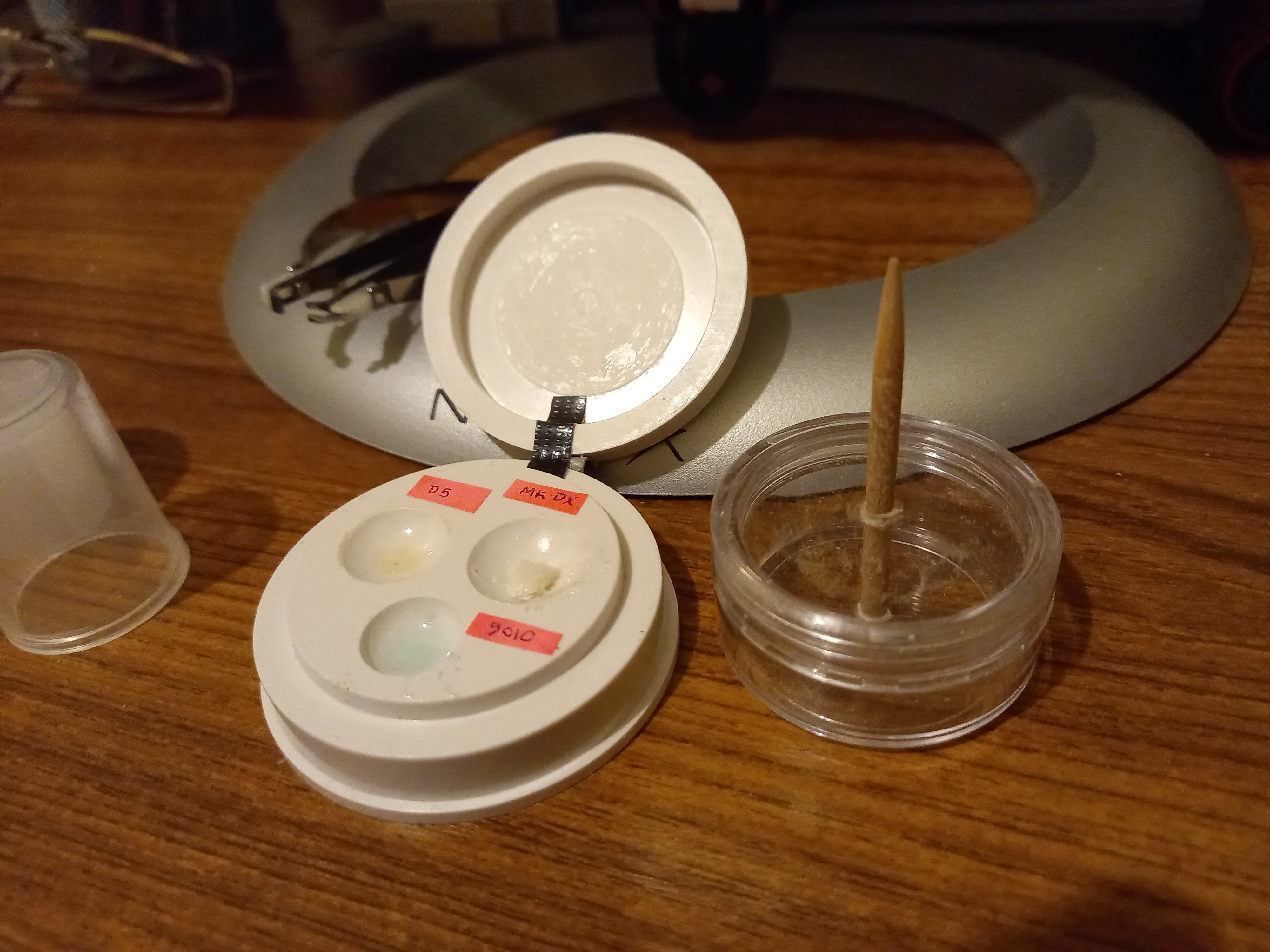

Balance cock support holder (holes in top and bottom of plastic pots, pegwood insert)
Oil holder. Tape to allow easy opening and closing for use.
Movement holder. Base enlarged so that it does not fall over easy under pressures.

I ĺike the barrel lid press Ross, i think thats a great idea. I know where you are coming from with the movement holder they can tip when placing any pressure on one side. With a tight screw or releasing a stem. Little tip with the balance tack as i hate to see the h/s stretching, place a piece of correctly sized foam over the shaft to create a table for the balance wheel to rest on. Use a dense foam as opposed to a sponge in case the pivot grabs . Something like an old yoga mat or those foam interlocking mats for kids.
