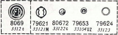

This is a 1-jewel, pin pallet escapement. The Xtensa, I assume, refers to the shock protection on the balance. It was extremely frustrating to take apart/oil put back together the shock protection. The cap stone was not captured in the normal manner - it rather kind of floated on top of a donut shaped plate that held the 'hole jewel' that is not actually a jewel, under the spring. I was trying to be extremely careful of not breaking the spring or losing anything as I didn't want to spend on a donor movement. After at least a couple hours combined for both sides I managed to get them together at least. I would seriously consider staying away from working on a watch with this shock setting in the future, unless the price was right and I liked the look.🙂

Medana did make some decent watches in their time, movements by MST were of good quality.  One Jewel ?   2 cap jewels over 2 holed, by my calculations last time i checked added up to 4. Strange ?

MST 434, also used in the Roamer brand, the few examples i found also strangely enough marked as 1 jewel. A basic watch would have 5,  these situated within the balance . 4 to accommodate the staff pivots and 1 attached to the roller also known as the impulse jewel. Strange that this is marked as only 1 jewel . Other movements in the 430s caliber are fully jewelled and labelled accurately. I thought makers loved to state as many jewels as possible.  Any thoughts anyone ? John ?
As far as the last question, isn't the visible cap jewel the only one you will expect to find on these 1-jewel movements, with everything else consisting of metal bushings and pins? The balance "jeweling" is not symmetrical.

I thought the OP mentioned doing both sides. So is that just 1 cap jewel on top of the balance ?Thanks for the explanation
There was a cap jewel on both sides. Maybe just some weird counting convention (jewels on one item).
