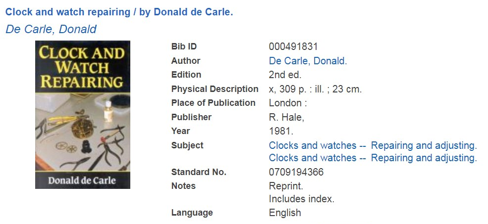

Hello Everyone,
Just got my latest Horology-oriented book from the Hong Kong Public Library:
It certainly has some very interesting stuff to say about clocks.
Does anyone have anything to say about this book?  Anything to pay special attention to or (conversely) to ignore?
For example, I think I will ignore the "tip" that cleaning balance springs with cyanide is a very effective but somewhat out of vogue method these days. 🙂
What I did notice was quite a lot of carry-over of clock oriented practice and techniques to wrist watches, up to and including having a block of chalk readily available on the workbench, right beside the vice!  Wow!  The only other time I've heard of using chalk on timepieces was in a rather informal free Amazon book about clock rebuilding.  Apparently, chalk was (is?) used on clocks as a "finishing touch".  Can anyone explain to me why spreading an abrasive, salty dust on a clock movement after cleaning and oiling it makes any sense at all?

Hi Graham   I have both his books , practical watch repairing and practical clock repairing  first publish date 1959/60, whereas time has moved on and the methodology has changed as has the watch and repair industry the fundamentals remain the same and are therefore in principal still worth sticking to.  The co-relation to clocks is that they are both time pieces and work in the same way the clock adding the strike and chime trains, watches date ,day complications and the chronograph. The chalk block was used for brushing the plates to achieve a lustre. Some what similar to the process of cleaning the clock/watch and putting the parts into sawdust to dry them out.  Bothe now outdated with the use of cleaning chemicals etc.  Both books are out dated in that respect as is the works of Henry B Freid but both authors explained their craft so the professional and amateur alike could understand the complexities of the Horological world and like any other text books are treated as a point of reference for information. I have quite a few books mainly on Clocks and they are used in that way, for information and guidence.
