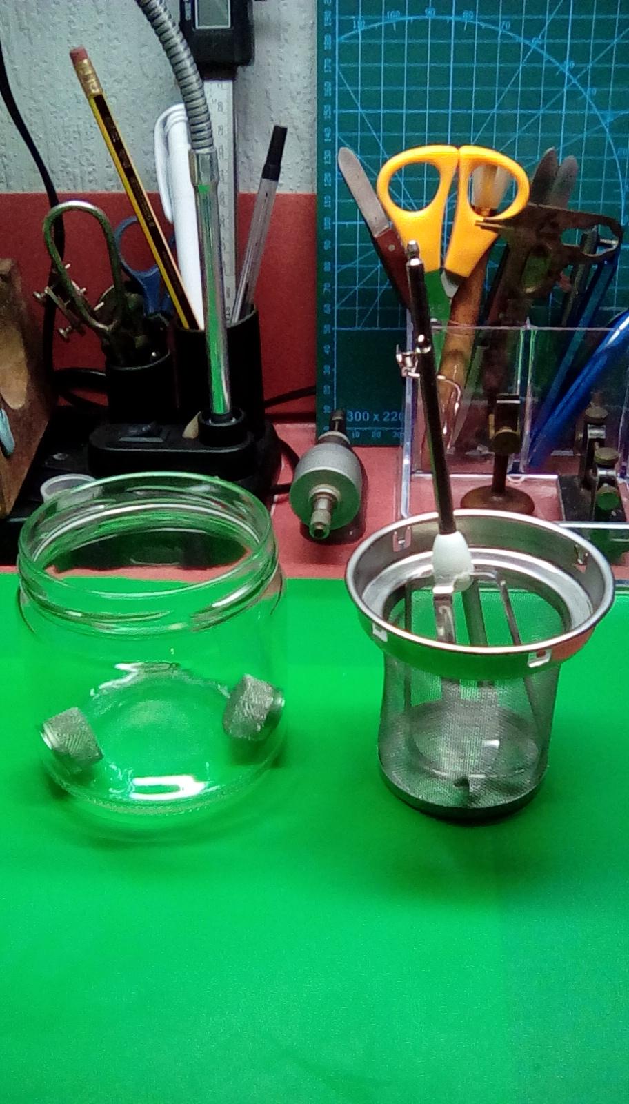

This reminds me of the old twin tub washing machine that my mum used 40 years ago. A side propeller, but that rotated first one way then the other to agitate the wash .  This method works best, but I do like the idea of the propeller then the fluid is passing over stationary parts as opposed to spinning them along with the fluid. I am curious as to how the cake mixer would work though. How about a whisk working inside a mesh cylinder inside a tub with the parts on the outside of the mesh cylinder. Or is this getting a bit crazy now, I can kind of see this working. Here is a very crude example. The whisk acts as a propeller, the mesh keeps the parts and propeller separate,  the train wheels keyless and screws would be in separate mini baskets and the larger bridges cocks and mainplate parts in fixed cheese holes compartments. No idea yet what I could use for a larger mesh cylinder, this is an infuser from a teapot

Another one.  It doesn't have to be a mesh cylinder just  a tub inside a tub to keep the propeller seperate .The inserted tub drill with holes . Or tbh not even two tubs just one tub and a holed separator disk between the propeller and the watch parts ? Definitely getting a bit wacko now 😀
