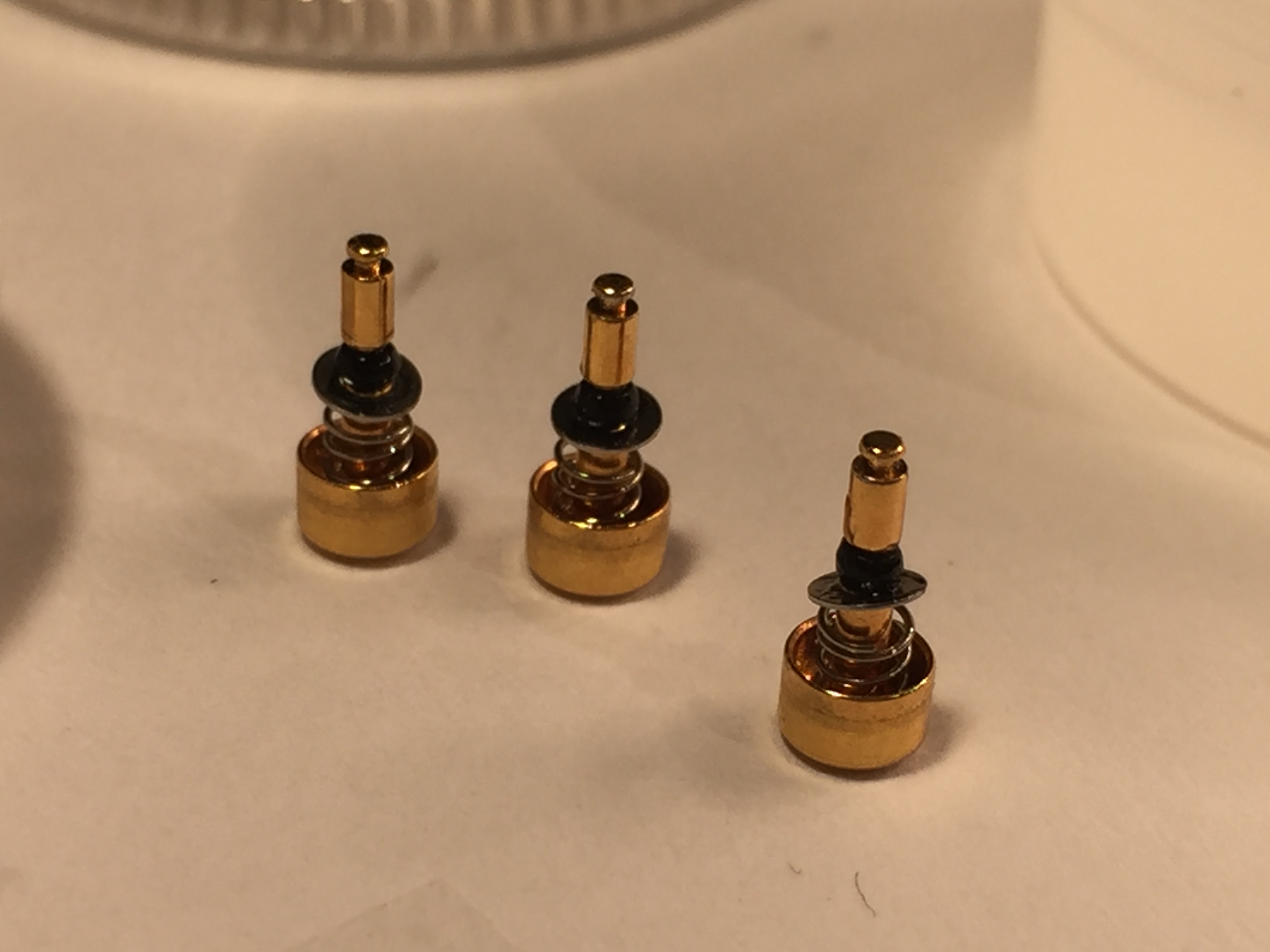

I am trying to find out a replacement push button for this vintage digital bulova watch. Can someone help in identifying which type to look for and best place to buy it
Thanks in advance, some pictures are attached including closeup of the slot

Well, those photos do not tell much.
You may want to find a good quality photo showing an identical watch. (see below)
This is a start. Then take a closer look at what you've got: a Screw In type or C-clip & Spring type of pusher in your watch.
Then search for replacement pushers:
https://www.cousinsuk.com/category/pushers-correctors

Thanks @poljot , I think it is a c clip type push button. I am going to take measurements and see if I can find one which matches it

Never get rid of old, broken useless, cheap, etc, etc watches as some of them may become a source of C-clips for your current and future projects :-).
Those C-Clips are tiny and somewhat tricky to install. All you need is to apply some silicone grease on C-Clip, stick it to the watch case internal wall just above the hole, insert the pusher and hold it in place with your finger while sliding down the C-clip using a flat screwdriver. This way the C-clip stays in place, doesn't jump or fly across the room ? and you do not wast your precious time on searching it for hours. If you do not have any donor watches with C-lips, i would order more than one C-clip (just in case ? ).
Please find some examples below when i simply removed all Pushers for cleaning as they were hardly moving at all.
