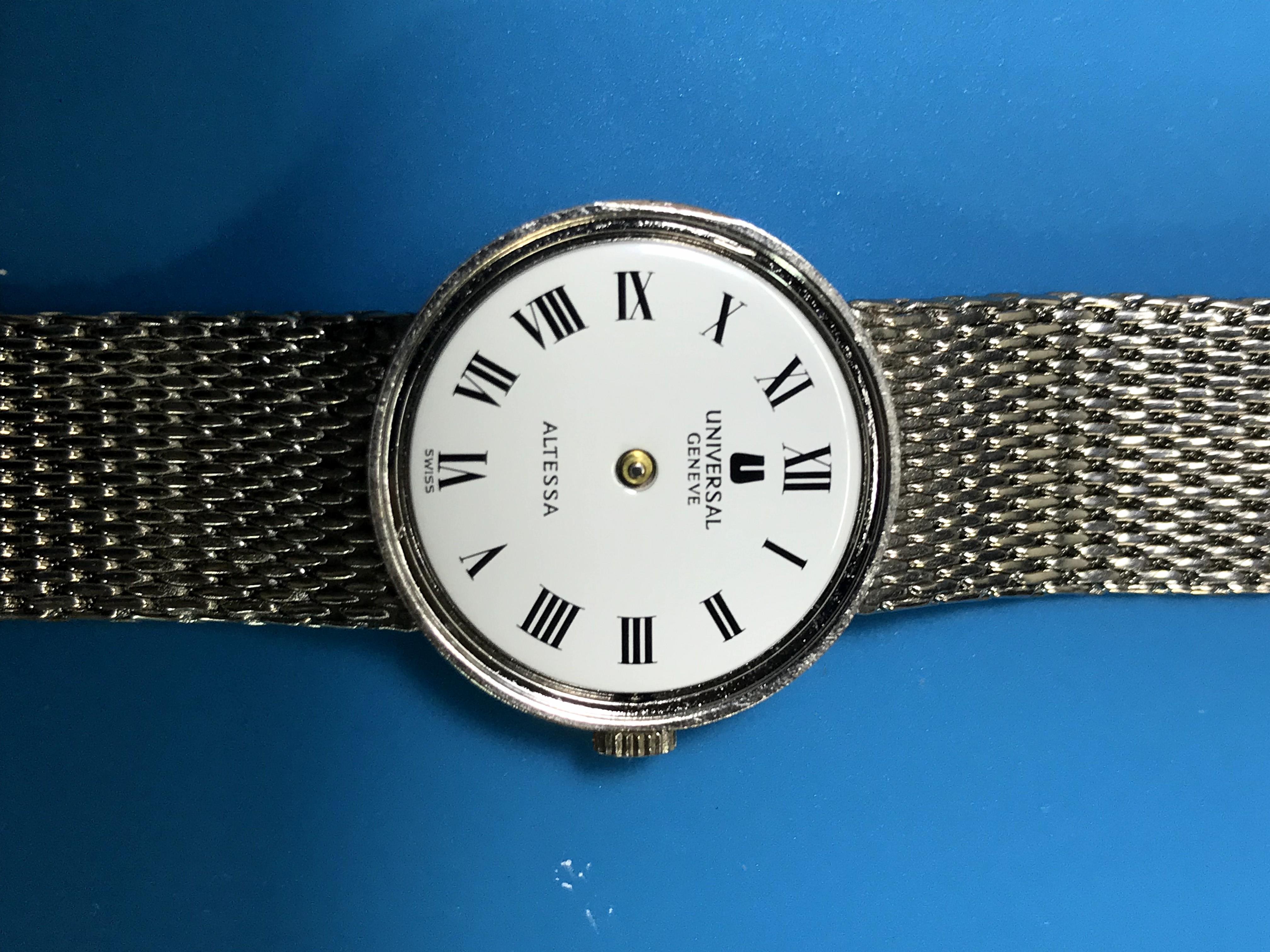

I brought this watch from a Chinese seller. The issue with this one is he can not wind the watch up. I suspect something happen with the mainspring or the barrel assembly. Besides that, this watch looks beautiful.

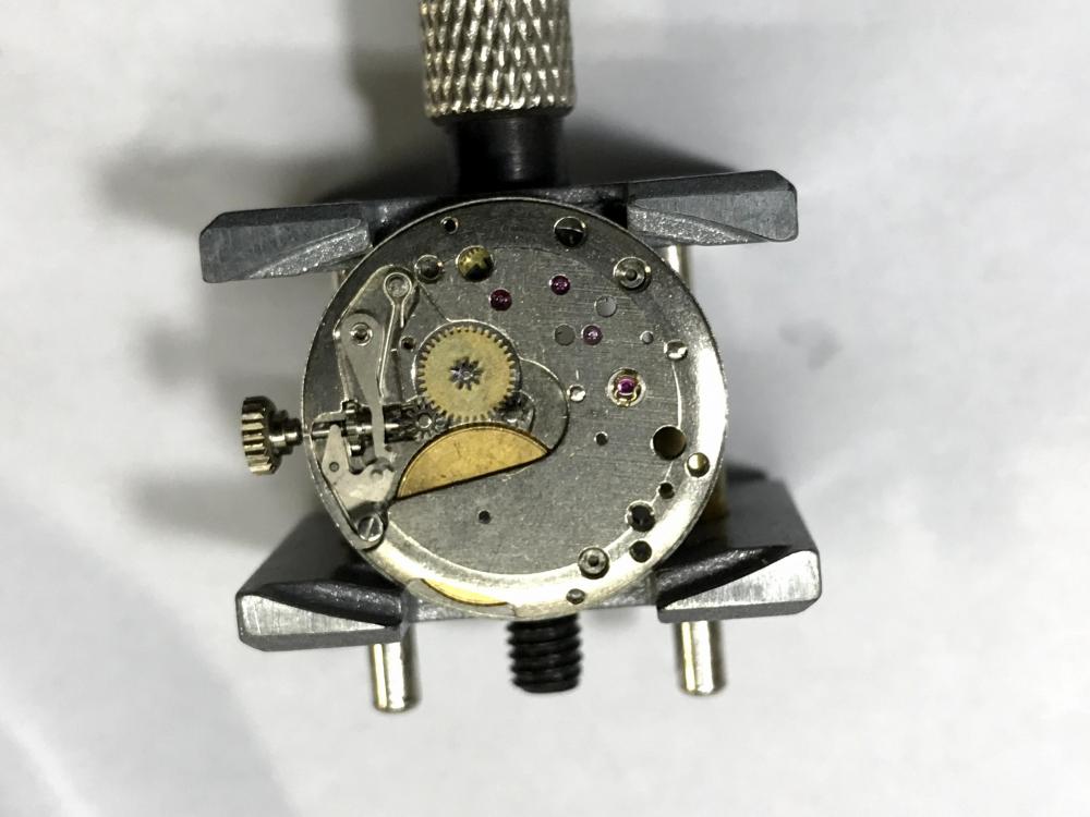

I take the movement out and start with some highlight of the disassembly since this is a very basic movement.
After I take out the balance and pallet I decide to take out the connon pinion. But then I found out this little thing is super super tight. I thought and it probarbly should, just some dried oil. So I have no choice but take out the rest of the train and drop the entire mainplate, connon pinion, center wheel and the barrel bridge all together into the cleaning solution and ultrasonic clean it for 10 minutes. After that it's still tight but I can use a clamp to take it out. Before that the pinion doesnt even moved.

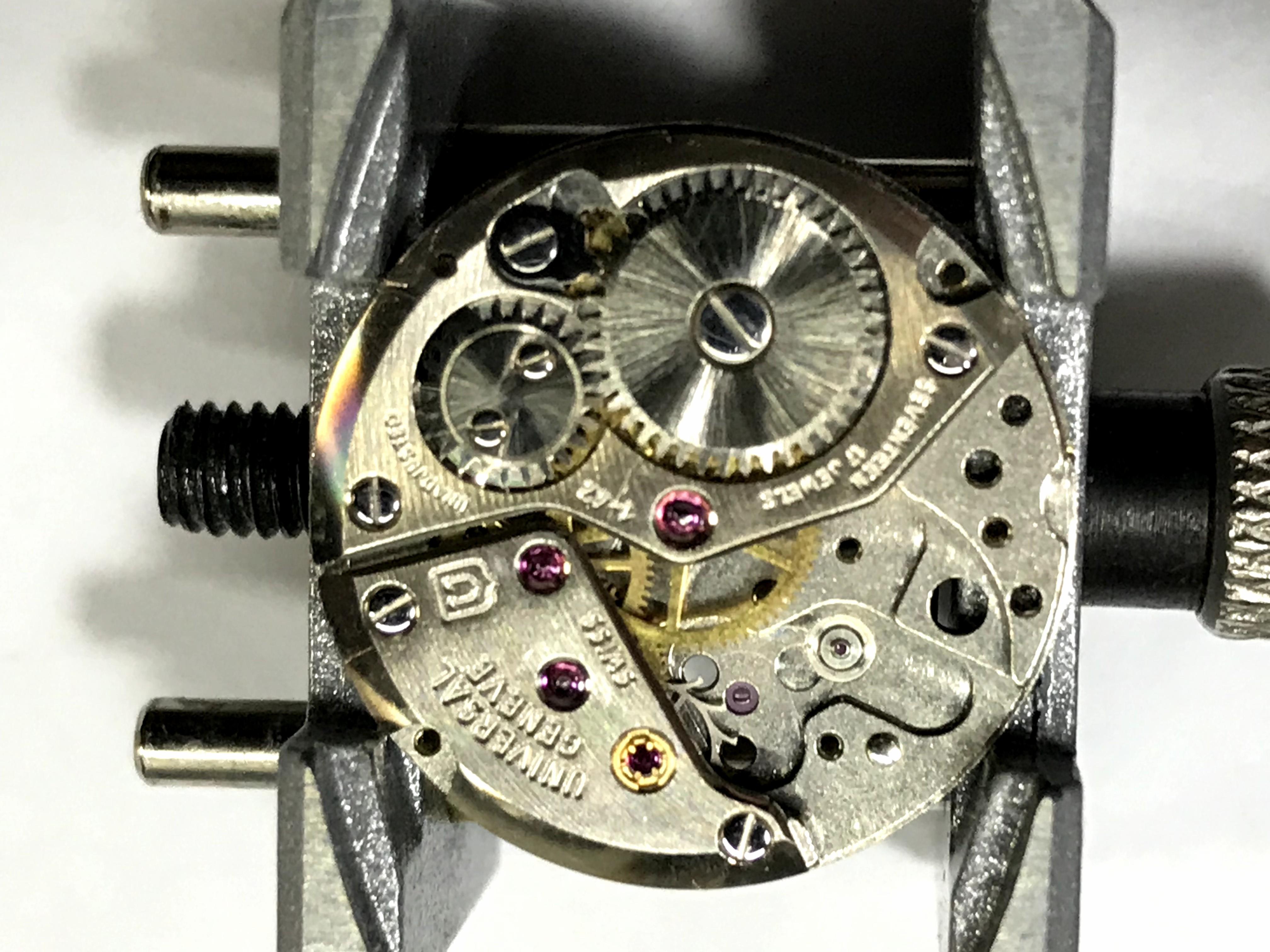

 Before cleaning I check the parts. All parts looks good except the barrel assembly.  As for the barrel:
IMG_7802.thumb.JPG.4a87629ef20ce81ef1a3502bb611c433.JPGIMG_7801.thumb.JPG.267afc92cbff3e8b49166cd4831adbb0.JPGIMG_7800.thumb.JPG.8c966e279bb61f9edcccce770ff93de4.JPG
it's dirty, that's for sure. The barrel looks wored but I think it can still hold the bridle.
The bridge is what cause the problem. At first I thought well it still have some bridle left there, give it a try. But, no luck.

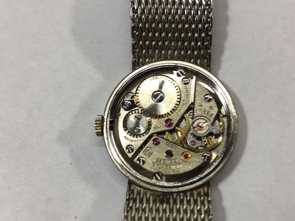

complete assembled.
About the timing. I dont get a very high amplitude with this movement. What I got is 240 dial up/down 190~200 crown down/up
But since the time keeping is good with this 4 position (±7~8s/day) I'm fine with the amplitude.
