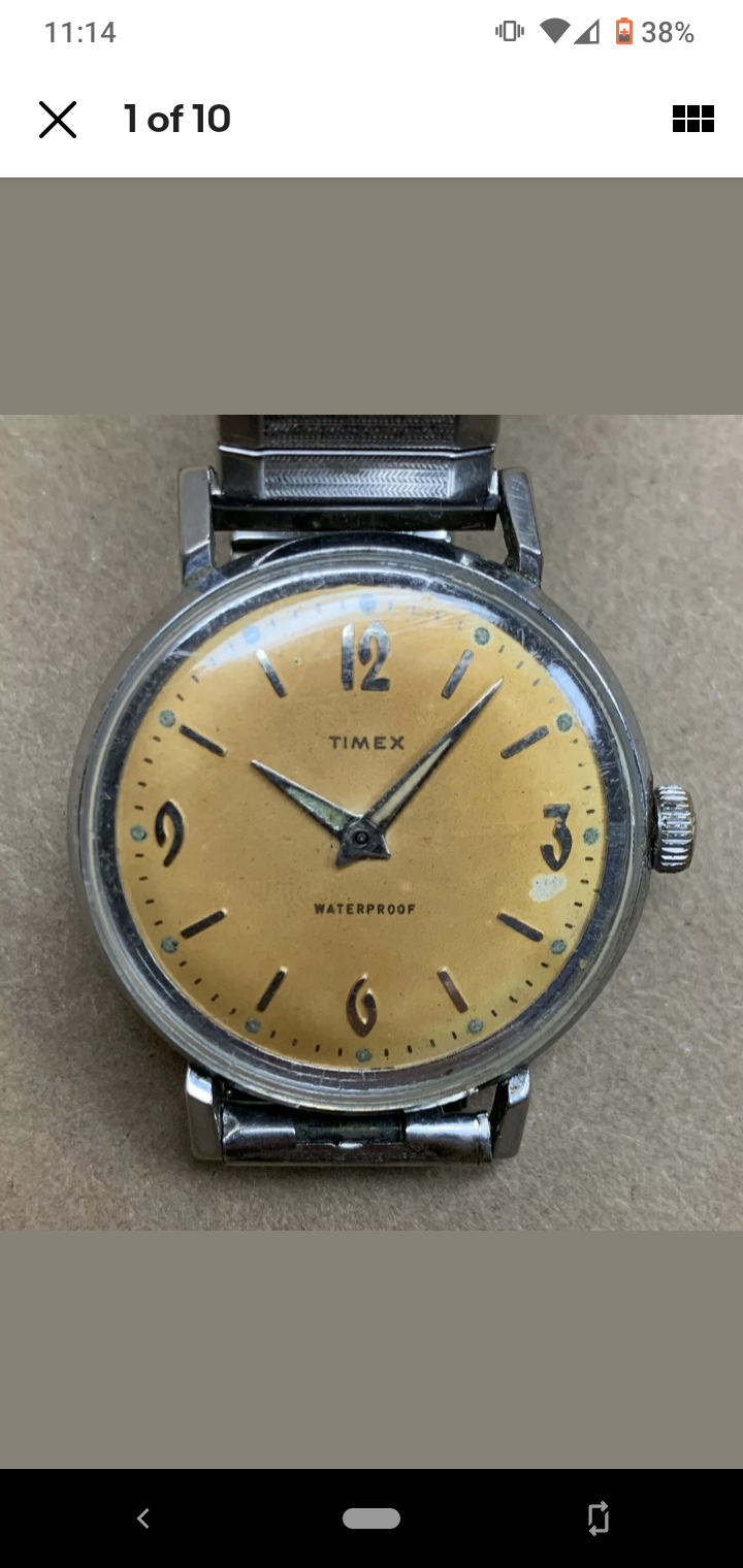

Smoke damaged or redialed Marlin?
Believe the relume (not a fan) was done a long time after the damage.
I can only think of some chemical reaction to reluming
