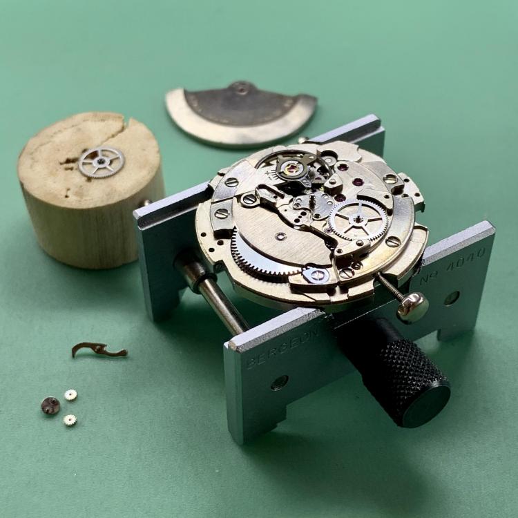

I have a watch on my bench with a 13''' Felsa 4033 movement in it. Can't find any info on the movement at all...wonder if any of you folks have heard of it or if there are equivalents or other variants. Not even Ranfft.de seems to have info on it!
It's an automatic movement with a little spring clip holding the oscillating weight on - i need to replace that, and put a new mainspring in.
Thanks!
It's likely it's another modification on the 400x series (http://www.ranfft.de/cgi-bin/bidfun-db.cgi?10&ranfft&&2uswk&Felsa_4009) that's not listed on ranfft etc. since a look up on a site like Cousins for Felsa 4033 parts then lists parts from the 4000, 4009 and so forth as compatible.
If you grab the parts diagram for one of these related Felsa movements (e.g. https://www.cousinsuk.com/PDF/categories/2772_Felsa 4009.pdf) hopefully you can identify the part you need. Part 1475 I note is described as the 'bolt spring for oscillating weight'.
Thanks folks - it does look like most of the parts are interchangeable. Nice movement to work on - the mainspring can be changed without disturbing the rest of the movement
