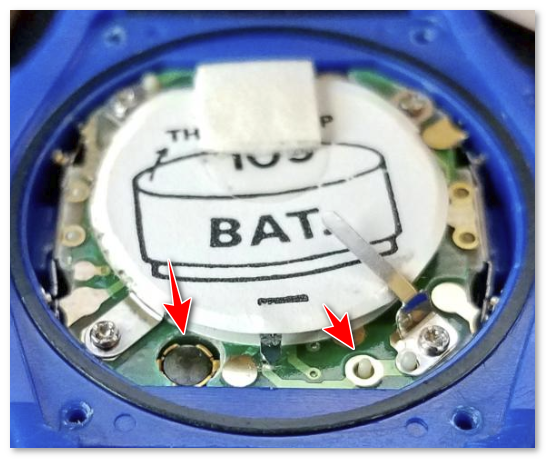

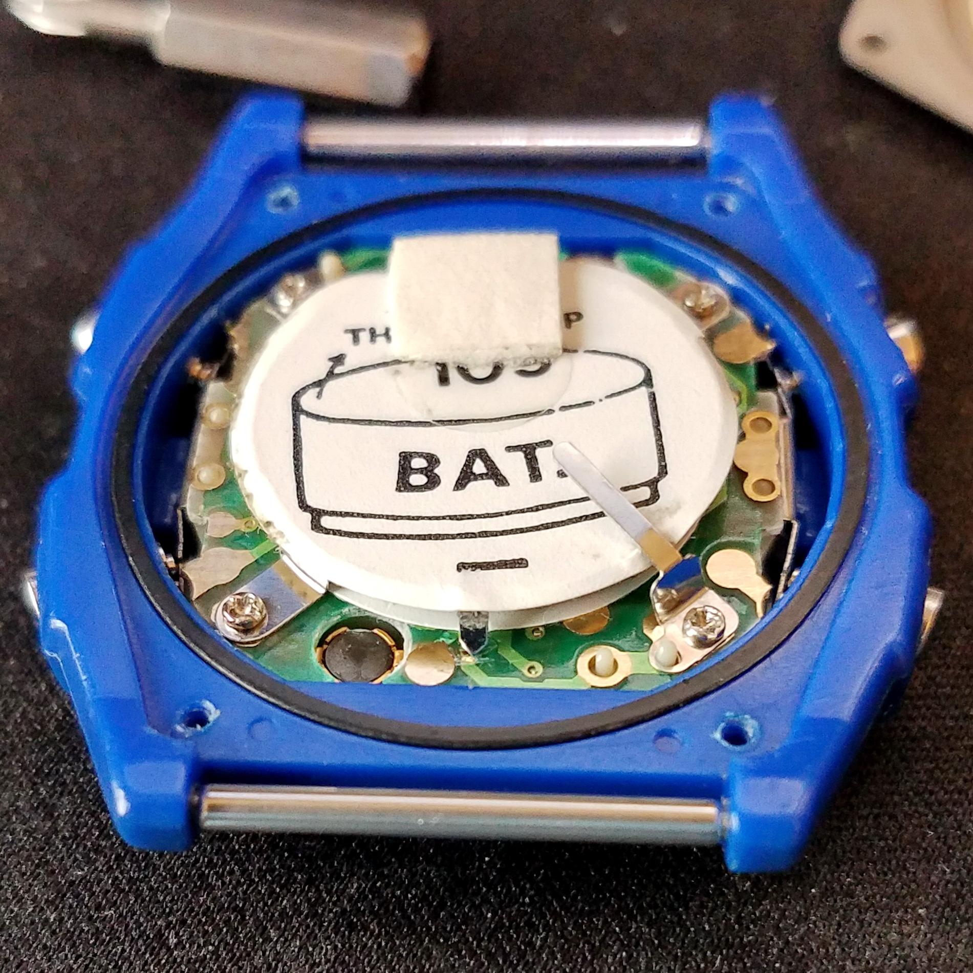

I'm just not sure what's supposed to be in contact with this model and thought I'd hop on here to share some photos and hopefully someone may have some suggestions.
Thanks in advance for any help or tips.  Photos coming.
I'm wondering whether the issue has something to do with this tang here on the bottom of the battery clip.  You can see in this photo where the board is a little scratch up.  I'm not sure whether someone was trying to fix this before.  I'm unclear as to whether this tang should be in contact with the board or trace, or that larger contact to the left.
The volume doesn't seem to change whether it's in contact straight down, with that eyelet/hole, or not at all.
Anyone seen anything similar or have any ideas of how this should be set?

Also notice that when the alarm goes off, the display can go wonky, with digits changing to different numbers.
Sometimes working the settings, like setting the time, the hour will jump from 3 to 10 and switch from A to P.  Obviously something's screwy here.
What are these adjusting screws for?  Is this typical for a digital watch?

Hmmm. There needs to be two contacts for the piezo to work. One is that springy lever that touches the piezo itself, while the other is normally a coil spring sticking up that touches the back cover. You can see it on your other watch, sticking up above the battery and a little to the right. I don’t see one on your Shark movement. The spring is usually just sitting in the hole where it belongs and is easily lost. Look for yours, maybe around that white battery cover. Steve

Ah, yes, I've seen these little springs in watches before.  I remember back to one of my first battery swaps in middle school in the 80s, wondering how the heck a spring got in there.  I think at the time I probably thought it popped out from somewhere inside the watch.  Saw the watch was still working and thought the spring unnecessary, so omitted putting it back in when I closed it up.  Dehr.  I remember immediately noticing that the alarm and hourly chime not working afterward, so put the spring back in and the sounds were back.  Never understood how that all worked, except that it did.  Certainly didn't know the piezo was mounted on the case back.  So - batteries, remembering springs, and changing pins or a strap would be about the extent of my watch repair skillologies for the years to follow.  A veritable expert!
Re: this blue Freestyle Shark watch, I didn't see an additional spring when I removed the case back, and I was taking my time, so I'm pretty sure it didn't shoot out.  I think it more likely that it was left out in a prior battery swap.
Do you see any spots in those photos where that second spring may seat?  I was thinking maybe one of these two spots I've marked here?  I'm keeping my eye out for other Freestyle Shark watches from this time period, so maybe the next one will still have the spring.
