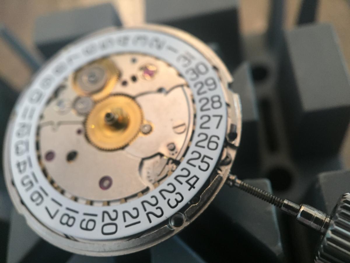

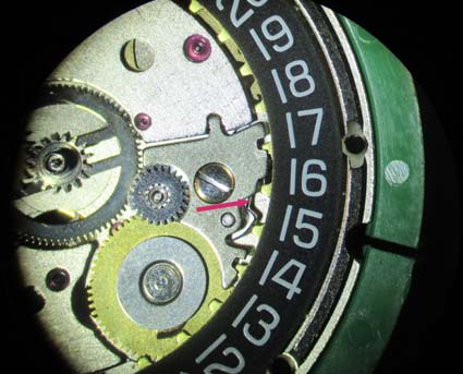

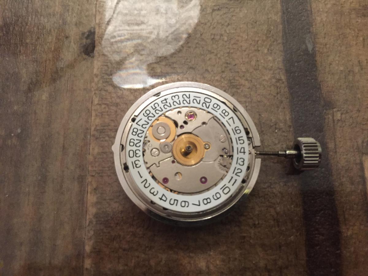

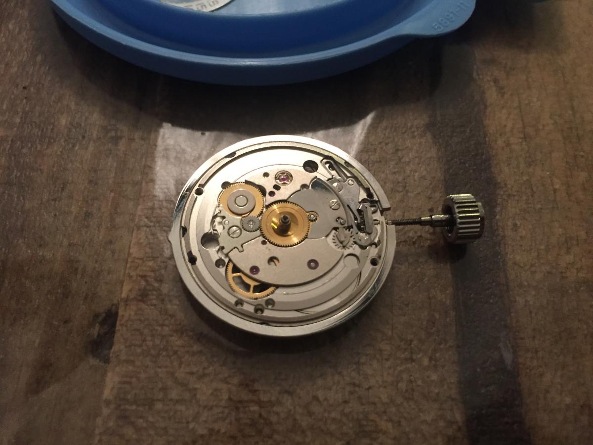

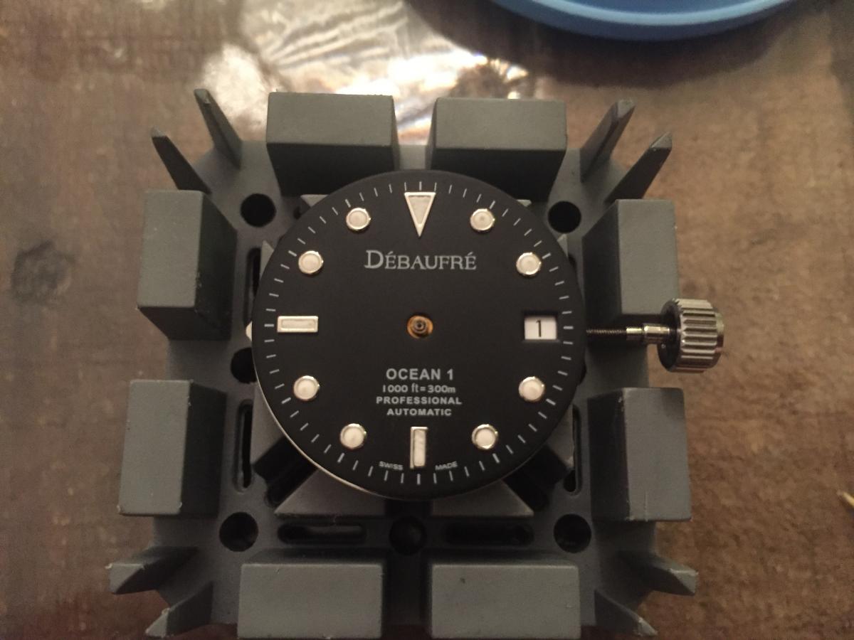

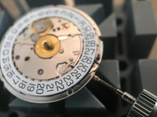

Recently i tried doing some work on my watch with eta 2824 and when reinstalling the stem, things got screwed, watched a vid of mark explaining the fix of the castle gear getting out of place in relation to the yoke, i followed his steps and succeded but after stem reinstall i just couldnt hear the clicks of the stem when pulling out to the 1-2 positions, it feels kinda blank. Cant adjust date or time. A member here suggested i should look from dial side maybe keyless work was requiered... So i proceeded to dial side, removed hands and dial but im stuck at date wheel... How can i remove the date wheel to access keyless work? I watched a vid on how to, but pulling the stem to calendar mode was involved and i dont have that function atm. Any tips will be greatly appreciated. Im not profesional nor have a lot of experience pulling movements apart, do you recommend sending the movement for repair or should i keep trying? I like to learn myself and do it myself to gain experience and be proud of what i did! Please enlighten me..
Pics of what do i have atm,with crown all the way in first pic and all the way out in second pic.

In the region of 10 O'clock in your photos you should turn the date wheel just half of a date setting, Then the teeth of the date wheel in that place will be opposite gaps in the retaining plate. Then just lift the wheel in that place and slide it away from the opposite retaining plate.

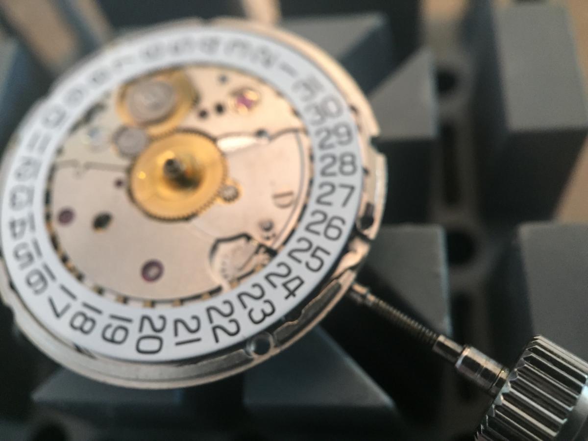

Putting it back is more difficult as you will have to engage the little spring (also at 10 O'clock) that clicks the wheel into the correct position for display of the date in the dial window. For this you will need plenty of magnification to find the little hook on the spring that allows you to pull it into place. See it in the photo below. The aforementioned holding plate with the gaps is between 14 and 17 in this photo.

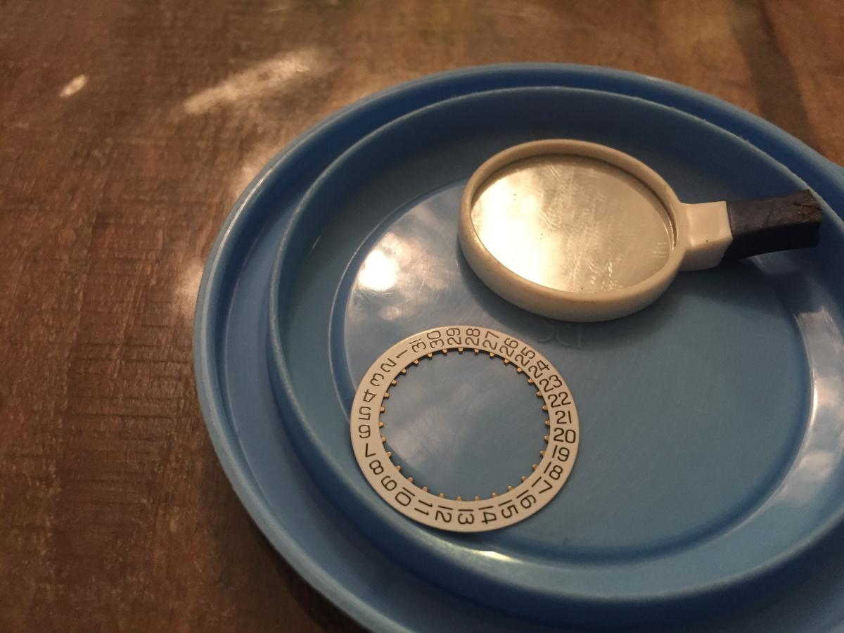

I cant get the date wheel to turn with the crown. Do you mean like pinch it with the tweezers and try to move it manualy? I dis see the clip between 14 and 17 in my movement and modifyed a pick to be able to push it in. Atm my crown is uselss, it does go in and out but no clicks are heard, does this mean that the keyless work need to be fixed or this means something else? Anyone with similar problem?
Rotate the date ring with a sharpened piece of peg wood or a cocktail stick pushing on a tooth until you have the good alignment - just a few mm. Then gently lift the ring as described.
The keyless works can then be accessed and put back into place - if you know how. There are several posts on the web for this repair.
For example: http://kronometric.org/article/eta/eta_keyless_assy.html
Edited by cdjswiss
I think it's better to remove the date ring by unscrewing the screw at date 27 to remove that retaining plate since it'll be easier to access the keyless work without the retaining plate.
Agreed - but more difficult and it all depends on what needs fixing in the keyless works. Removing the date ring as I described takes two seconds.The opposite plate can be removed as a second stage if needed. Sometimes the keyless works can be sorted easily using a probe with this plate in place; but not always.

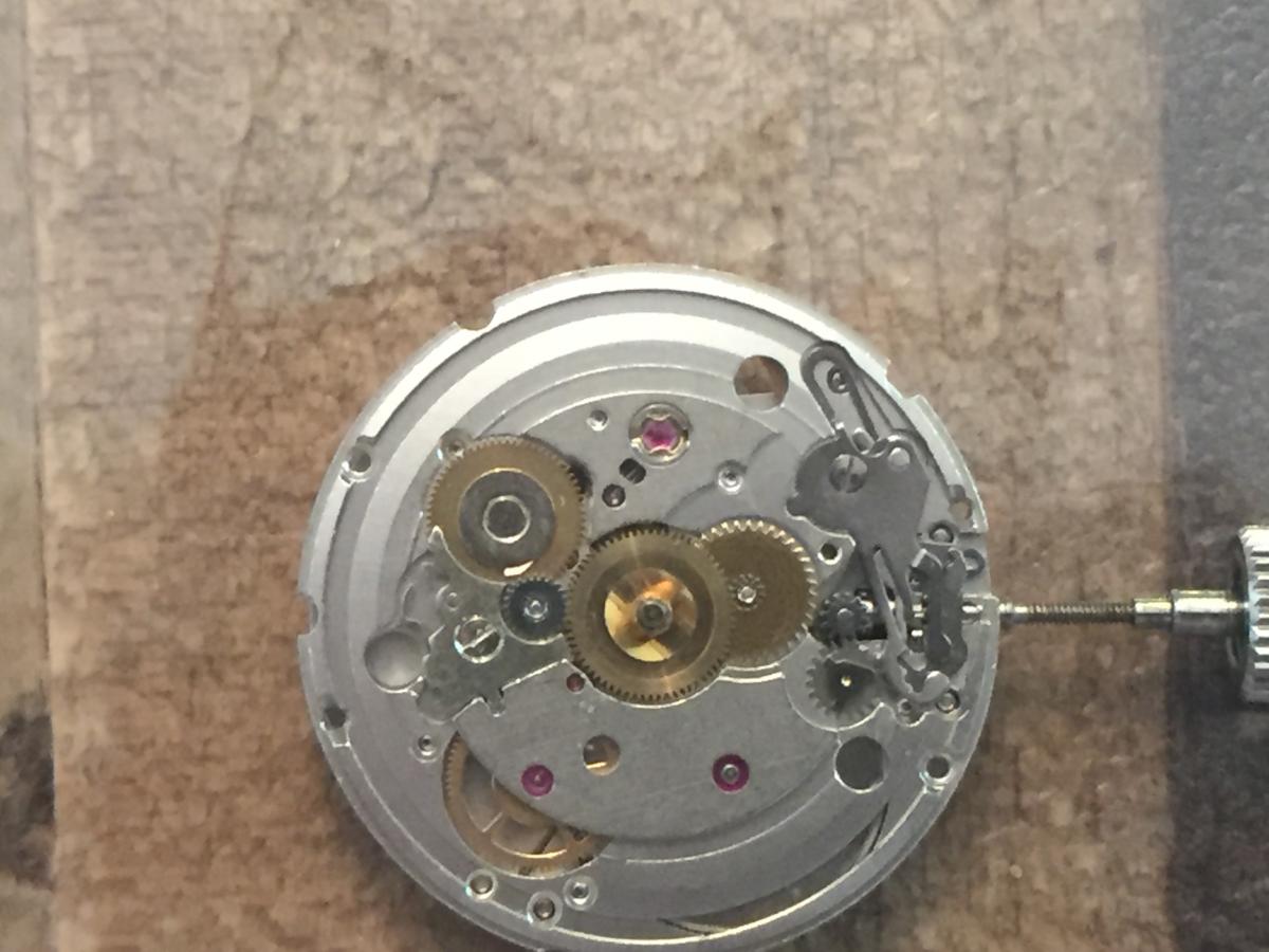

Guys!! Guys..... Merry christmas for all!!! Im a hero.. Sorry!! Without your help i couldnt have been able to do it. I undid and redid all the keyless work and now the crown is working properly on calendar and time settings, however the later aint confirmed because i still didnt put the hands and hence my two questions.
1- how to properly install the hands so the calendar jumps a day at 12? Ive done a couple seikos before but never could do it at exactly 12. Should i do it at around 11:45? Any method i should follow?
2- whats the safest way to put the hands? With movement stopped i assume, but do i have to wait till it stops by itself or can i hurry it and stop it somehow?
3- this is more of an advice from you, i cant feel i can take out the stem from the time setting position as you guys have adviced, is it doable? Ive only been able to take out from the winding position...
Thank you very much.

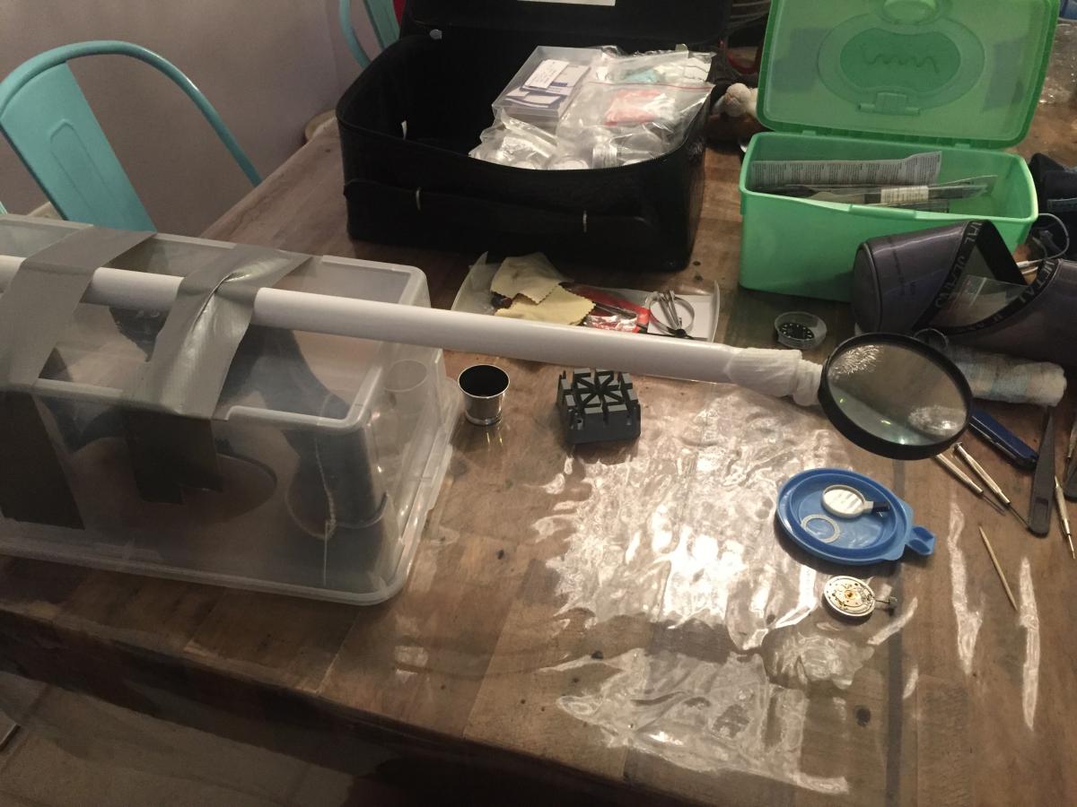

Here are some pics of my work dining table area :) yes this is jow i did all the work! Am i brave?

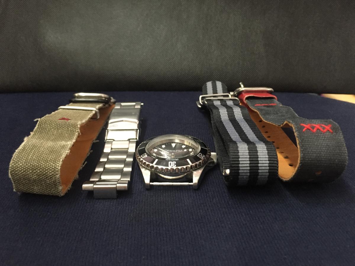

Sorry couldnt wait for a responce!! I proceeded with the hands, came up to around 11:45 :( but well thats an easy fix for later on! Here are pics of watch in all its glory on my wrist.
