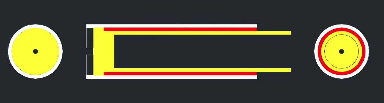

What are the options when it comes to Mainspring Winders for the larger barrels found in Pocket watches, I have sets from Watch-Craft and a K&D set but neather came close to the size of the Barrel on the watch i was working on today, i did manage to get the spring in using the largest adaptor in the Watch- craft set but it was quite a bit smaller than the barrel, where there any sets available that were made for larger sized barrels.

What size was the barrel as Bergeon do up to 19mm but they aren't cheap.
In the past I've made some of my own using stainless tube and a suitable arbor from my set.
Edit
If I was making one again and had to buy the tube I'd go for brass.

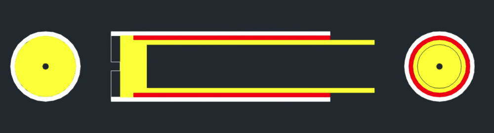

You'd need 3 tubes of reducing diameters and a couple of plastic disc for the pusher part as sketch below.
