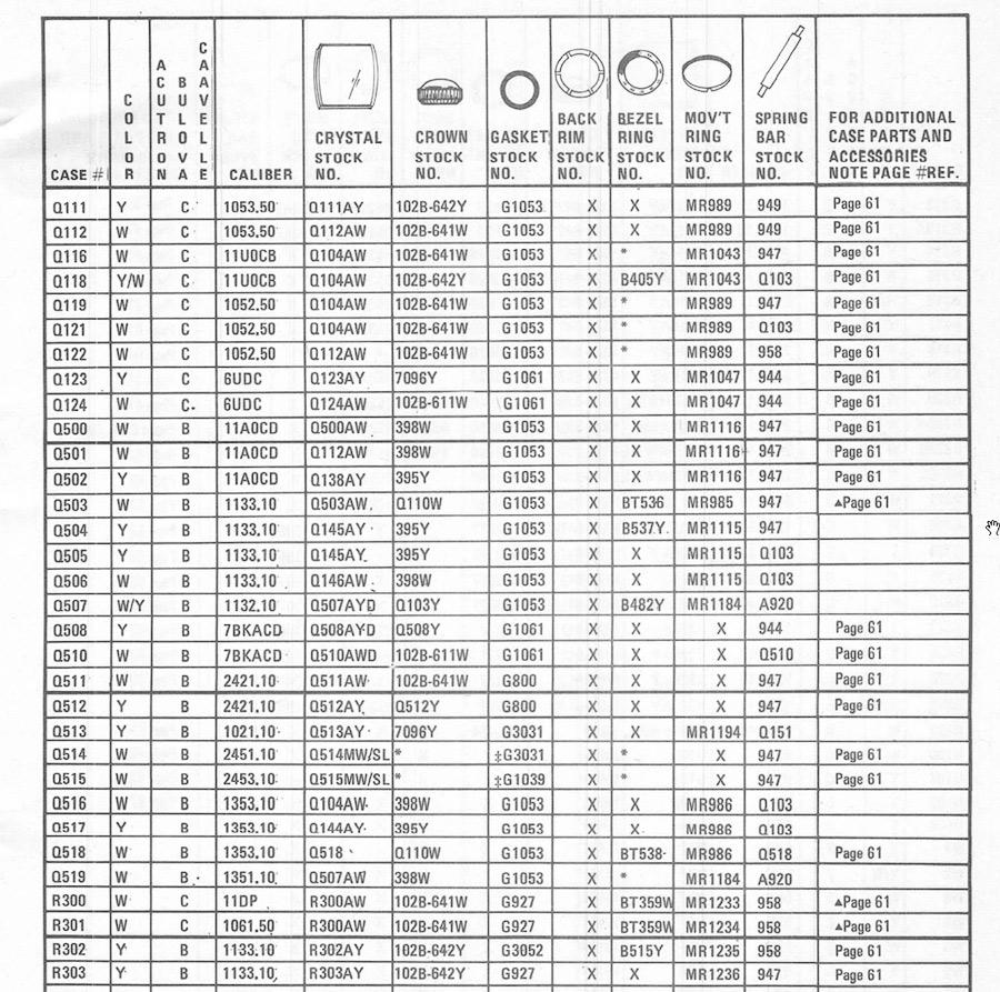

Hi, anyone have a source to match a Bulova crystal with a specific case number?  Looking for the Bulova-specific crystal part number (or GS if they made it).
Specifically a Bulova case Q526 (PO date code, 1980)

I believe Bulova's last case part catalog was the 1979 supplement. There may be a more recent one (seems like there should be) but I haven't seen it. Unfortunately, the highest 'Q' series case in that catalog is Q519. Some of the 'Q' series watches did take a crystal with the same numbers as the case, but not all of them.

These Bulova's will often have a tension ring with a step or cutout where the dial will fit, just in case you are going to try a 3rd party crystal, so be sure and check that. That dial looks somewhat similar to the 1979 Oceanographer '12503', but without the 'Day'. A lot of the '666' Bulova's were Oceanographers or Snorkels.
I've been keeping a database of pre-1980's Bulova crystals and it has two 30.2mm armored crystals; 1404AW (Oceanographer 'C' - link has a good photo of the crystal profile) - which I have a note saying that there is a GS crystal PA462-19D, and the 762AW. I think all three of those are currently on ebay, but if the tension ring is stepped it may be an issue. I've had mixed success swapping an existing stepped tension ring into a correct sized crystal that came with a flat tension ring.
