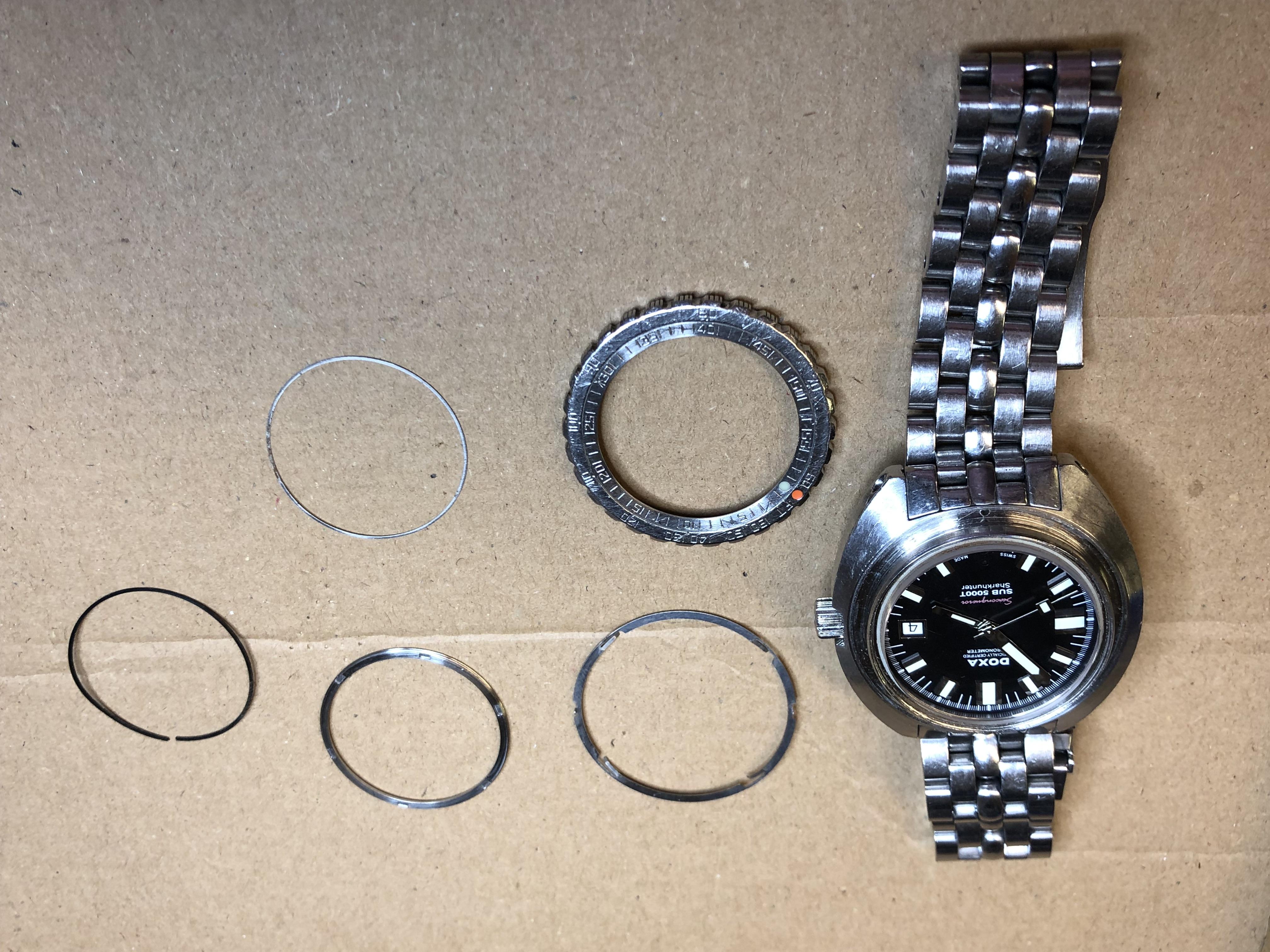

presently struggling to remove the glass on my Doxa Sub 5000T Seaconqueror Sharkhunter.
(Nothing like giving the same thing loads of names to make it sound important)
I have removed Bezel, Click spring, Glass retainer, o-ring shim and top o-ring.
The o-ring broke due to old age whilst cleaning with a tissue.
Just cracked; Brittle after 10+yrs.
So it was time for a service.
There is a second gasket, around the base of the stepped glass, but i am struggling to remove this.
It is perished i think, and is coming out in pieces.
Any ideas, as i dont want to damage anything if there is a 'Trick'.
Thanks in advance.

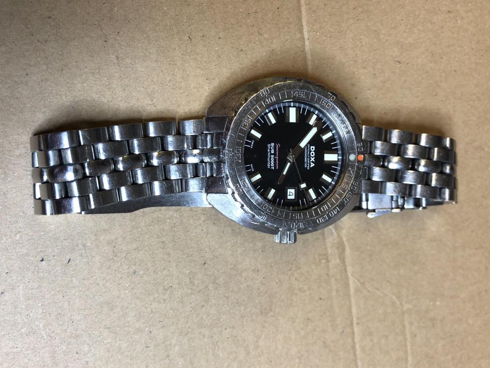

Hi, thanks for the reply.
(Photos attached)
You may be right, ref removal.
The first thing to confirm (for me).
Is the glass front mounted?
A few years ago the watch had a whack, and the 6 o'clock decal got dislodged.
I had to take the glass off to remove the decal with tweezers before it damaged the movement.
I had no trouble removing the glass then (as i recall)
But struggling now.
A few years on (and i still havn't put the decal back on)...
And the glass is now proving difficult to remove, with last seal.
It may have been damaged with Acetone, and rotted/perished into the space.
(I was rebuilding the hull of a GRP Fibreglass boat at the time)
So, a press from the rear, even if the glass is front mounted may be required.
Is that what you are suggesting.
Remove case back +movement, and press out from the rear.
Thank you.
The seal in question is the white ring visible as you move out from the second markers...
I believe it sits on the front face of the step of the glass.
Yes, that's the normal way to remove a lens.

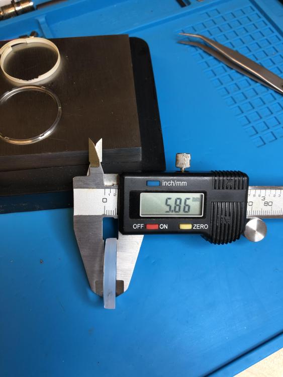

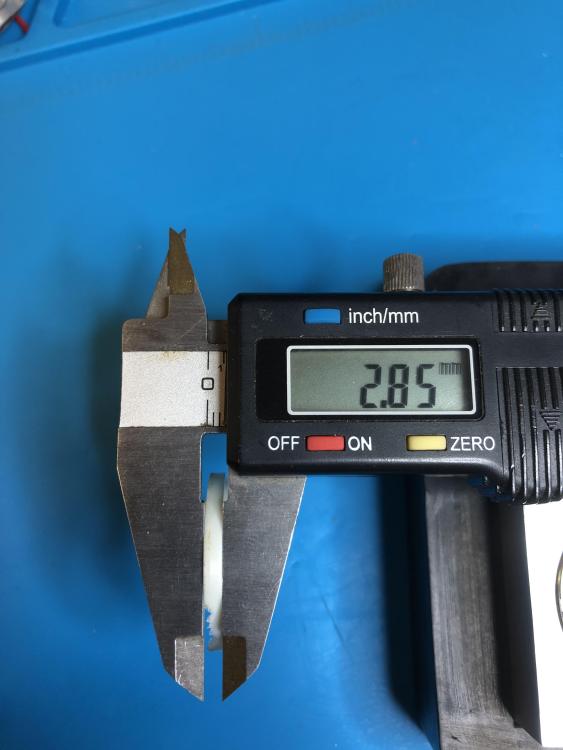

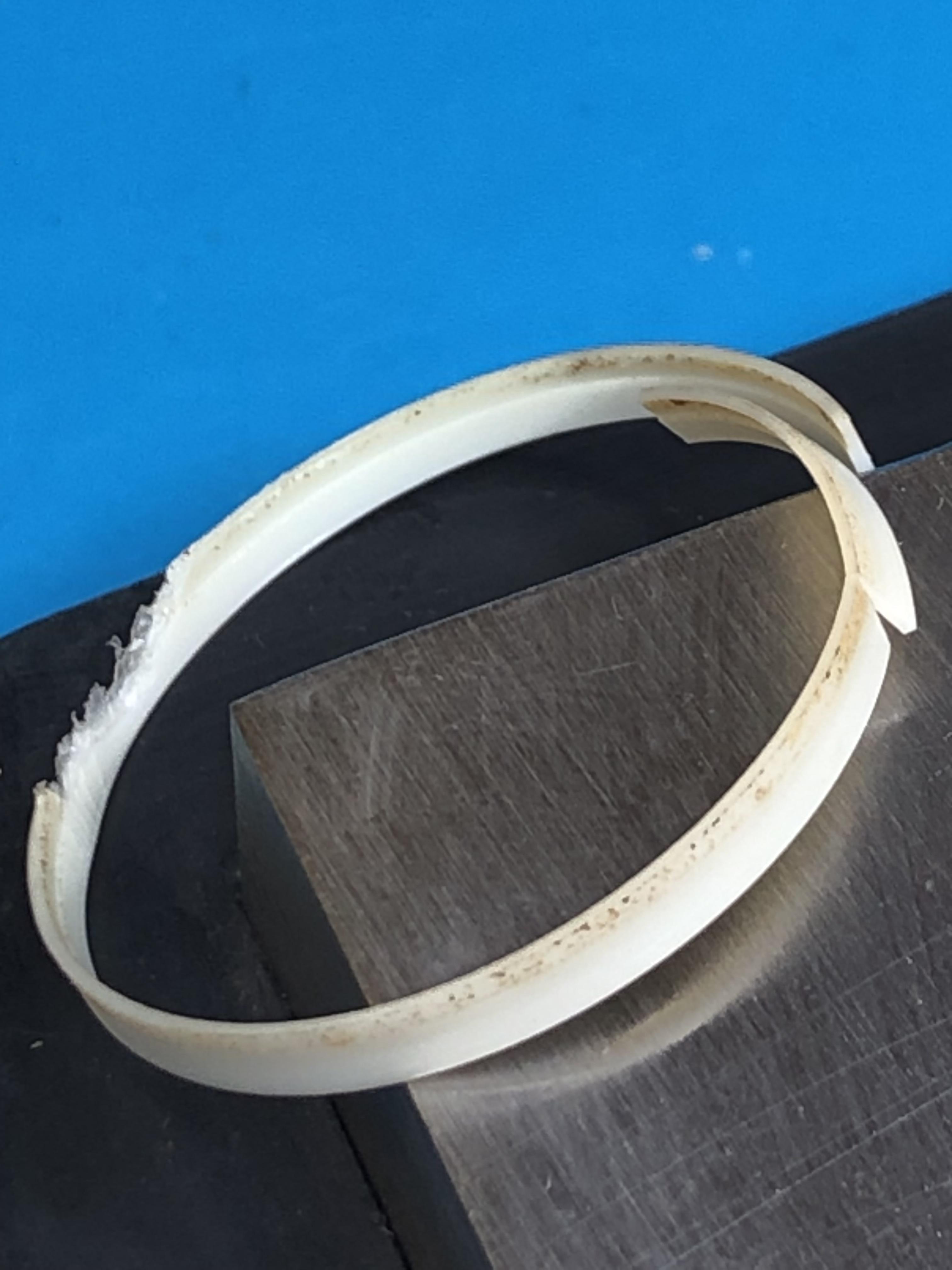

You were correct, it is necessary to (remove all front parts; Bezel, retaining ring, "seal"Washer", and then remove rear case, crown, movement and then press glass out from the rear towards the front. As it turned out, The seal was brittle and cracked. Not sealing anything. It is now my held opinion, that all seals on a watch of this type should be replaced regularly. Or one or all will eventually fail without warning. (If they are actually used at sea and get submerged)
Just need to source a replacement glass and seal kit now...
The minute i posted i knew photos would be helpful.
You are correct again, it is am "L" profile, didn't spot this initially.
Dry as kindling.
More convinced that the acetone this has been subjected to has damaged it.
Just glad the seals didn't breach in use.
Movement is intact

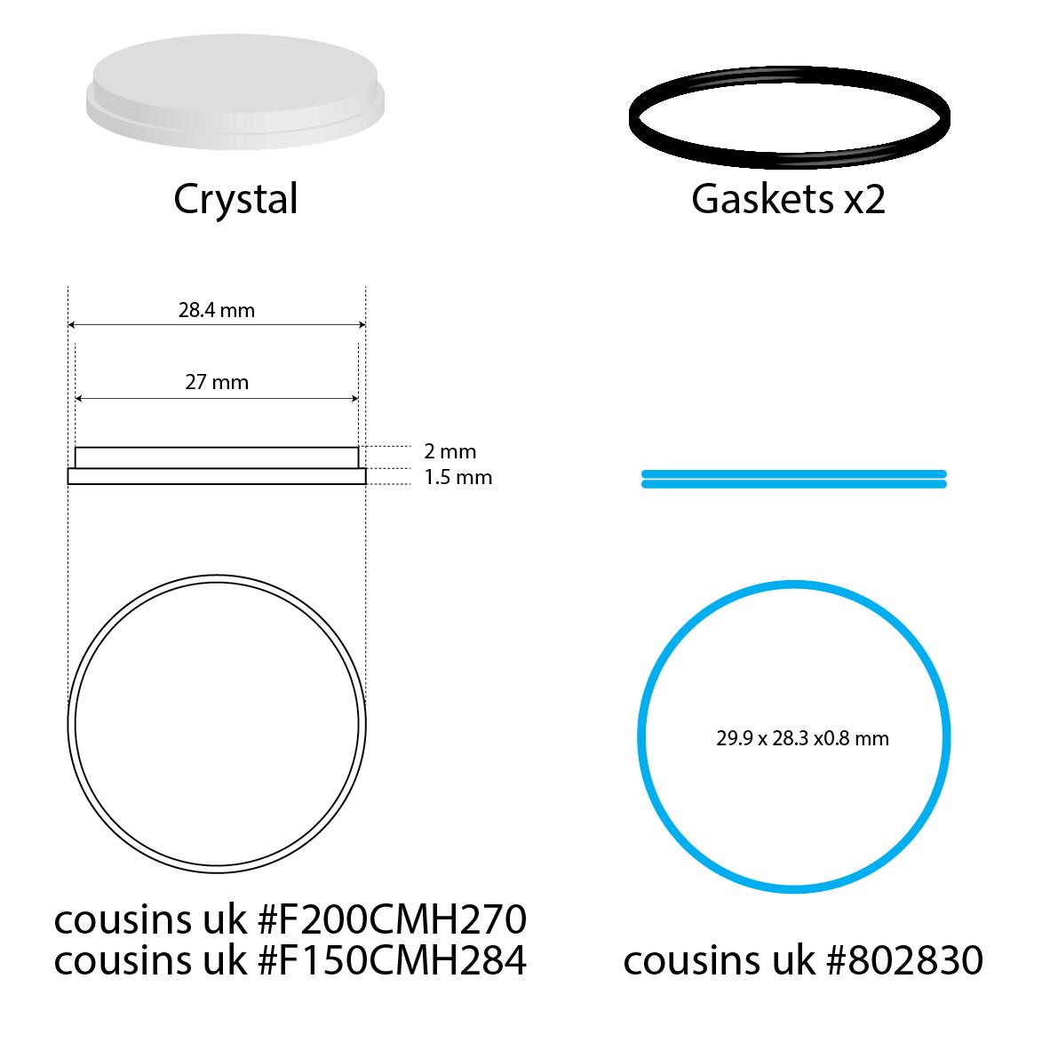

For completeness, i also post here the SUB 300T seal kit from cousins.
This is not the correct kit for the SUB 5000T.

Good question.
The lens is rounded on the edge.
Tapering away towards the rear.
The plastic ring is larger diameter at front, redusing after the step, towards the rear.
Ring goes into case from front first.
Then lens, then seal and "washer" ring, then screw down metal ring.
Not my idea of how to seal glass.
Bearing in mind the plastic ring is against the ground glass edge.
But apparently works to 5000ft.
Not sure i entirely believe that after the stripdown.
Regardless, i'll find the parts eventually i'm sure.
