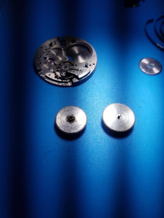

I have a mst 352 and the screw hole in the arbor for the ratchet wheel is shot.
No problem, cousins list part number mst357180 as fitting the 352 so I ordered it. And a screw.
The barrel is completely different and can't even work the same was as any other barrel I've seen. What's going on? Who is wrong here?
Sorry, terrible photos. But firstly, the square section on the arbor for the ratchet wheel is on the other side than on mine. Secondly, it doesn't have a screw hole in the arbor to fix the ratchet wheel. How would this even be used?

These images from eBay show a mst 359 barrel, which looks an awful lot like what cousins have sent me. They don't list it as 359 though
This image from a shop shows a 357 arbor
Which looks exactly like what i need and what cousins listed this as.
This was my first cousins order and I hear they can be funny about returns etc, which is why I wanted to check here first. Bit this is the wrong part right?
The barrel and lid look right, and I can use those as mine are ropey. Bit I really need the arbor!

This is one of the few occasions where I can say Cousins are wrong but this is where it pays to double check what's showing as compatible.
As you say the barrel is correct but the arbor is wrong

This is a 352 arbor not 357 as listed.

The pictures you link suggest that the 357 arbor is different to the 352 arbor. The pic of the 357 one looks similar to what cousins have sent me.
But, everywhere has the same list of what movements share arbors. And everywhere says 357 and 352 have the same barrel and arbor so I figured it was good.

So it is a 357 barrel and arbor, they are just wrong in listing it for other movements. It was listed under 364 parts, which I knew would fit.
This is for caliber with rocker bar winding/setting mechanism.
You have a broken screw in the arbor hole? Just need to remove it. If the screw was not wrong and screwed by force, it will get out easy as it is not tightened any more since the head is off. Just make thin cut through the square part to where the bearing pivot is and use small screw driver

No, the screw is missing. The hole is chewed out to such an extent that the sides have split. It's a chewed up rusty mess.

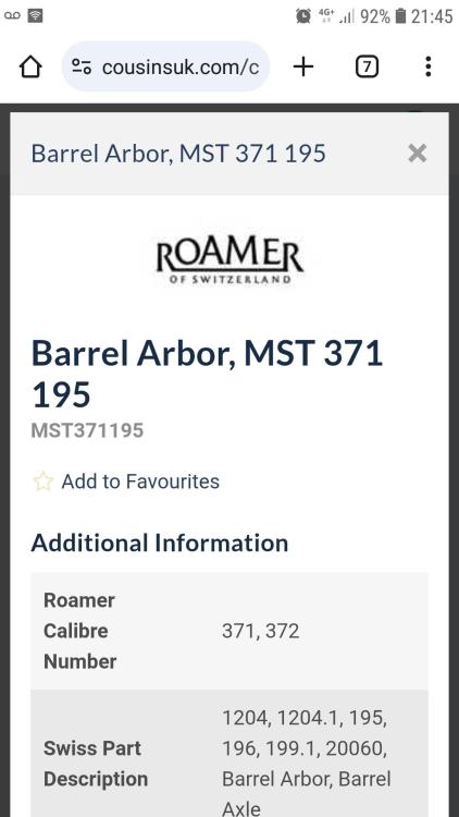

Just realised the other option cousins list is the 371 barrel and arbor.
The Cousins 371 barrel and arbor takes you back to square one.
22 minutes ago, graemeW said:
The same spring is listed for the 371, so id assume the barrel is the same?
Yes if you look at the barrel compatibility I posted above.

But the 371 barrel/arbor has a different part number from cousins. It puzzled me why they listed 2, with different prices, but with the same listed comparability. Emmywatch dont list rhe arbor as the same though
Not sure what you mean it shows the MST357180 for the 371 which is as you ordered?
The size quoted is just showing what size barrel it will fit direct from the ring without having to use a winder.
The other ones part number is 371180

Cousins list yet another part number for the 371 parts
The 371180 is just the barrel without the arbor and a classis case with Cousins if it were the right part then you'd go for that even if you didn't need the arbor.
