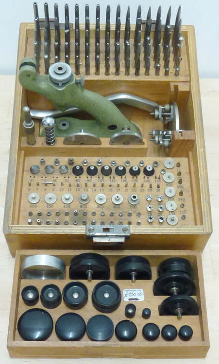

For what it is worth. The Favorite jeweling tool could be purchased in a set that included crystal dies, and also included a staking set (though it's not really accurate enough for real staking work). I have used mine for setting hands, and am not sure I'd bother with a separate hand setting tool. I don't have the crystal press bits in my set. In my very limited experience though I have needed a dedicated case back tool for cross threaded screw backs, and I'm not sure I'd want to use the dies that came with the favorite for heaver duty cases and bezel as they are all bakelite.
Hats off to favorite for giving it a try though, I found the below picture of the full set online and it is epic!
I passed up on one almost identical to this about a year ago, it looked bloody awesome...then i thought exactly what you said. A multifunction tool ....how good was it at multitasking each task.
I think it'd actually be pretty good for classic acrylic crystals (the dies look very similar to the traditional robur ones), but given the pressure I needed when fitting some seiko crystals, I don't think it'd cope with that.
  The staking thing is a shame, since there's no eccentric adjustment, I don' tthink it's suitable for really fine work.
  I think ti's the case with a lot of these things that they'll do 80% of the job, and if that's all you need, then cool. But the moment you need the other 20%, you have to buy a while new tool anyway

When I set hands I use a jeweling tool. Use the stumps and check the size against the canon pinion and hour wheel before placing the dial. It applies even pressure so the hands are installed parallel to the dial, and using a micrometer makes setting the depth very accurate. There's your 2-in-1 tool!
