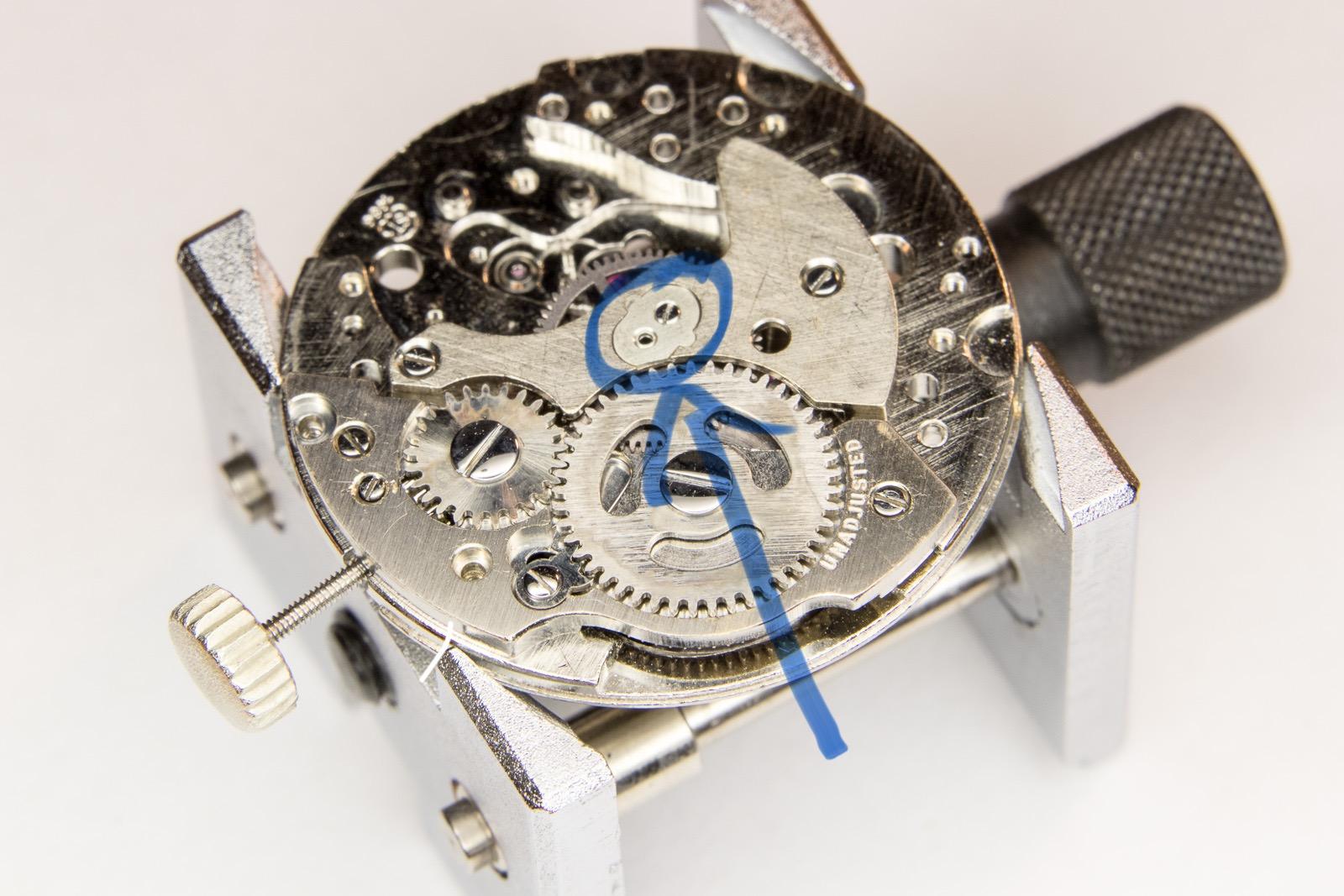

Hi Everyone,
I’m a “super-noob” and have a question regarding some jewels from an ST1686.
in the attached photo, what is this style of jewel cap called?
Also, are they easily sourced?  I just disassembled my first watch and found that most of the jewels and jewel caps were removed from the movement.  I’m looking for a good way to source replacements.
The parts diagram only shows complete bridges and main plates, so I can’t identify a part/part number to search.
Thanks for any help or insight,
Dave
You would remove cap jewels for cleaning, but not pressed in jewels. What is the movement, what jewels are missing ?
I just completed two of these movements and can confirm you are not missing a jewel. That piece is just a bushing for the center seconds. There might be other versions of the movement where they put a jewel there, and the screwed in plate would serve the purpose of making it easier to fit and change that part. But you just have a metal bush. You probably don't even need to bother removing that for cleaning. Just peg it out and be done.
My two were both 7 jewel versions but I believe it also came as a 17 jewel variant, maybe even a 21.
You say "most of the jewels" are missing. Do you have a photo of what else you think is missing besides the plate you pictured? Because you might be working with one of the low jewel variants.
3 hours ago, AndyGSi said:
I don't think that is a jewel just a bush to support the centre seconds.
What jewels are missing?
@AndyGSi, you're absolutely correct.  That's me being a noob...I don't appear to be missing any.
@mbwatch, you're 100% spot on.  I'm dealing with a 7-jewel ST1686.  I thought to myself when I opened this watch, "there's no way it 7, it has to be 17...must be a typo."  Clearly, I'm very wrong.
