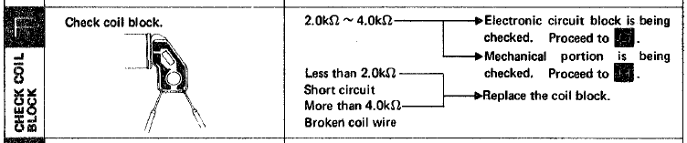

Test your coil with a multimeter it should read 3K ohms plus or minus 0.3 K ohms approx.
If the tiny copper wire to the right hand pad as you look at the watch with the crown on the right is damaged then this might work. If it damaged on the left pad this won't work.
Also try this if both wires to pad look good.....but only solder to right hand pad.
Take a piece of wire and solder both ends.
Now solder the wire to the main body of the coil wires and then hold other end on the right pad to achieve 3k ohms plus or minus 200 ohms with a multimeter. Some coils vary in resistance. Solder to the right hand pad but not to close to the end or the circuit board won't screw on properly. Hopefully you now have a working coil. If if doesn't work don't blame me at least you tried, maybe even try to resolder again and again until.....it works

Here's the details to check.

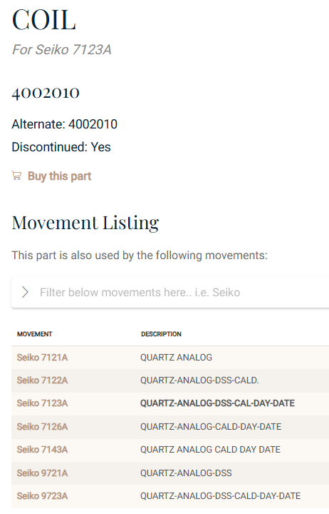

If it is the coil then here's the movements that use the same one.

cheers Andy i will start a search try my luck
