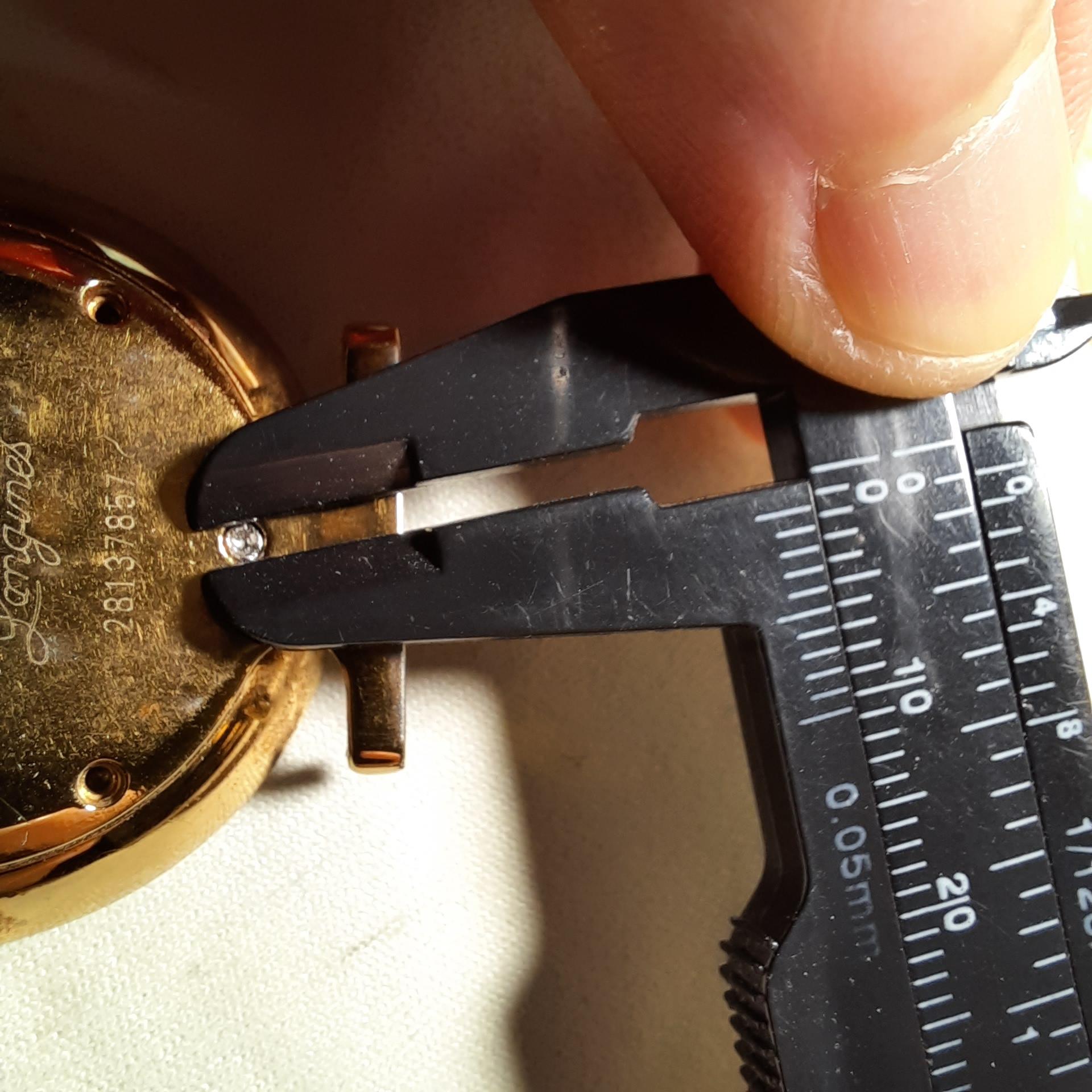

Hi,
I tried to open the back case of my watch. Unfortunately, I stripped three screws and I would really appreciate any suggestion or advice how to unscrewed them without damaging the whole or the back case.
I check that screw extractor is minimally available at 2 - 3mm while the screw itself is just around 1mm.
According to my googling, some of them suggested to solder another screw on the top of it with tin wire then to unscrew it. Has anyone ever tried successfully?
Thank you so much in advance.
You could try supergluing a small torx or pentalobe bit into the screw head, letting it cure fully, then trying to unscrew it?
If the screw comes out you can break the bit free and try the same with the others.
The last resort is very carefully drill through the head using eg. a 1.2mm or 1.0mm bit in a pin vice. Once the head starts to move, twisting it out. You should be able to remove the rest of the screw after removing the back.

maybe the threads of the screws have some sort of adhesive like loktite, you can take the tip of a soldering iron and place it on the boogered up head for a few seconds and like said use an appropriate sized flat head screwdriver to turn...or use a Dremel tool with small diamond bit to cut a slot, you will have to be real steady for this though...
