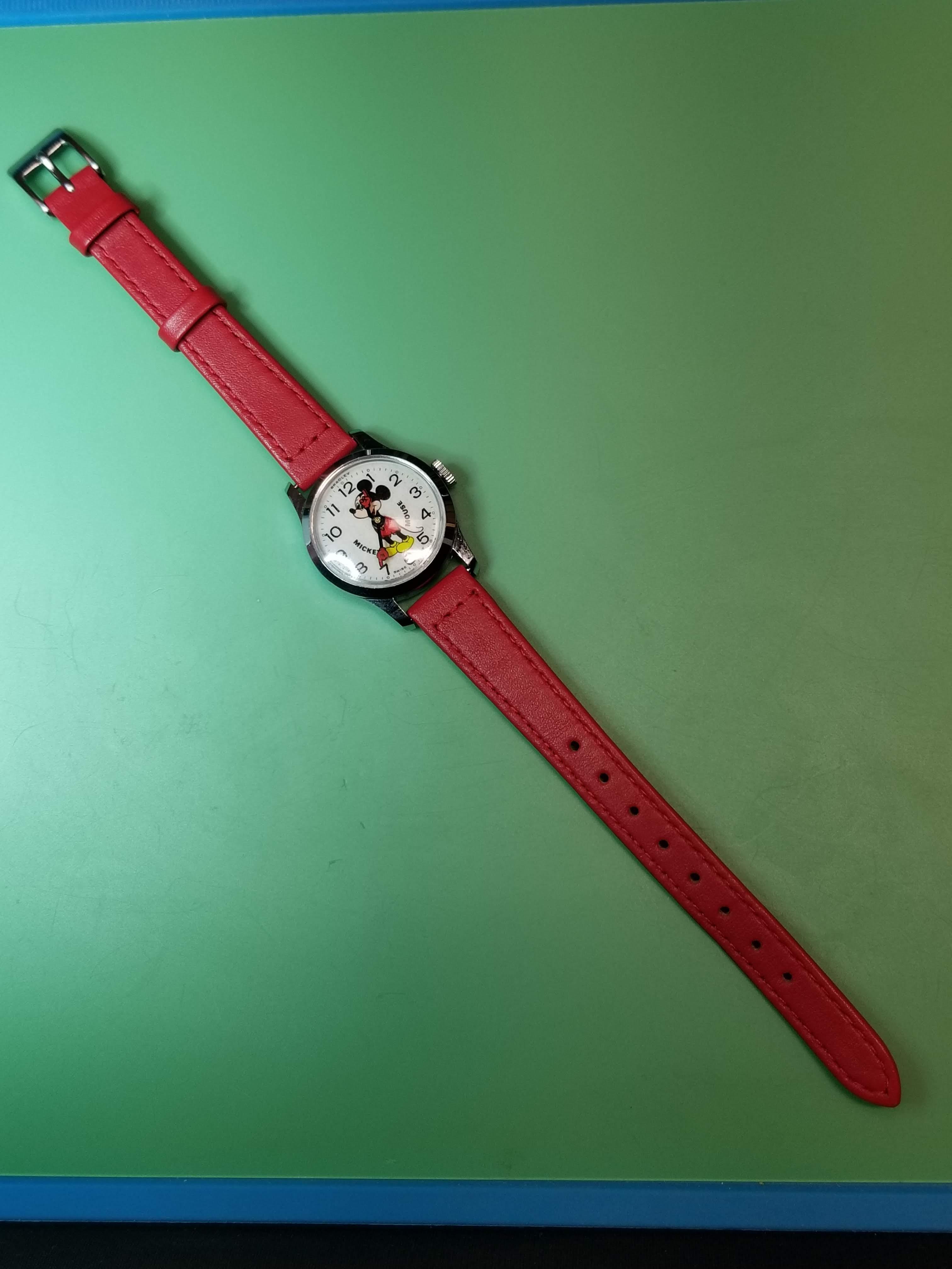

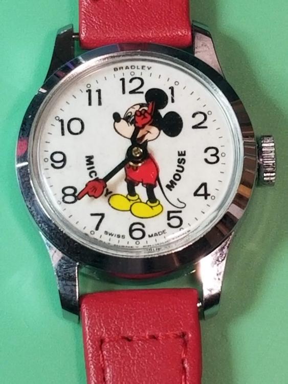

Mickey has a heart beat.  Got oil applied to two escape teeth and it just took off.  That was last night.  Still running this morning.
Mickey is all done.  Turned out pretty nice.  Buffed up the case, removed most of the crystal scratches and put a new band on it.  I think my friend will be very happy.  She's expecting the original vinyl band, which is too small for an adult.  I'm surprising her with the new band so she can actually wear it once in awhile.
