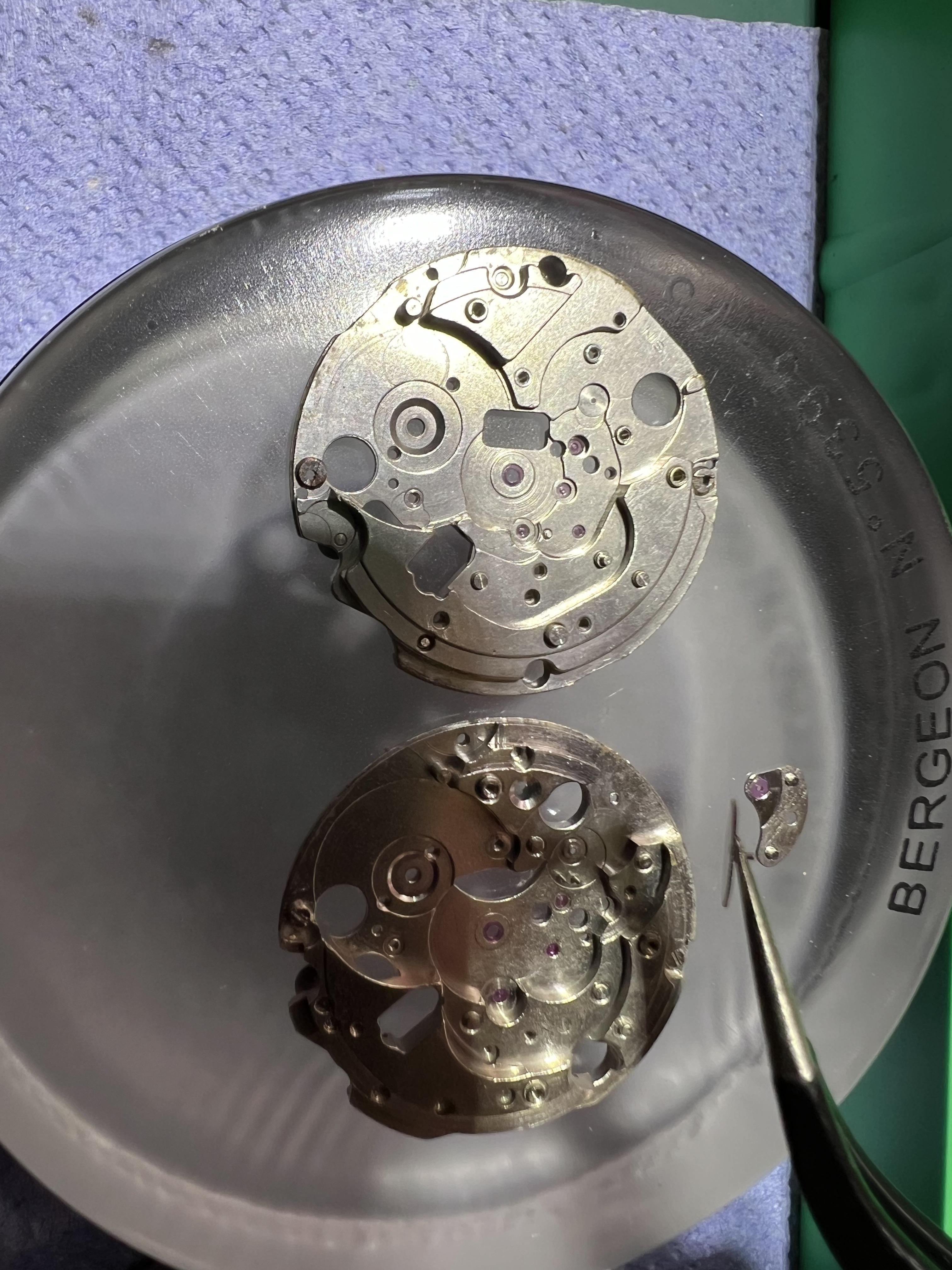

Hi. I came across this movement yesterday. Initially I assumed it was a 7009. The main plate is slightly different however. Noteably, the pawl reduction wheel has a shorter pinion with a jewelled plate to the underside of the train wheel bridge acting as the bearing.
also. The main barrel is shallower and smaller and the usual ‘SIN’ engraving is absent.
has anyone seen this before?
is it a fake?
