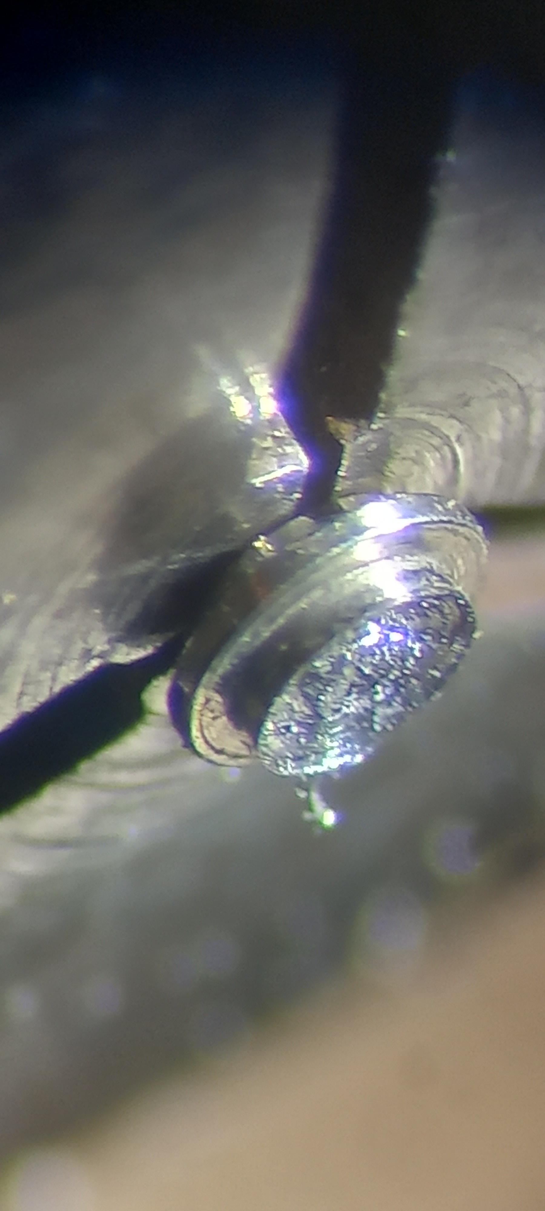

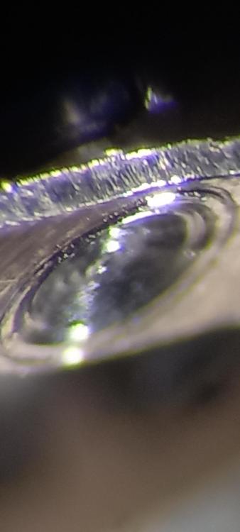

Here is my first attempt at cutting a staff from a balance wheel. I wanted a comparison between cutting the rivet and cutting the hub off.  Starting with the rivet was definitely harder than i expected, the rivet was thicker than i imagined and went quite deep into the rivet seating of the balance wheel, its easy to see how a staff hole gets deformed this staff rivet was thick. Thoughts are , difficult to work out where the rivet seating is and it's angle, i caught the balance wheel center right towards the end and the rivet seating is probably a slightly different angle. Cutting the hub away seems like a better option after this experience.

None of the pros here will agree that knocking a staff out is a good idea however it is carried out. After cutting one out i can now see why, in this case this morning the staff rivet was thick and sunk in deep on the balance wheel, i seemed to be cutting it forever, i had to stop twice to re-sharpen the graver and wondered when the wheel would become free, maybe why i caught the wheel, i was beginning to get impatient, it took a lot longer than i thought it would do.
