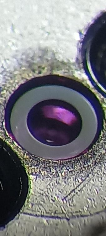

Here is an example of how well the Kerosene is cleaning, these pictures are of a fixed balance jewel that I have just replaced on a cock. After pressing the jewel in I pegged the jewel and surrounding metal, as we know this spreads any dirt and grease present which is then wiped off the pegwood onto some tissue paper, but still leaves a thin film of grease on the watch parts to be cleaned off. A 20 second hand brush clean in Kerosene then placed on tissue paper and folded over the part to soak up the fluid plus a few blows from a puffer. Then rinsed in IPA hand brushed and again dried with tissue paper and blown. The pictures of the jewel are as it was left after cleaning, the whole cleaning process was completed in under a minute. The jewel looks spotless and polished.
