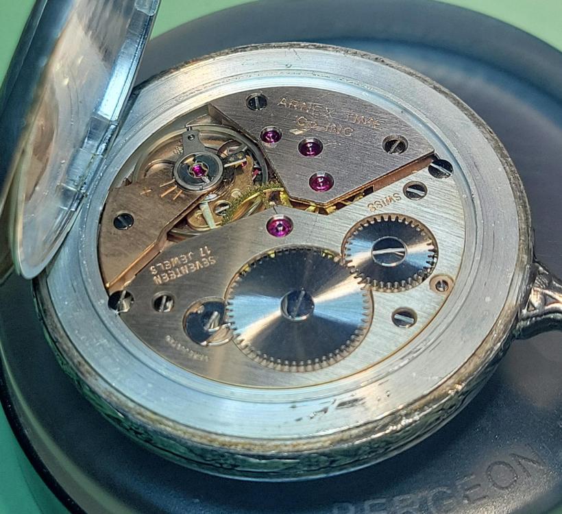

Walked by my local jeweler today and asked if I could dig around in his old watch case, and picked this guy up (along with a cool vintage compass and a Seiko kinetic5M62). My girlfriend's son asked if he could borrow one of my pocket watches for prom, so I thought if I can get this guy running it'd be a nice prom gift.
Non-running. Felt like the balance was overbanked, but it turns out the train was jammed solid. Looks like it was just dried lubricant gluing the 3rd wheel in place, because it's clean as a whistle otherwise. Parts are in the ultrasonic right now.

Finally got the mainspring in and I am pleased with these results.

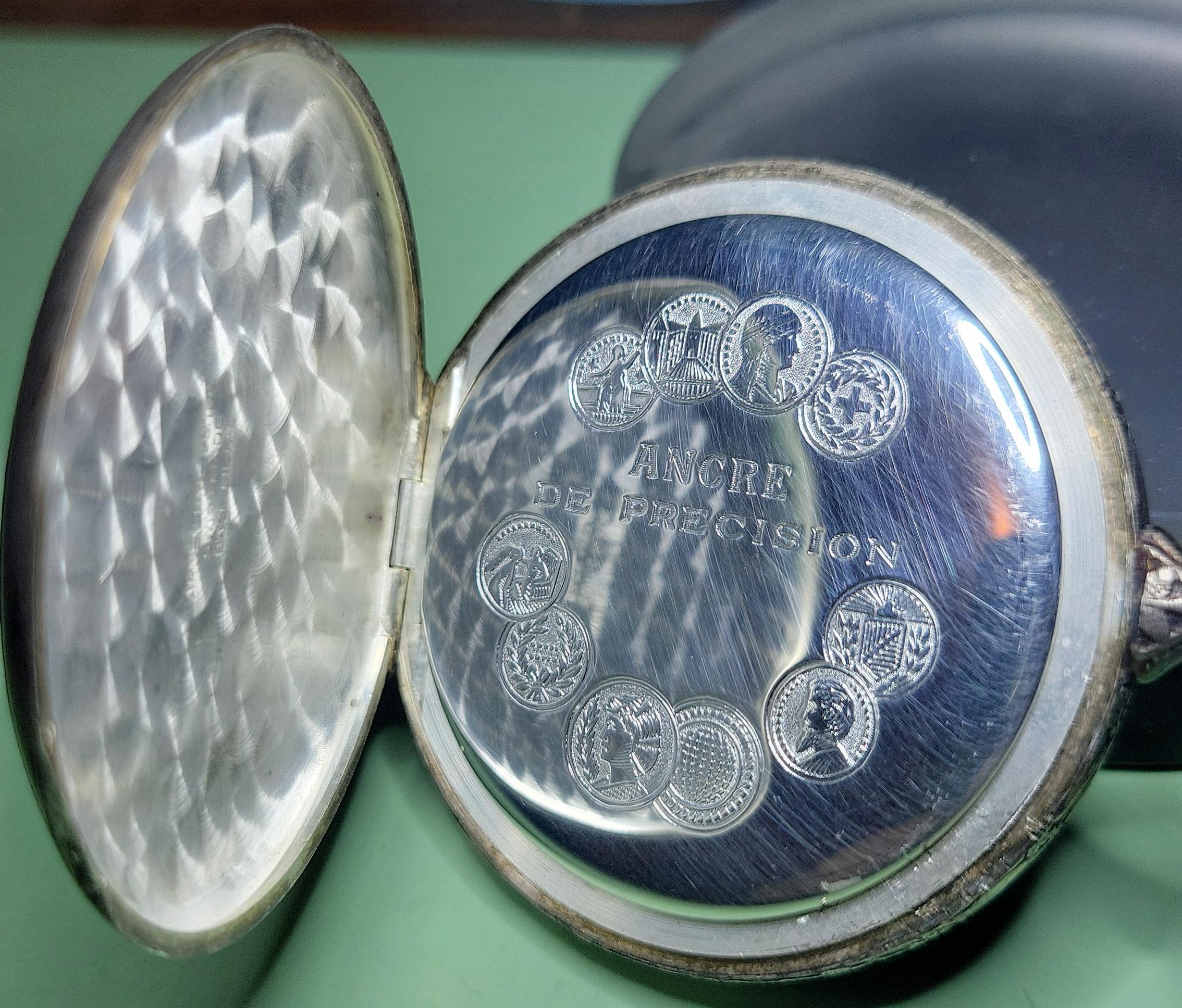

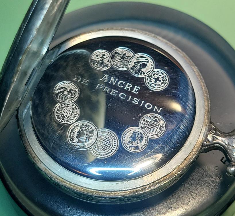

The case came up pretty nicely, too. Especially that inside cover. I'm assuming it's highly polished stainless, but it's so shiny if I didn't know better I'd say it's silver.
I found an antique silver fob to complete the look.
And yes, I noticed the cat hair under the crystal and popped it back off.
