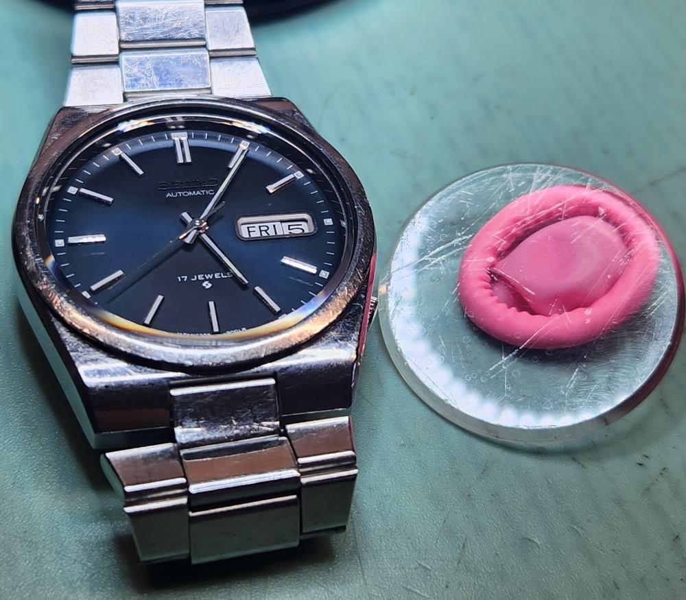

The hardest thing about changing this mineral crystal was forking over $38US and waiting 10 days for it to arrive from Thailand. Fits perfect and really looks great. Now it is obvious the bezel, case and bracelet needs polishing. This crystal has been discontinued.DSCN57572.thumb.JPG.79e9c588929b50face94a41041e05c63.JPG20240405_1705562.thumb.jpg.f4174a77dfc7b8cb250472ea5111cb05.jpg20240405_1711182.thumb.jpg.6df2ed5b1488a734d59b36f3ef03aec8.jpg
