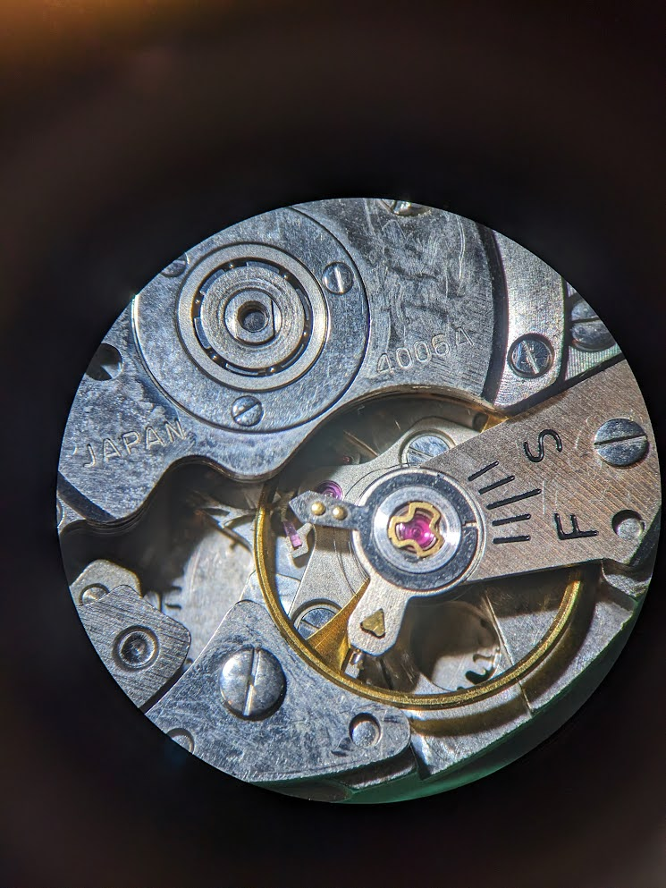

Alright, got a tiny little crowbar and cracked this sucker open. So far i mostly like what i see. Somebody who had no business inside this thing was inside it. Lots of hairs and fibers, lots of pretty mangled screw slots and tweezer slip marks. Sad cuz the movement appears to be pretty pristine aside from that and a gross greasy film covering everything.
I low key raged when i got a close look at the hands and saw somebody tried...very incompetently to set them with tweezers.
Even more rage inducing, this dial looked lovely other than what appeared to be some debris on it. That debris is actually corrosion where whoever tried to set those hand slipped multiple times gouging and scratching the finish allowing moisture in. It's rust under the dial finish which is making it bubble up.
Some good dial news is what I thought was a very ugly unattractive patina is actually some weird greasy residue. A little work with a pointed qtip and the indices and hands look about a million times shinier!
Seemed like a bad omen but immediately i notice one of the alarm set ring retaining thingy's is broken. Sigh, hopefully I can find a new one 😕
What i thought was some light corrosion or ugly patina is the same greasy residue that has covered EVERYTHING. No idea what that is. It's just a film on everything. But that means this movement will absolutely shine when it's clean!
Was so pleased to see the balance looked pretty great. Could probably use a little shaping towards the beginning of the terminal curve but I am not gonna mess with it unless i absolutely have to. New balance completes for this thing are almost 100 bucks if i screw it up. Also this is how i'm keeping track of screws. Labeling and photographing each set.
The ONLY fault this thing seemed to have was the alarm stopped working two days after i got it. Well now i know why. Somehow the arbor slipped out of the mainspring, the center coil of the mainspring was elevated a bit and was pushed out.
The mainspring is perfectly in flat still. I have no idea if this is a worn out or healthy mainspring. If anybody knows plz chime in. If i could reuse it that would be nice, though the winder to put it back in will cost me about 35 bucks more than a new one lol.  but it would nice to have it on hand for future services as this is a keeper.

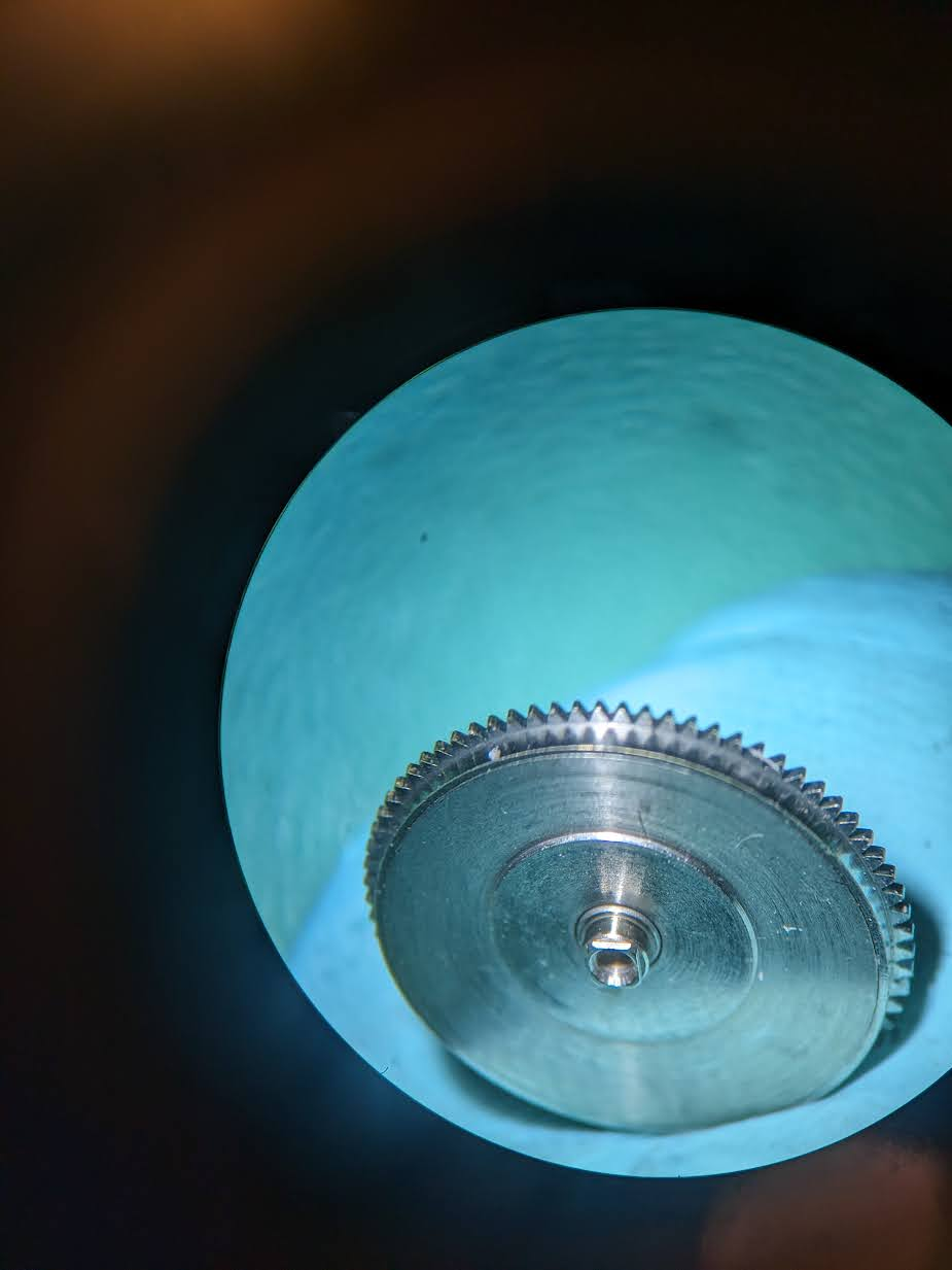

This is the only surprise for me. How on EARTH do you open these barrels?! They open at the top and the lid is basically flush. Usually i use my fingernail with side opening ones but this is not that...any advice?
Just now, Waggy said:
Look at the side, the OD of the cap is slightly larger than the OD of the base. So they overlap on the side. Some use a razor blade or knife, but I manage most times with fingernails, one on the teeth then another under the overlap:
Sorry for the pool sketch.
i'll have to look at it again, it looks to me like it opens on the top and the top is flush with the bottom, i don't think it opens from the side like that? I"ll look again
Can you not just put it on something hard, then push down on the teeth to pop the lid off?
That's how most Swiss style barrels open
Here's a better shot of how it's constructed. And do you mean to like...have the arbor push the cap up from the bottom? The lid is flush with the top and pops out the top itself.
Your barrel looks more like something I would see in a Swiss (or non-seiko) watch. To open it in your case I would place the closed side of the arbour on my riveting anvil and then press down on the teeth at 6 and 12 o'clock and try and use a spare finger to stop the lid popping off when it becomes loose. The Arbor should force lid off as you press down.
The start of this video may explain better
I get it. I actually love that. that is so much easier than the barrels i usually work with which just have a barely perceptible slit halfway down the side so you get to trash your thumbnails trying to pry it open. Thanks bud!
