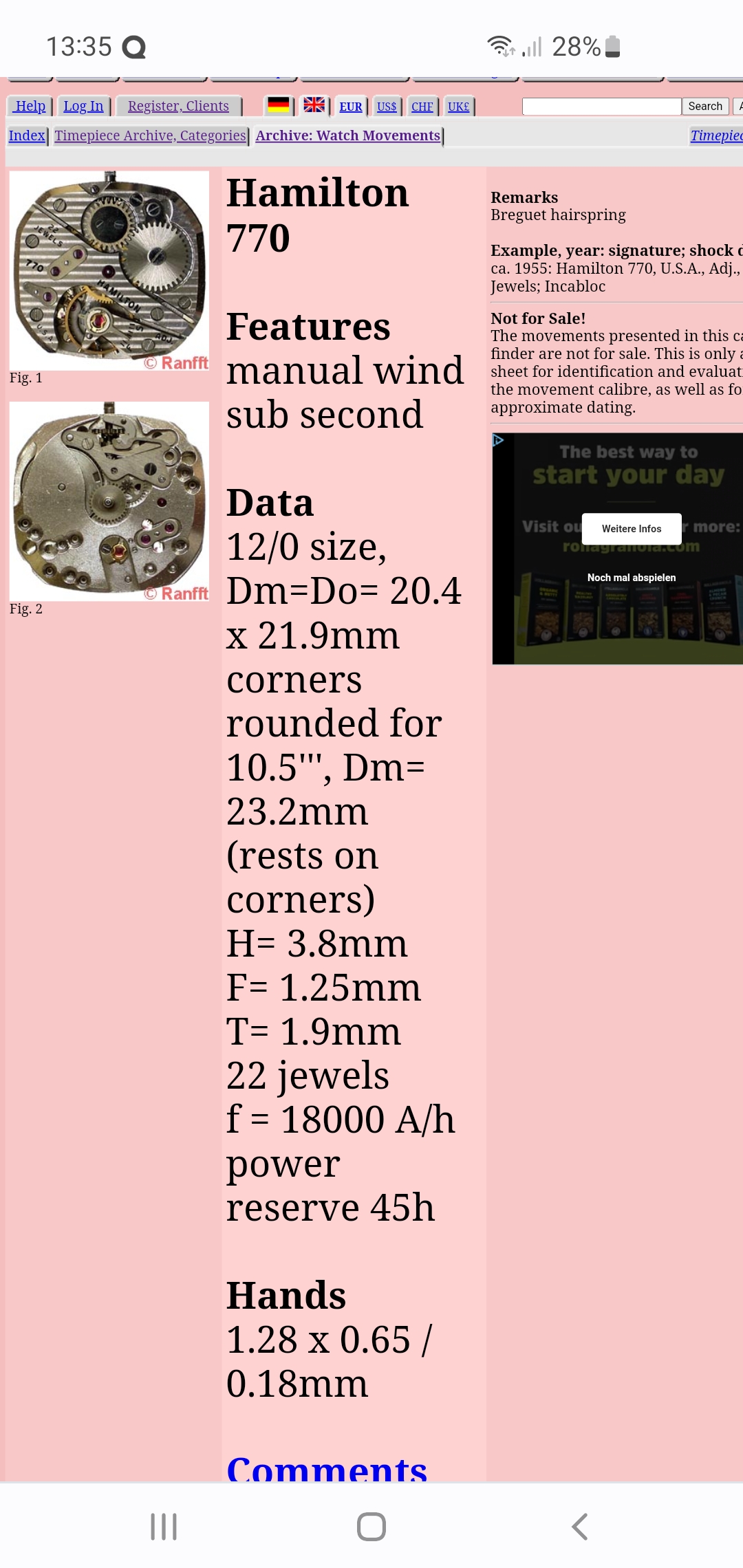

I concur superglue can leave a white film from the vapours.  I often get this when i sometimes superglue clear perspex together. Its usually at the time of bonding , once cured it may not produce that effect, i still dont think i would risk using it. Be very carful with the dial,almost anything used can have an effect on a delicate finish. I've removed thin lacquers with just water and a cotton bud. Distilled water or de ionised water should be used. Hard water area water will contain amounts of calcium this may have a very slight abrasive nature. I've tried the softest of materials and different fine makeup sponges that still left scratches visible with fairly low magnification. Just got these from cousins but yet to try them.

Anyhow, I remember him being so proud of this watch, and I believe in the day, the 770 Hamilton Movement was considered one of the better movements to have.
Does anyone know if there is a tech sheet for that movement?  I'm thinking that was before they may have existed, but just curious as I can't seem to find one.
