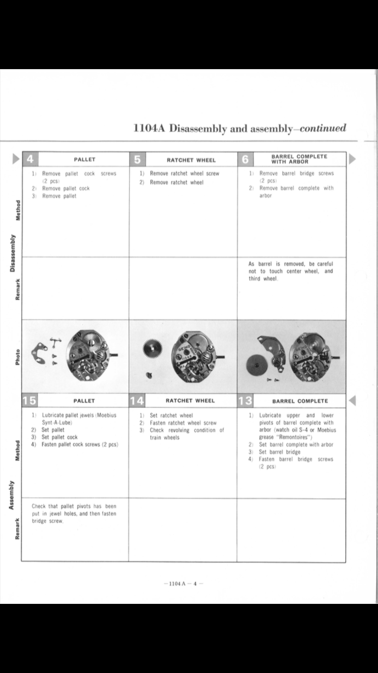

3 hours ago, Birbdad said:
3. Then i remembered since i was going off a seiko service sheet and for some insane reason they do not tell you to lubricate the barrel arbor, OR the jewel it sits in!  Insane! I went back and relubricated the barrel arbor with hp1300
What version of the NH36 tech guide are you using?
I’m seeing use of S6 on the arbor and the bottom arbor jewel.
The 7S26C guide suggests use of S4
https://www.timemodule.com/upload/PDF/NH37_TG_E.pdf Ok i partially take it back on page 7 they do have you oil the jewel itself but not the bottom arbor. The guy who's lubrication videos i've been using has like 3 lubrication points on the bottom arbor. I did lubricate the jewel but once i lubricated all those points on the arbor my amplitude jumped 20 points.
