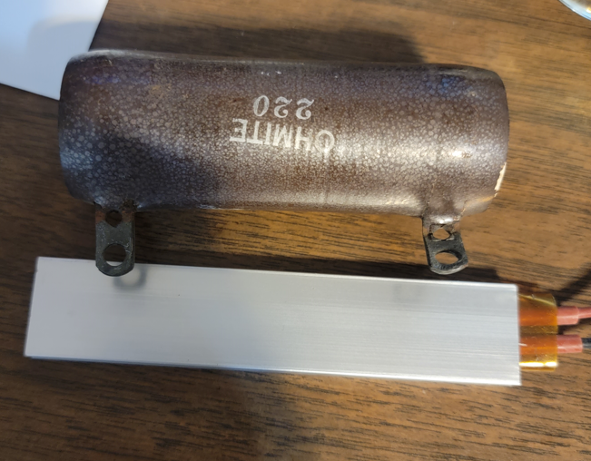

I finally bought a "collector" resistor and so the issue is behind me.  I also bought one of the Chinese PTC heaters.  It has arrived and can also work.

I am going to use this PTC on my current refurb.  It is longer but will fit well enough I think.  Your solution is fine.  Looks like you went for a higher resistance, but not sure...maybe you put two 75's in parallel and then in series with the 200?
