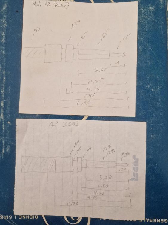

It's good to get it a bit oversized from the largest diameter you will end up with; at full stem length you will have a fair bit sticking out of the collet and a general rule is you want about 3x diameter of your material as max stick out. You can go over, but you have to take more care when cutting so it doesn't flex and climb up over your graver. For a typical stem I usually start with 2.5mm or 3mm stock, and end up with a max diameter frequently of 1.2mm or so. You work from the end back, to maintain rigidity.
My usual procedure:
-cut pivot to the diameter that the square will be across the flats
-cut the diameter of the square (usually this will be equal to the diameter for the winding pinion)
-file the square. the oversize pivot diameter you cut first acts as a guide for when to stop filing
-finish pivot
-cut diameter for winding pinion
-cut the bearing diameter that rides between the mainplate and barrel bridge
-cut slot
-cut diameter and length for the thread, part off
-flip around and cut thread
In some cases it's better to cut the thread first. This depends on the overall stem dimensions and also how freely your die cuts; there can be a lot of torque needed to cut the thread, and you can have a situation where the stem wants to spin in the collet, or if you hold it tightly enough so it doesn't spin you deform the diameter you are holding.
Couple of drawings below. For the Valjoux 72 with 0.9 thread I would cut the thread last. On the skinny little AP I'd do it first for sure (also 0.9mm thread).
