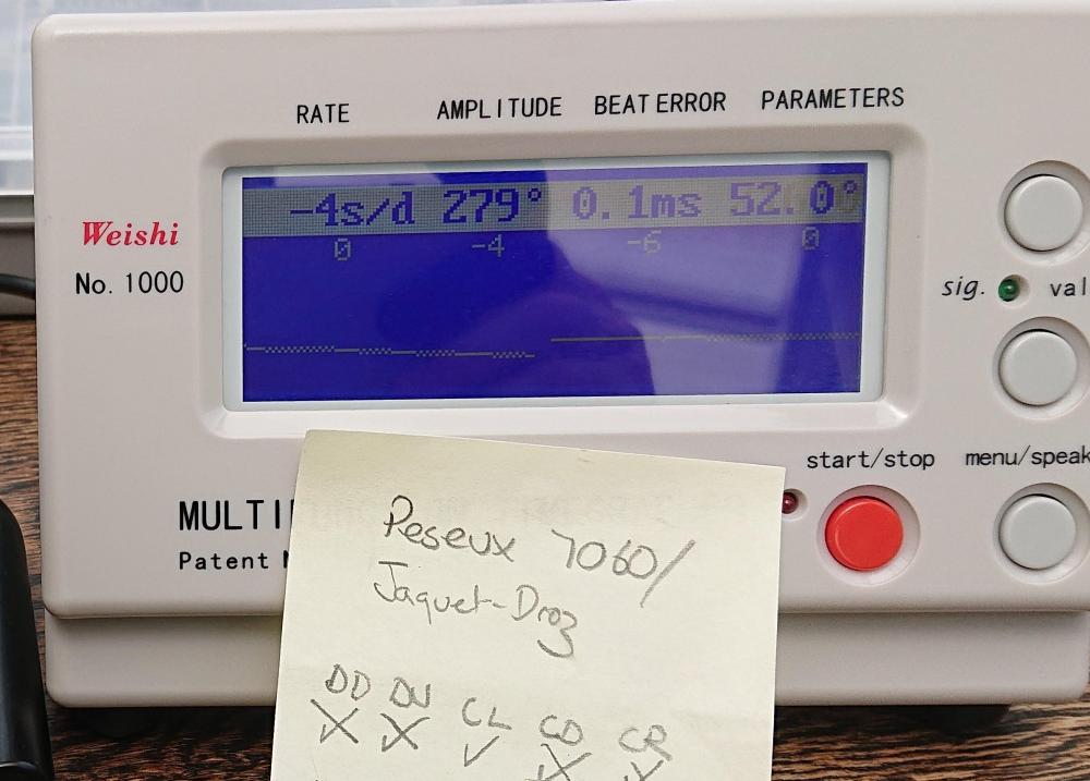

Putting it on the timegrapher. 280, 300, 320, 340 degrees, SNOWSTORM!!! Sorry I didn't get a picture but I quickly removed the movement as I could hear it knocking, in order to release the main-spring. I checked the replacement spring and it's measurements were the same as the original however the curve was a little less pronounced. It looked fine, I'd simply replaced it as a matter of good practice. So I cleaned the original and put it in.
Now the timegrapher results show unexpectedly high amplitude, but it's not knocking.
Dial down
Dial up was within a second and two degrees of dial down, and the other vertical positions were similar to the crown right.
On reflection, this watch will spend almost all of it's life crown up, so I readjusted it optimised for that position accepting a greater error dial up and down. After a few hours of running-in the differential between the horizontal and vertical positions has reduced. The various vertical positions all perform similarly so I won't post them all. These are after an hour or so of running:
