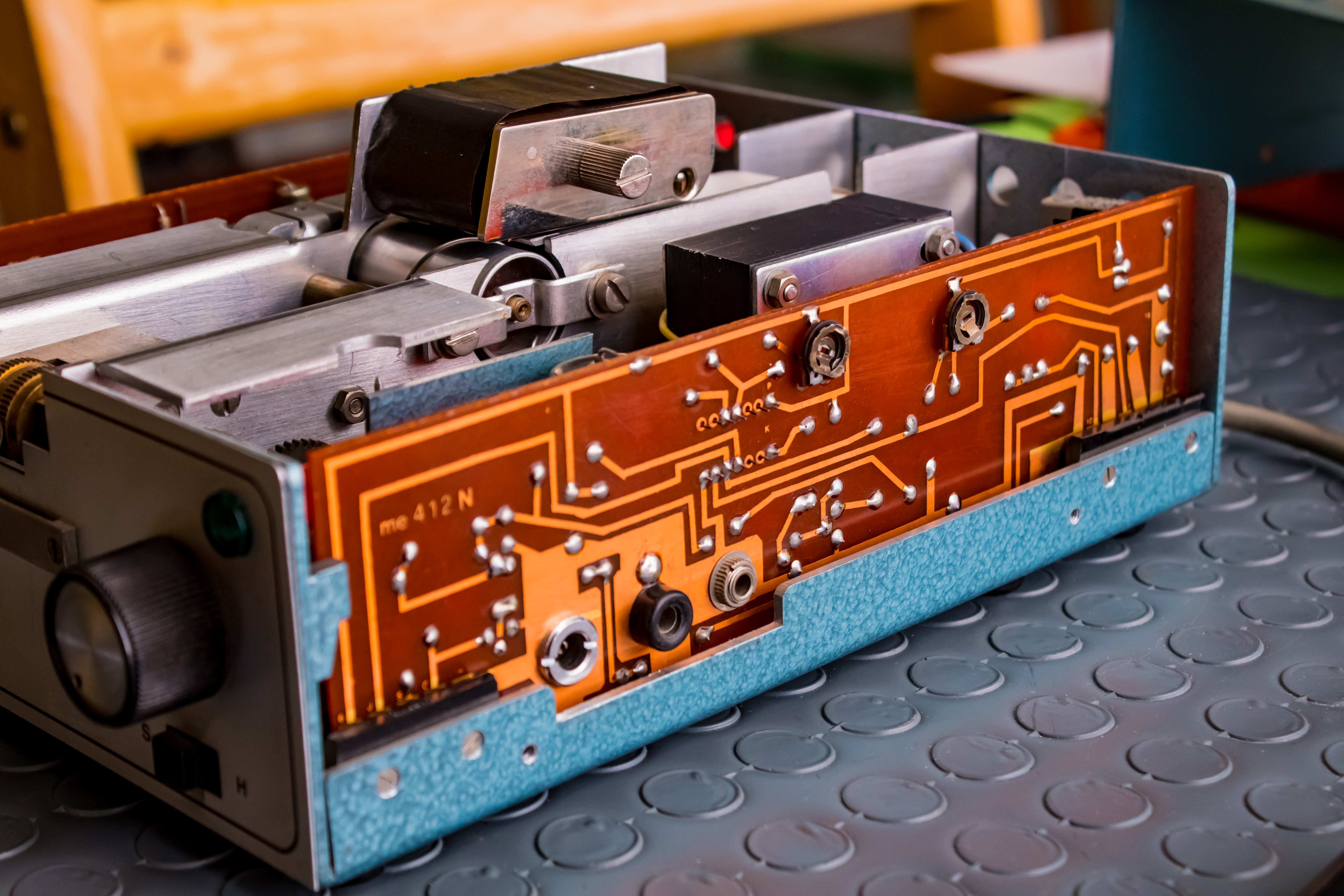

I have a great project, however my skills and knowledge on the subject are limited. Let's say that I inherited from a relative of mine, my father's brother, a watchmaker, this beautiful machine from about 1974.

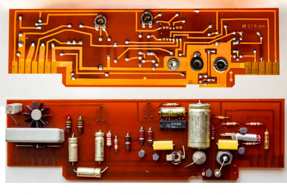

Although it is very well cared for, it does not work. I have inspected and I think the problem is with a zener diode (BZY92C10). Or a pair of transistors that activate the solenoid that hits the cylinder with the helical track that prints the succession of points.
PCB1.  The side tracks is rotate to match
PCB 2 Is rotate o mirror to match
The motor turns and the paper strip advances. But the characteristic sound of the impression tapping is not heard.
In fact I was able with the help of a tip to check current of 12-24 volts, I could see that at the output to the printer / solenoid, a pulse corresponding to the beat of the clock is generated. But it seems that the current is not enough to drive the solenoid coil.
The solenoid coil works if I activate it with a 9 volt battery. In other words, you can hear the “click”.
If any of you wish to join me in this project, I would greatly appreciate his help.
Thanks
As this machine is almost 50 years old one of these you want to be suspicious of is electrolytic capacitors. They do lose their capacitance with time.
