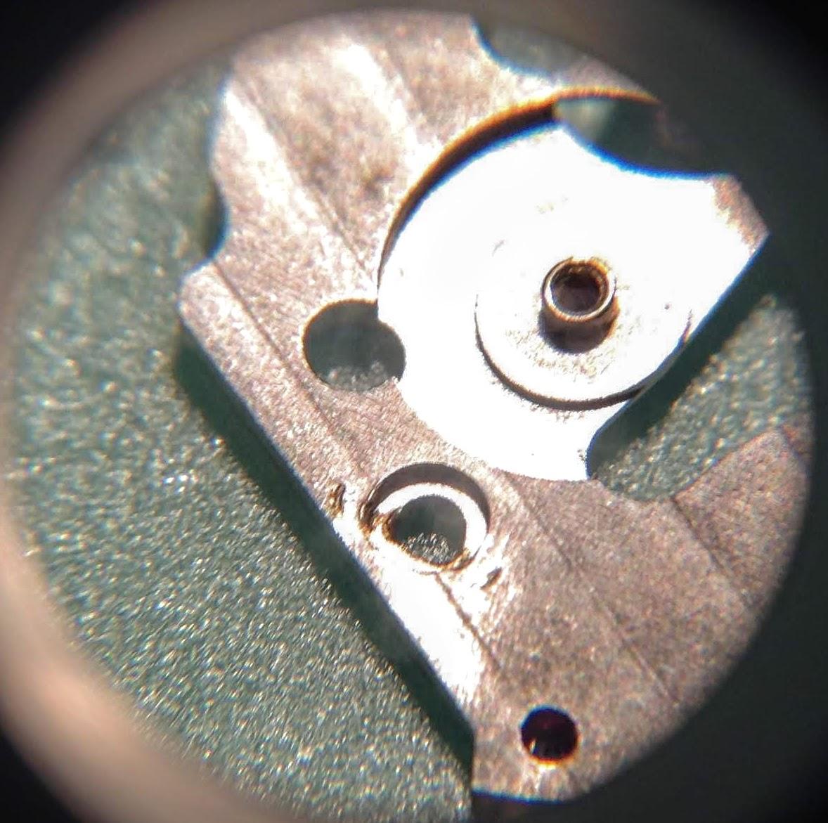

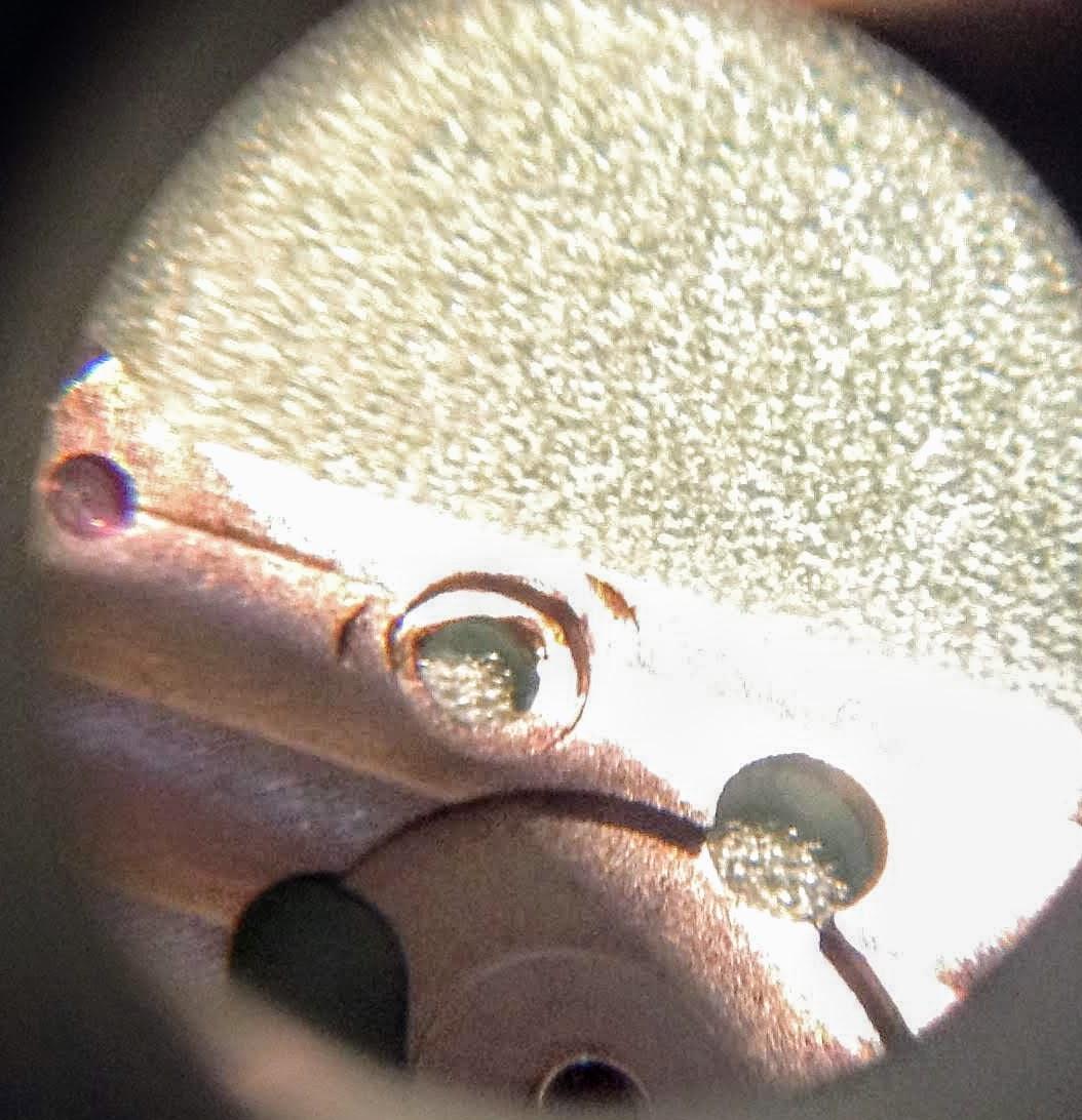

  1. Hi, in order to buy appropriate spares in my attempt to service an Omega 175.0083 (7750) I need some advice: 1. I've already been suggested to replace MS: Barrel is Ok and I'm thinking of buying a new MS and moebius 8217 for barrel lubricating as I don't want to spend money on recommended Kluber 125 grease. Should I consider instead buying a barrel complete (assuming Barrel complete (180.1) comes with MS installed) wich supposedly comes prelubricated ? 2. Attached image shows automatic device bridge with evident sign of wear from where, to my understanding, the problem orginated: a screw came off I cant find original part. ETA part is different from Omega in that the Omega is larger and partially covers hammer two function and the chronograph cam. Beside that and since the watch has no crystal back case I think those parts are perfectly interchangeable. Do I need to replace the bridge or are there alternative aproaches to this problem? TIA Giuseppe
