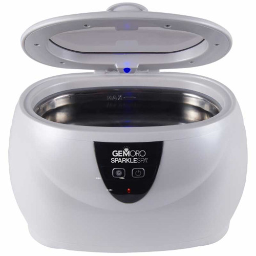

Yes, my ultrasonic has been busy with those small parts...no part has broke, even the smaller ones come out just fine. Do you have a powerful ultrasonic? Mine is a regular jewelry one but pretty good:
GemOro Sparkle Spa Pearl Ultrasonic Jewelry Cleaner 2015 New and Improved Model

Hi Bob,
yes, I have a quite poweful one. I only use 3min using a 1:9 cleaning solution from which smells like ammoia. Parts are really nice afterwards. But I also experienced that that it may harm the finish on older parts or parts of poor quality.
I have a set of tiny baskets. They are cheap and work perfectly. I have a sufficient amount and use one basket / cage for only one department of the tray, for instance the barrel bridge and its screws. I still tend to confuce the screws so I keep them with the assemblies where they belong.
