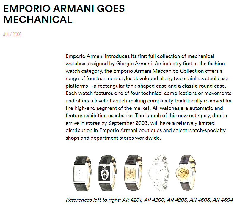

I found attached article of its release and probably one of the other tank models would also work.
Maybe one of the other members has more info on the movement used for this model, then you could try to find a replacement stem and a (generic) crown.
