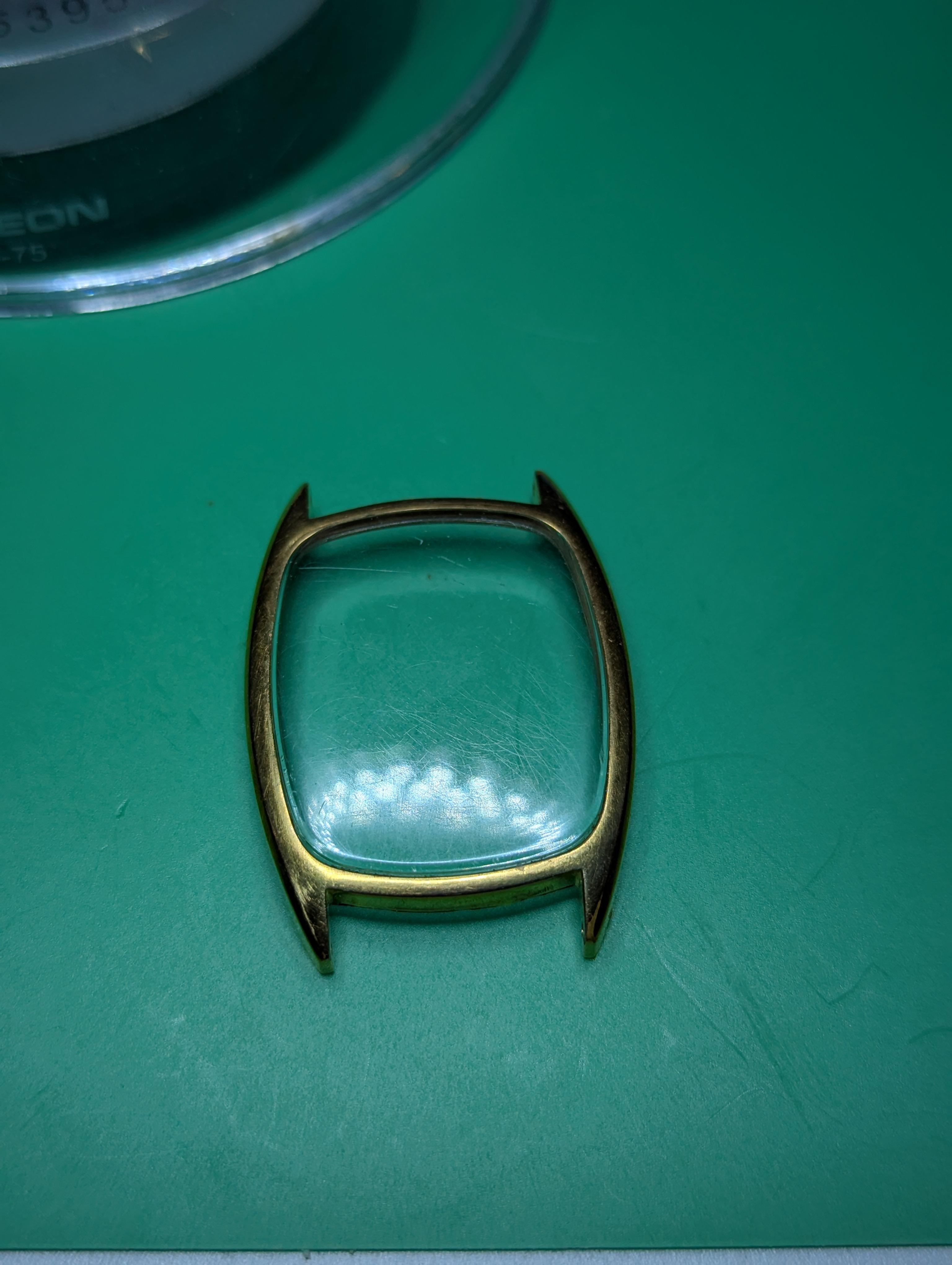

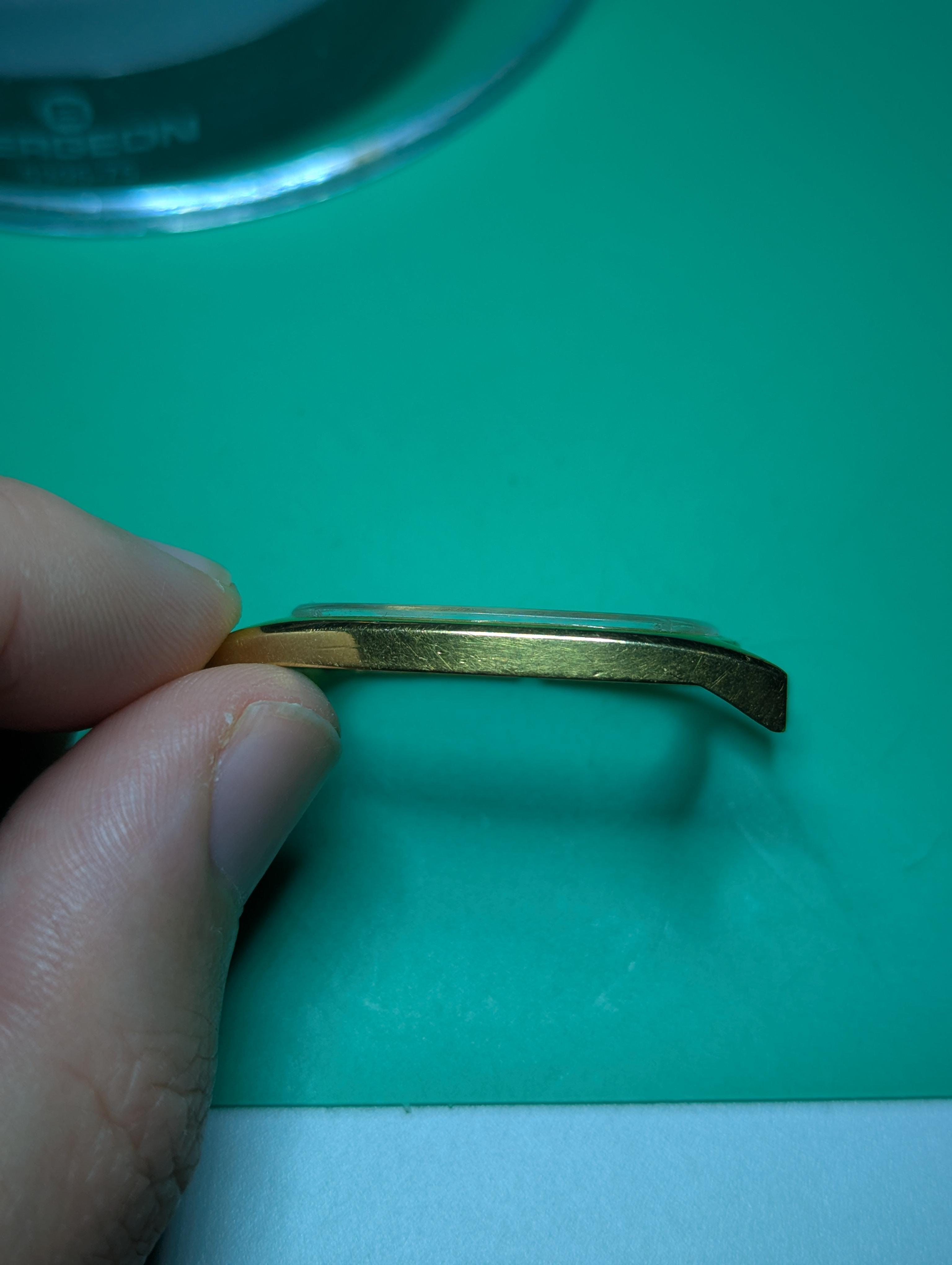

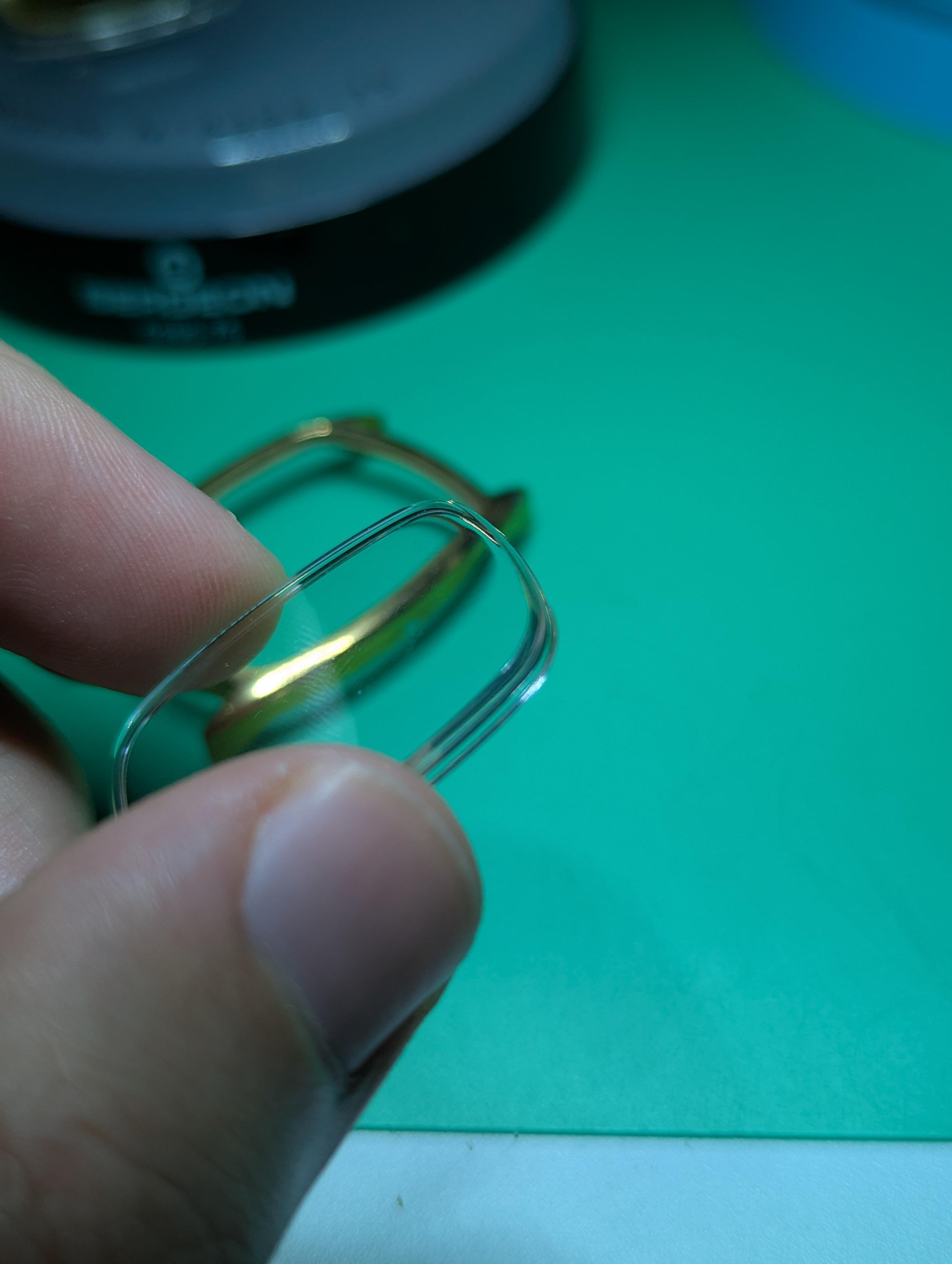

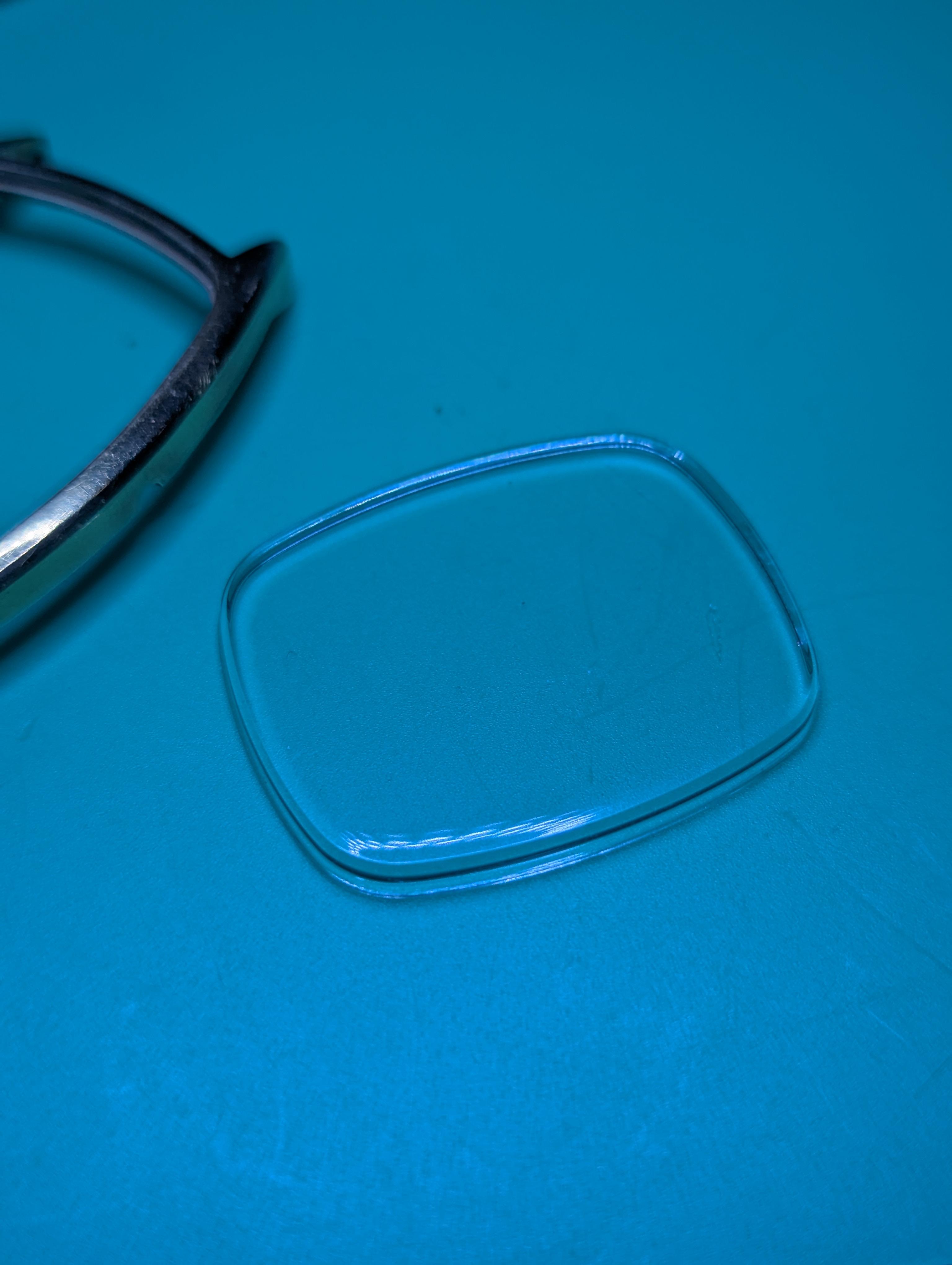

Seeking advice on installing watch crystal.
I start with one long edge, then the 2 short ones, leaving the other long one till last.
Sounds like this might be the way then.

that's how I've always done them. Start at one side and work your way around feeding the edge in with your fingernails. If you hit a spot that won't enter, check that the edge isn't getting damaged, if so remove and feed that bit in first. if it's really tight you may need to reduce the size very slightly.
