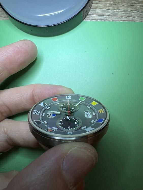

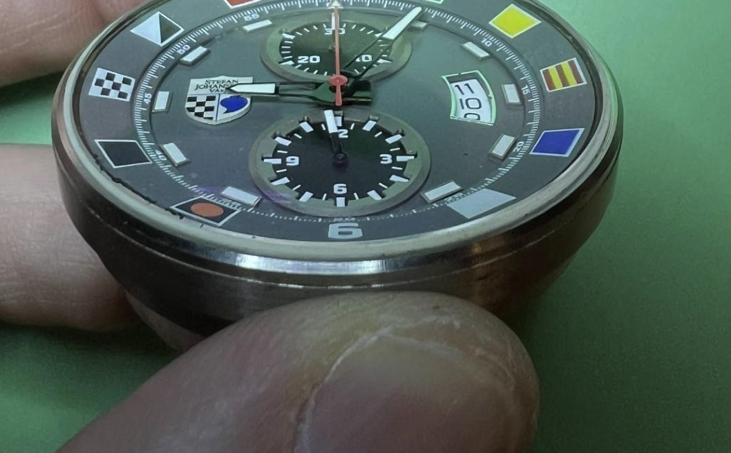

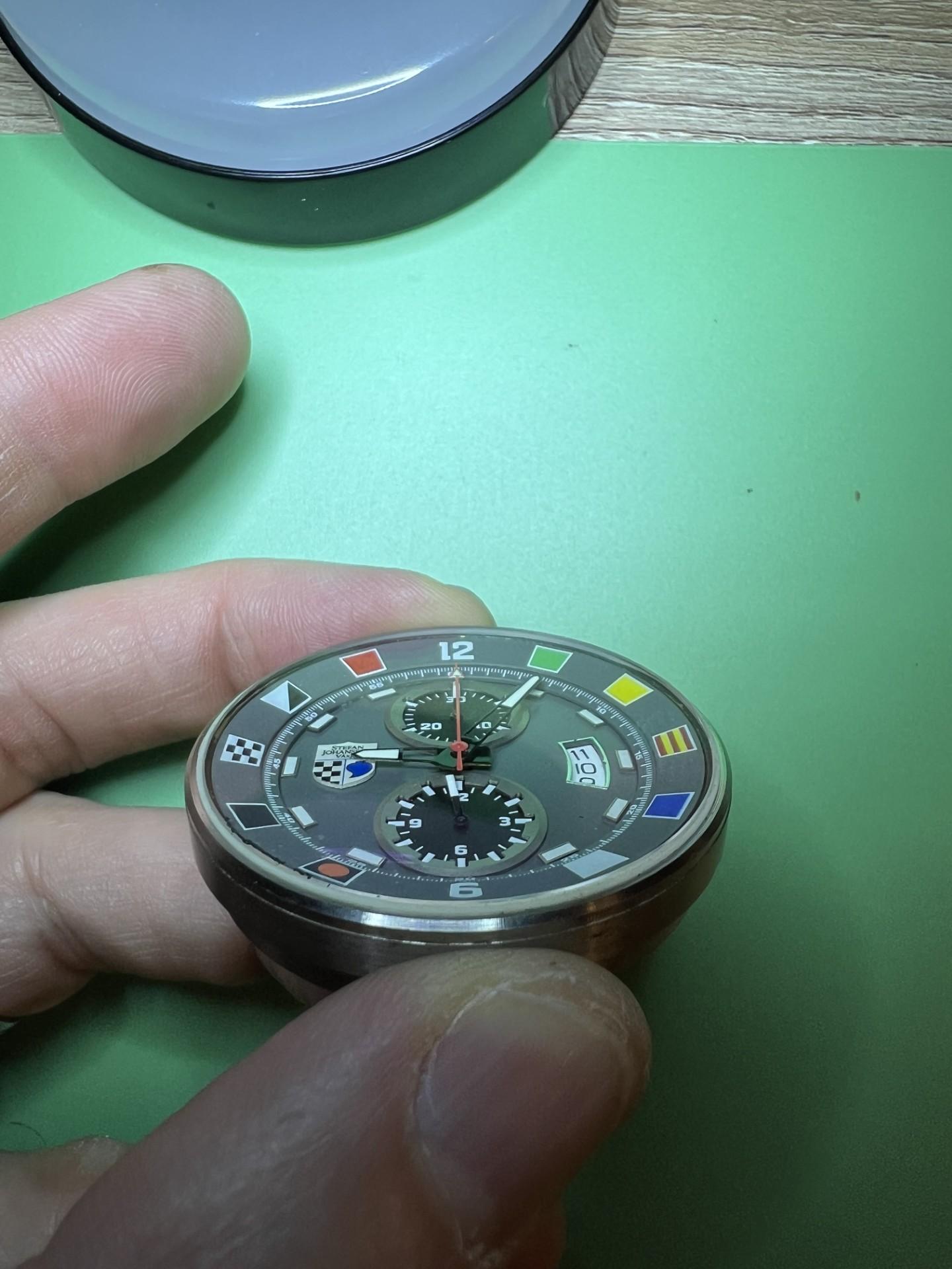

Anyone ever work on this watch before?
I've been enjoying this hobby for a while now and have had some decent results.  Am progressing nicely to more and more complicated movements,  but man, for the life of me, I can not figure out how to remove this ETA 7750 from the ring around it.

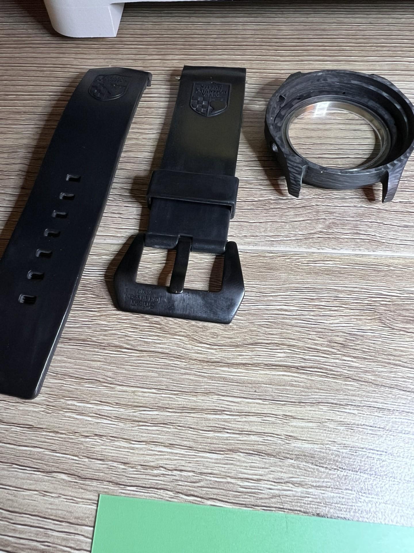

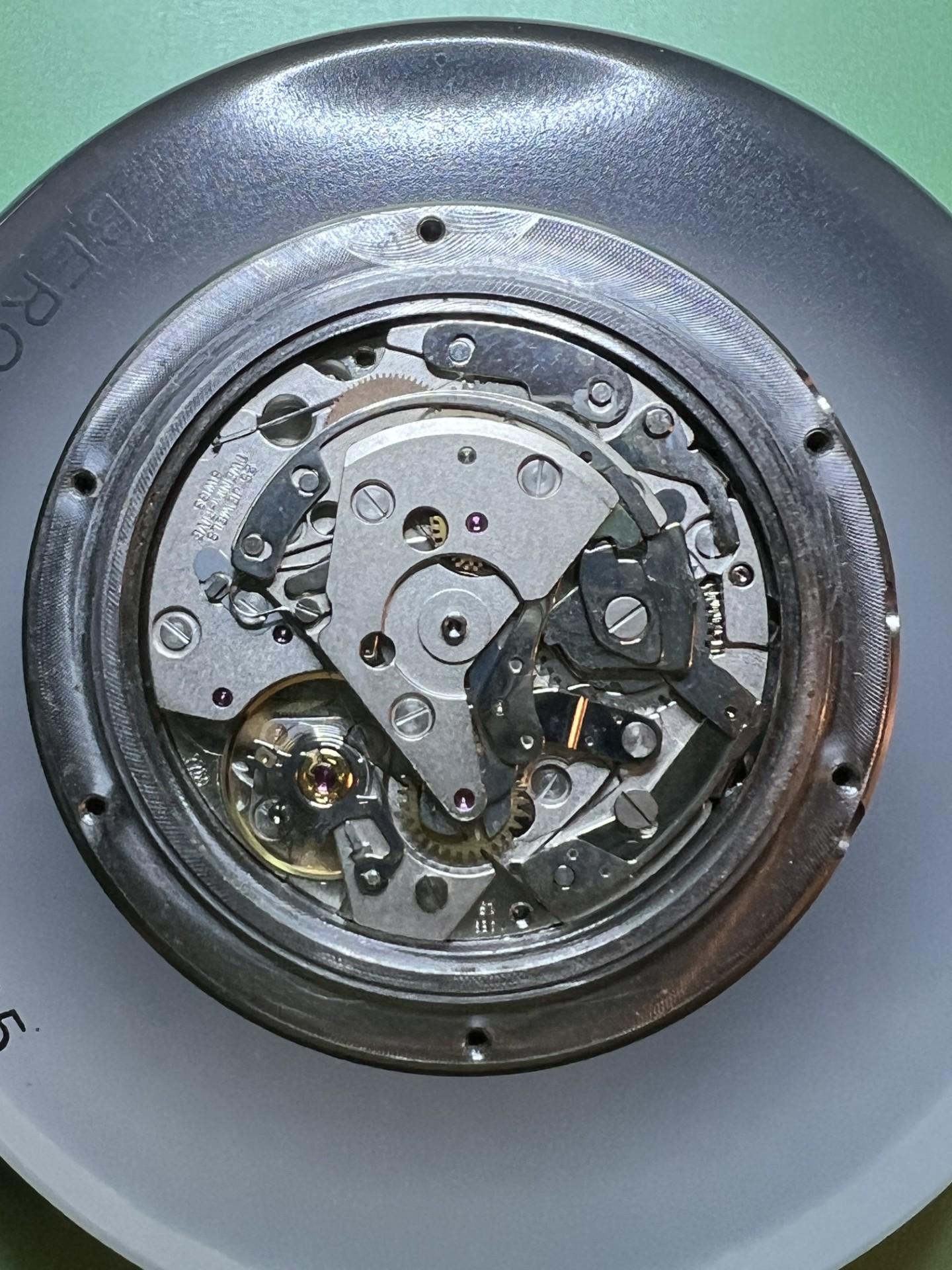

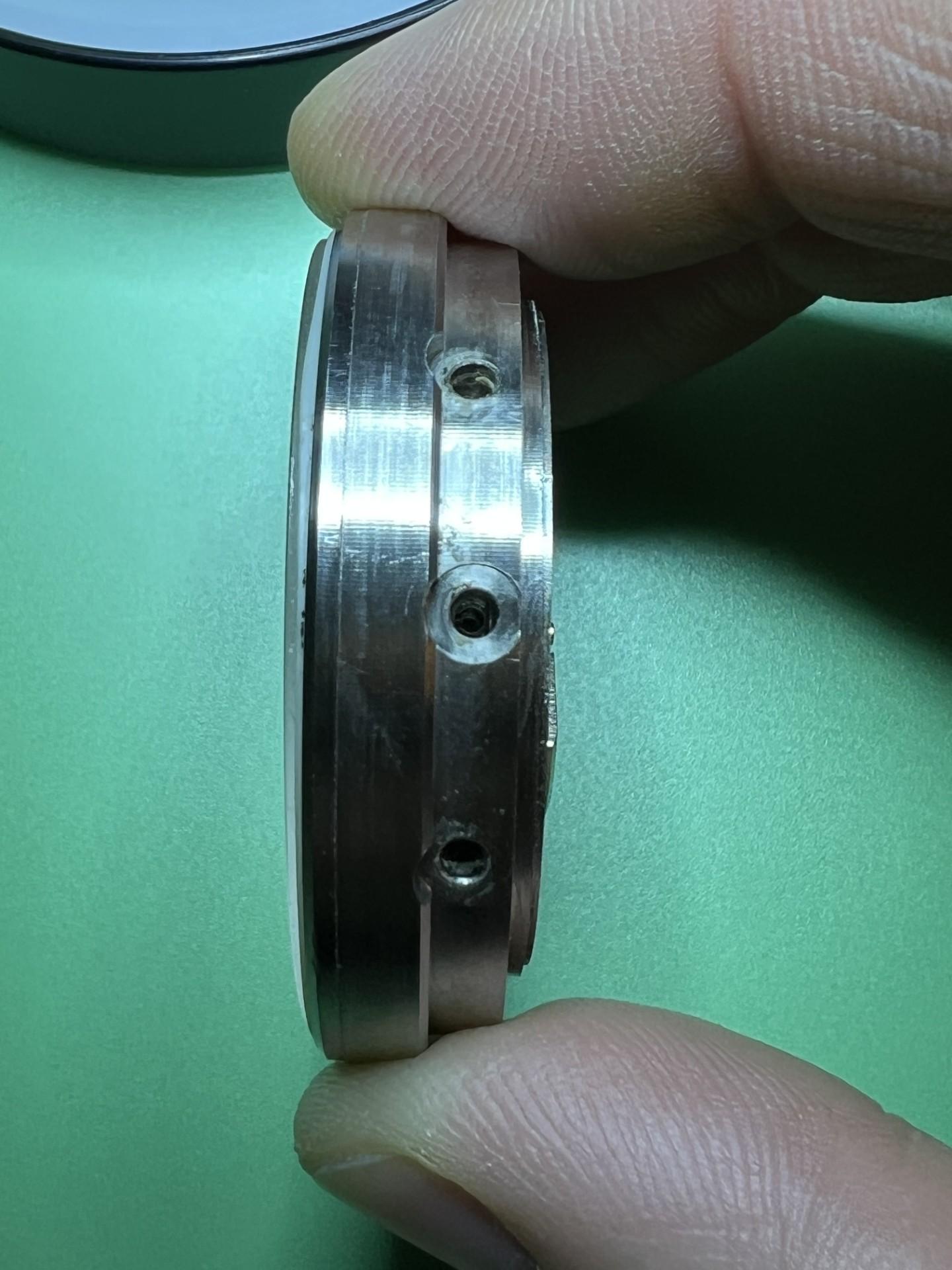

I've successfully removed the movement and its holder from its outer carbon fiber case, but cannot remove it further.
I've removed both pushers and the stem and it, frustratingly,  doesn't simply drop out when inverted.  It also doesn't rotate from side to side within the outer movement holder.. it is stuck fast.   I'm a little embarrassed honestly.

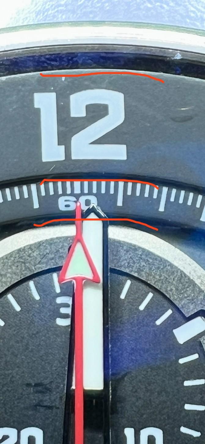

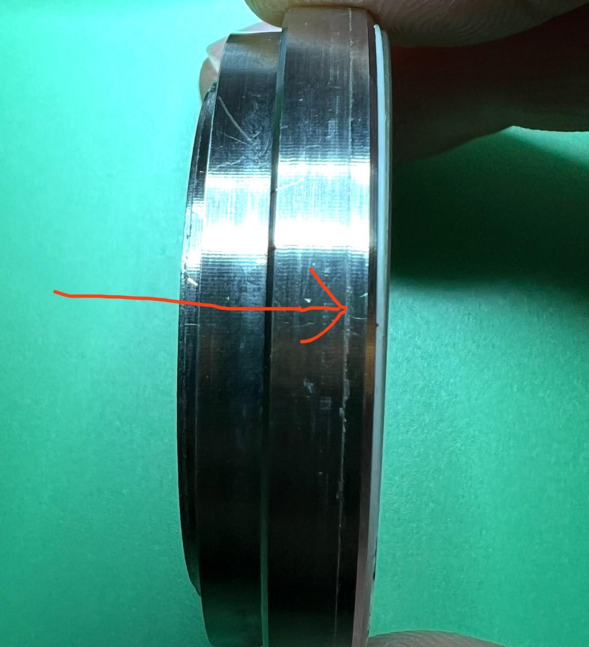

  The red arrow points to a line in the movement holder, but it is seemingly one piece and not separable there. I guess they just needed to reduce some outer diameter there.

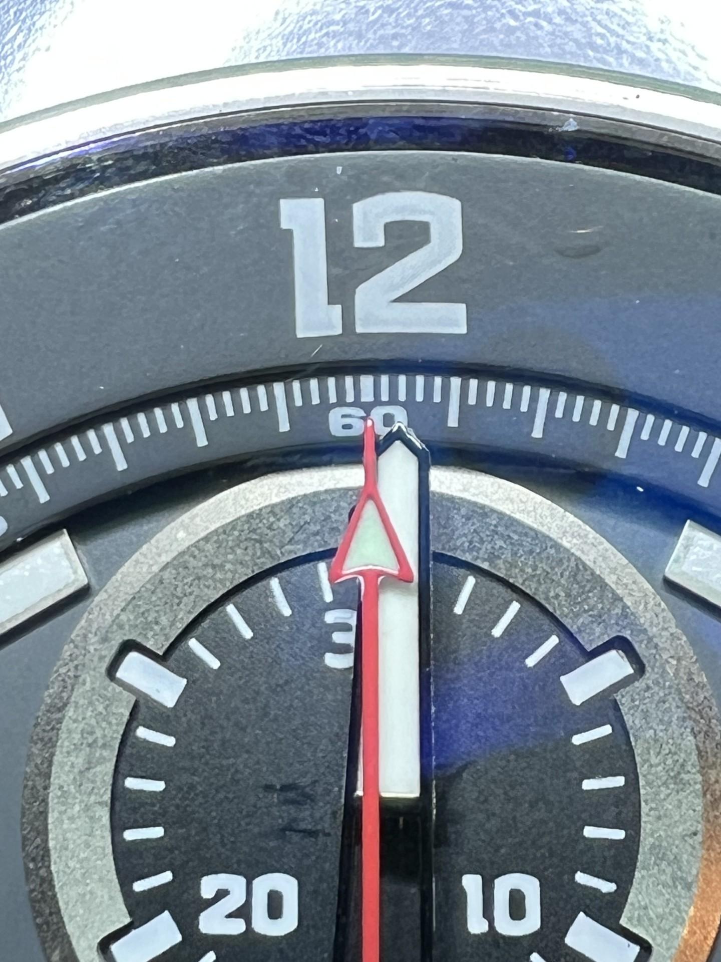

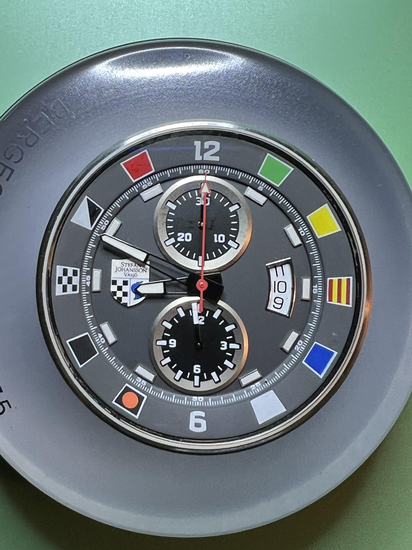

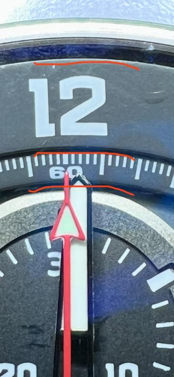

The ends of the minute and chronograph hand extend over the minute marking ring so would that mean that that minute marking ring is part of the dial attached to the movement? I guess I'm asking where does the dial end?
Any point in the right direction would be most welcome. I've never worked on this movement before and I am chomping at the bit to do so.  It represents the next challenge in my progression. But obviously cant start until I remove it safely and I'm stumped!

I'll check again ,  but i believe it to be one piece.  Although,  I agree the photo makes it look like it's split-table there.
If that is not the removal method, what else could it be?
