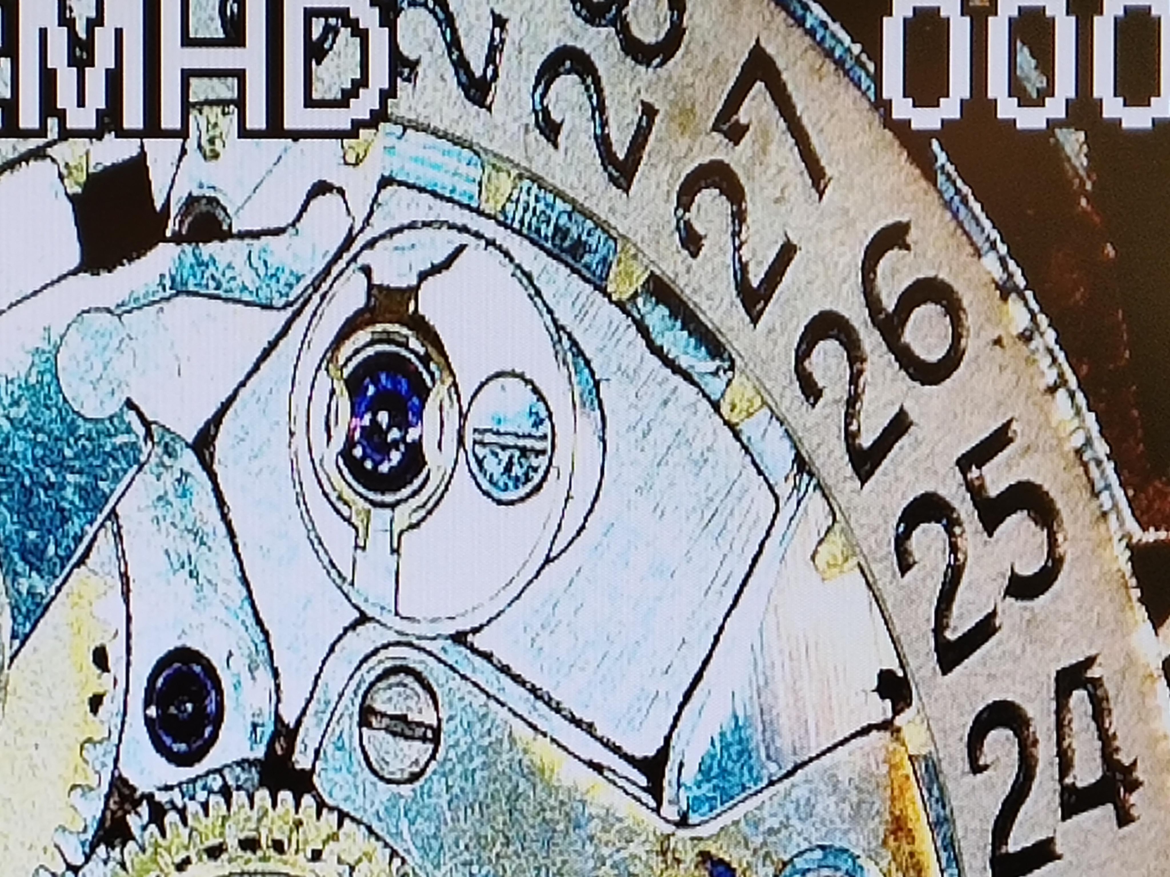

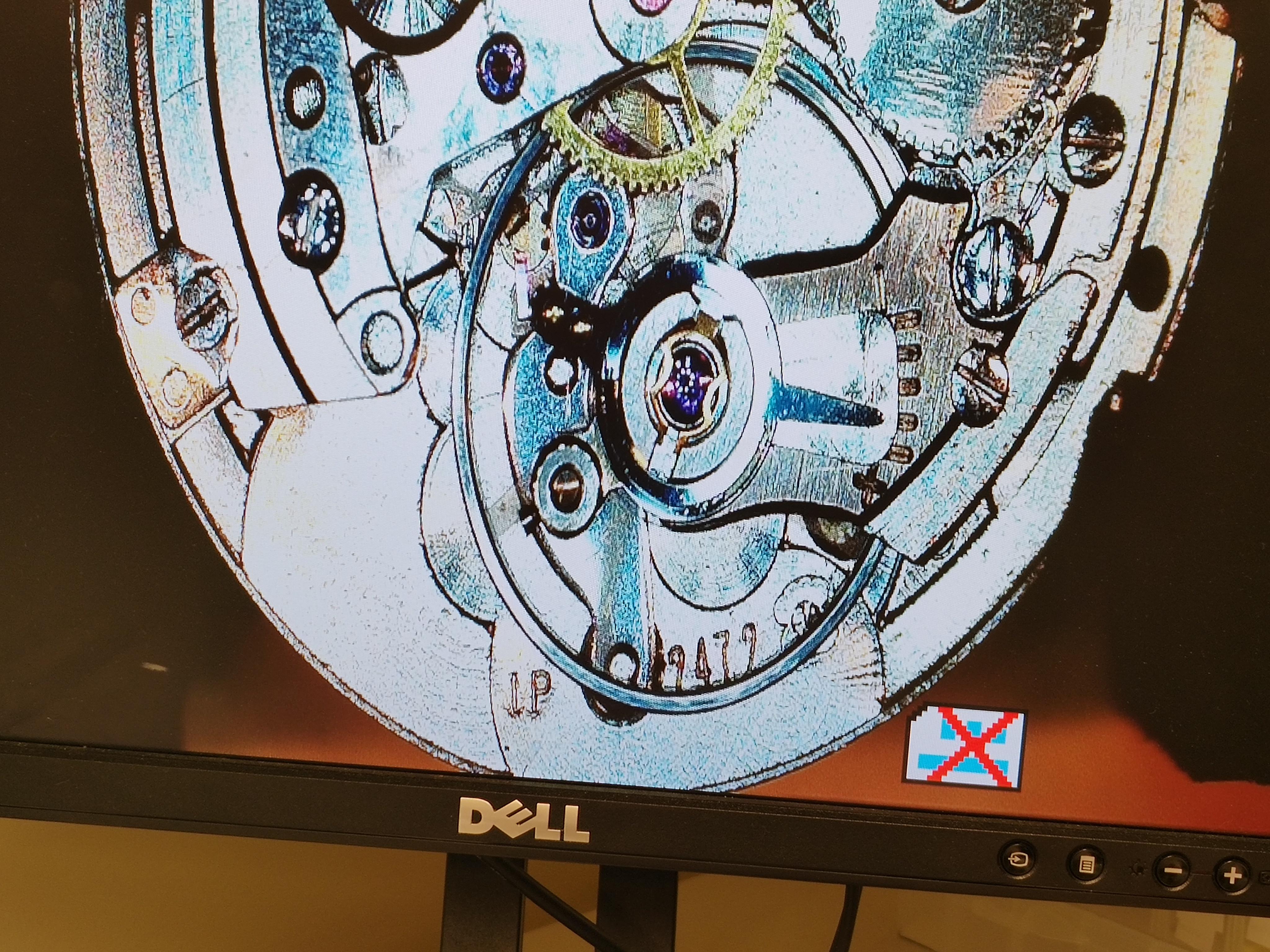

Everyone,
I'm working on an ETA 2472. Everything has gone well so far. However (there's always a however), when I install the balance it starts up just fine. When I tighten down the screws to snug, it continues to run. When I tighten the screws, the balance stops dead. The upper jewel is an Incabloc setting held in place by a u-clip on the underside of the balance cock. The lower jewel is an Incabloc setting held in place by a screw. I'm pretty sure the balance staff is straight and has no issues.
So, I need some advice:
1. Do I live with the screws in the snug position and hope they don't back out?
2. Try to install a shim in between the main plate and the balance cock. I used a dial washer on another watch for a similar problem and it worked.
3. Adjust the height of the jewels within the Incabloc settings. If so, how does one do this? I do have a Horia tool.
Thanks,
MikeCJ
