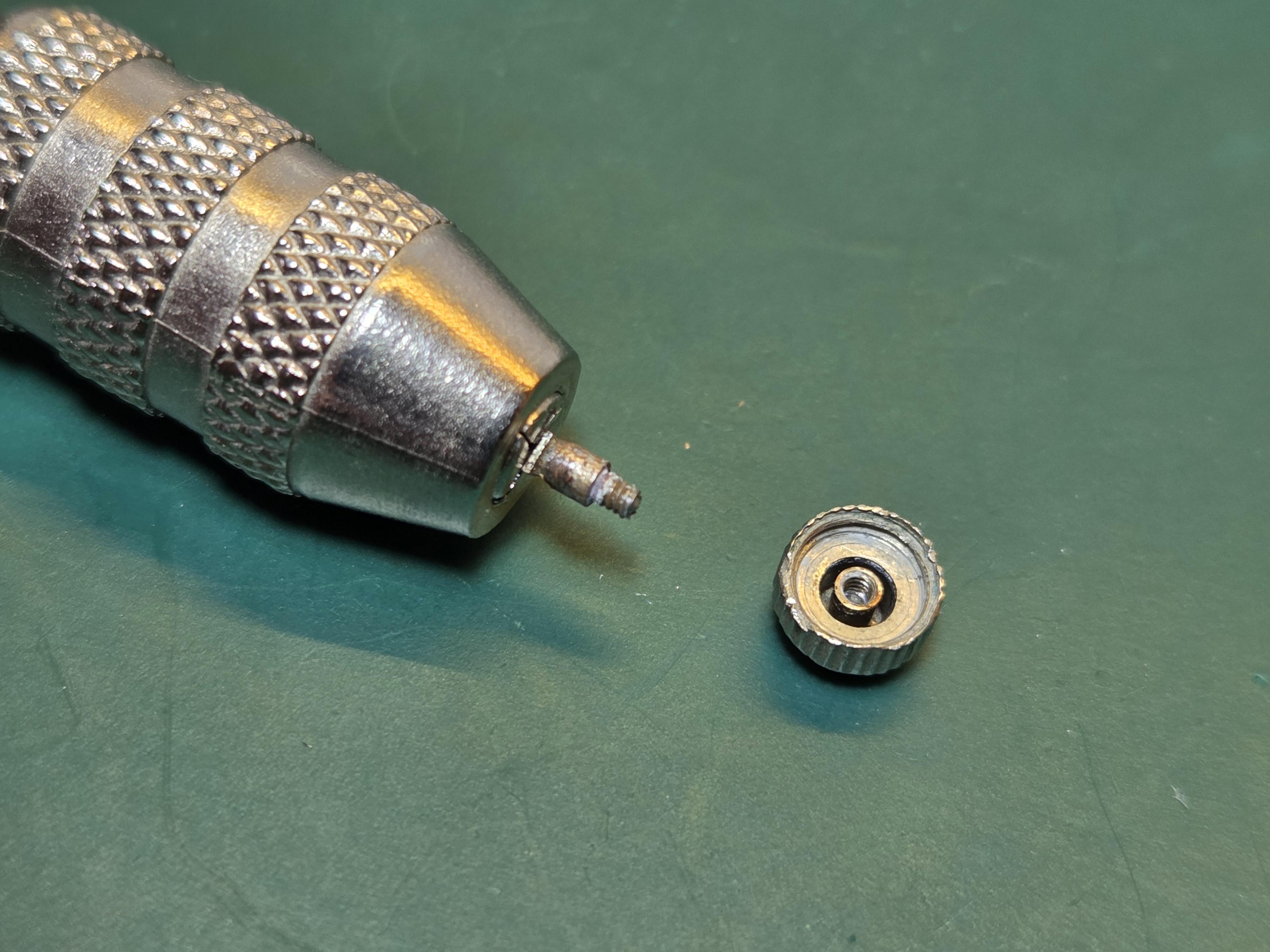

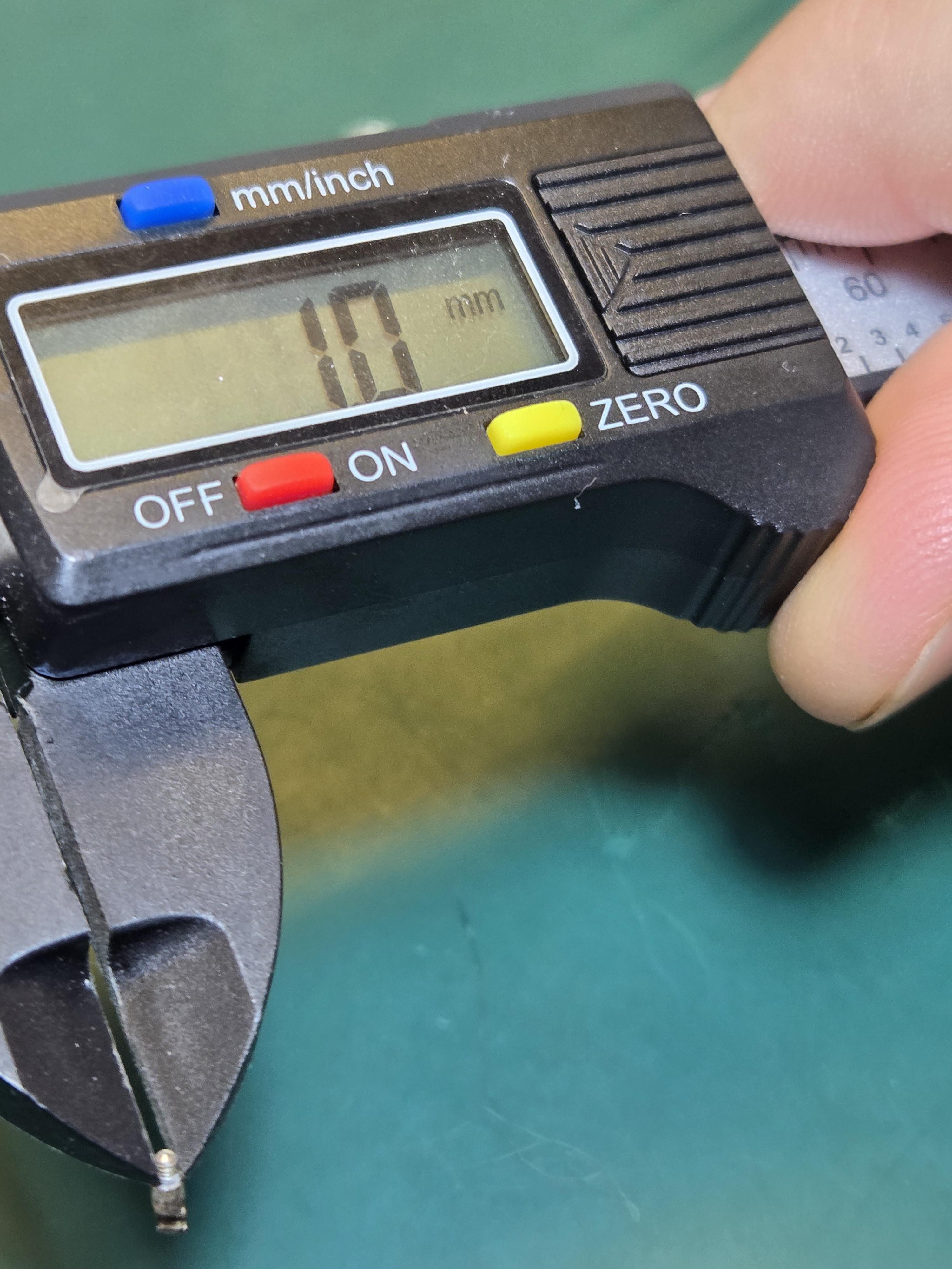

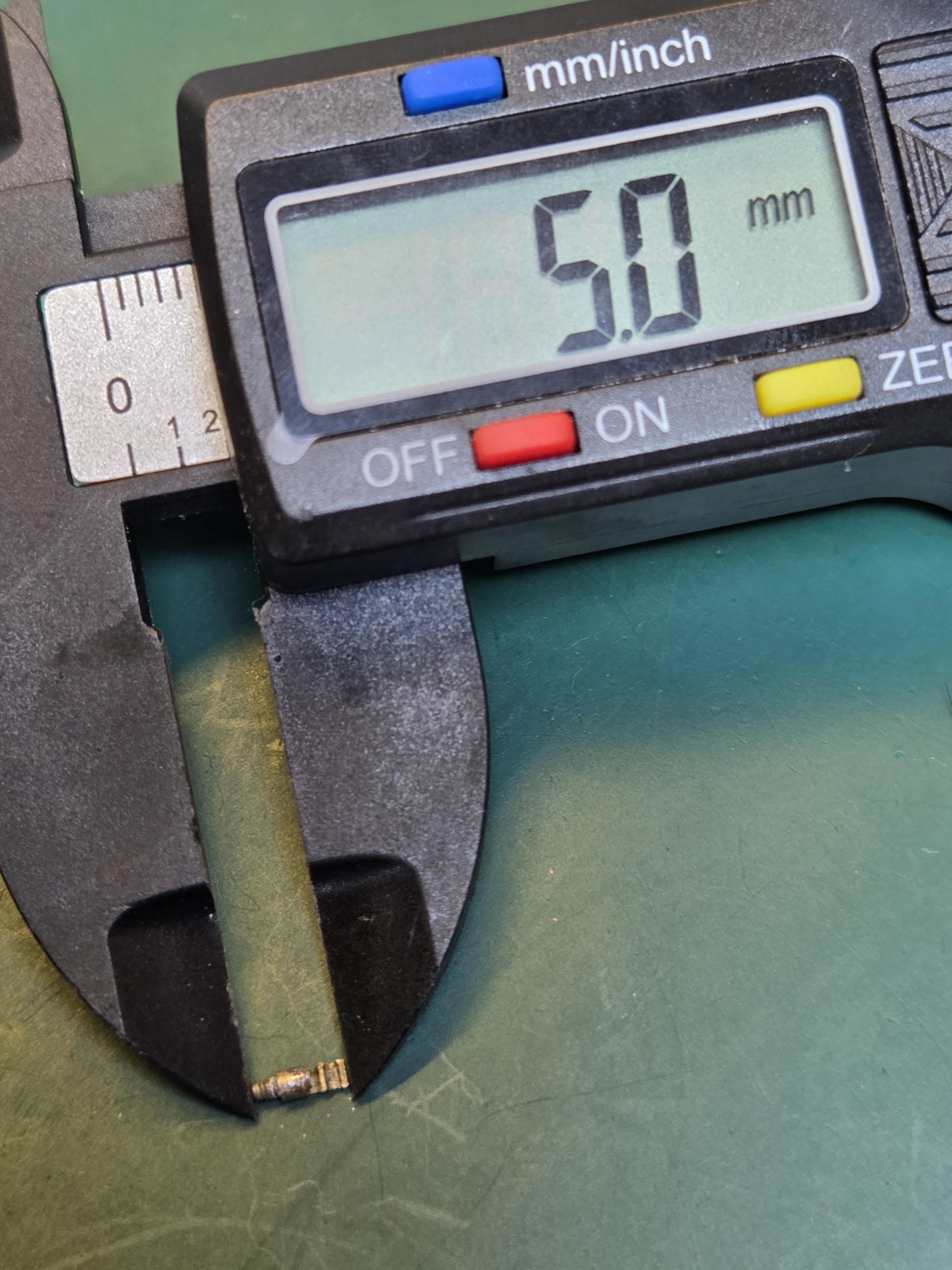

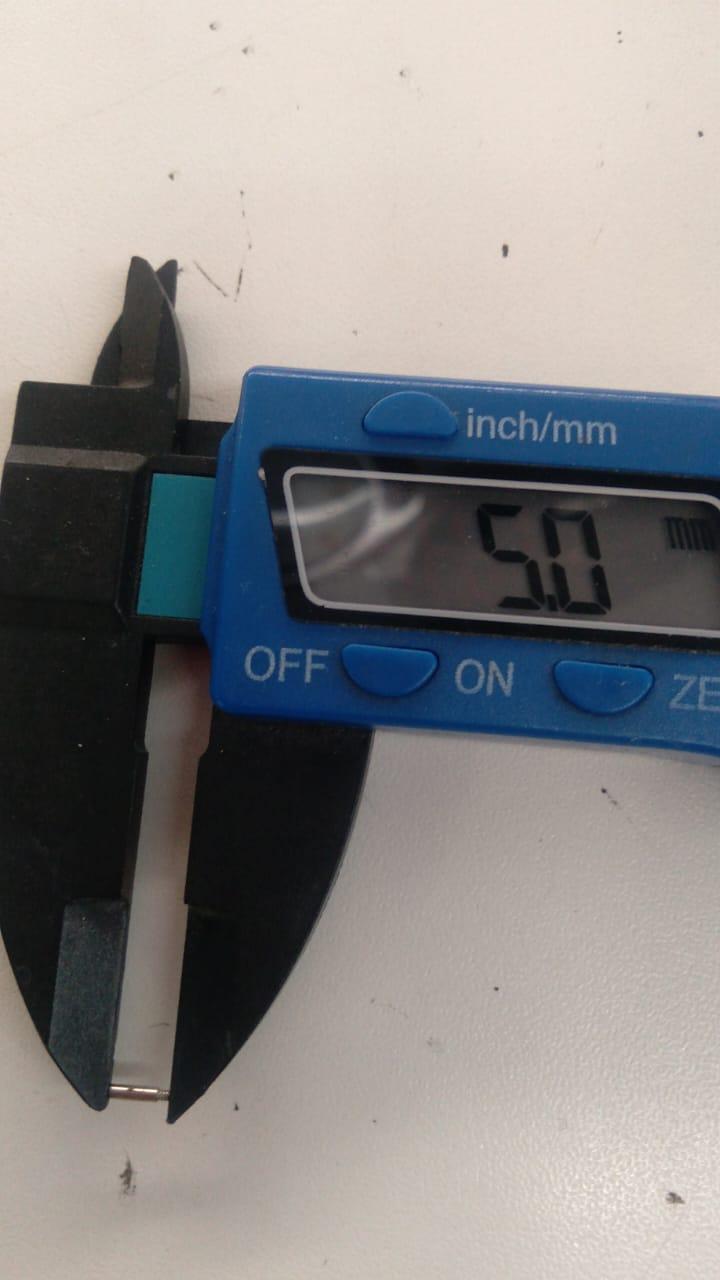

I am planning on making some homemade Etachron tools from brass rod. This will be flattened and formed into a a flat crescent, with a slot filed into it that will act as a wrench for turning studs. Would steel be better? I could use pieces of old mainspring that I have annealed to allow them to be filed to shape. Does anyone know the dimensions of the studs? Are they all the same? I know that there are differences between Seiko and ETA. I only have one watch on hand with Etachron (an ETA based movement), I can measure this but I don't know if that would do for all ETA based Etachron.
I made some similar probes out of 3mm brass rod. Chucked short sections in an electric drill and did rough shaping against a file. Followed by an oil stone and them progressively finer emory cloth. Very useful tool for shock springs.
