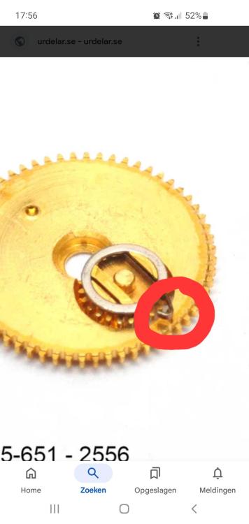

The date wheel is supposed to have a small spring that moves out and pushes the date wheel. It is a known point of failure.. Does yours have it? See picture below:
