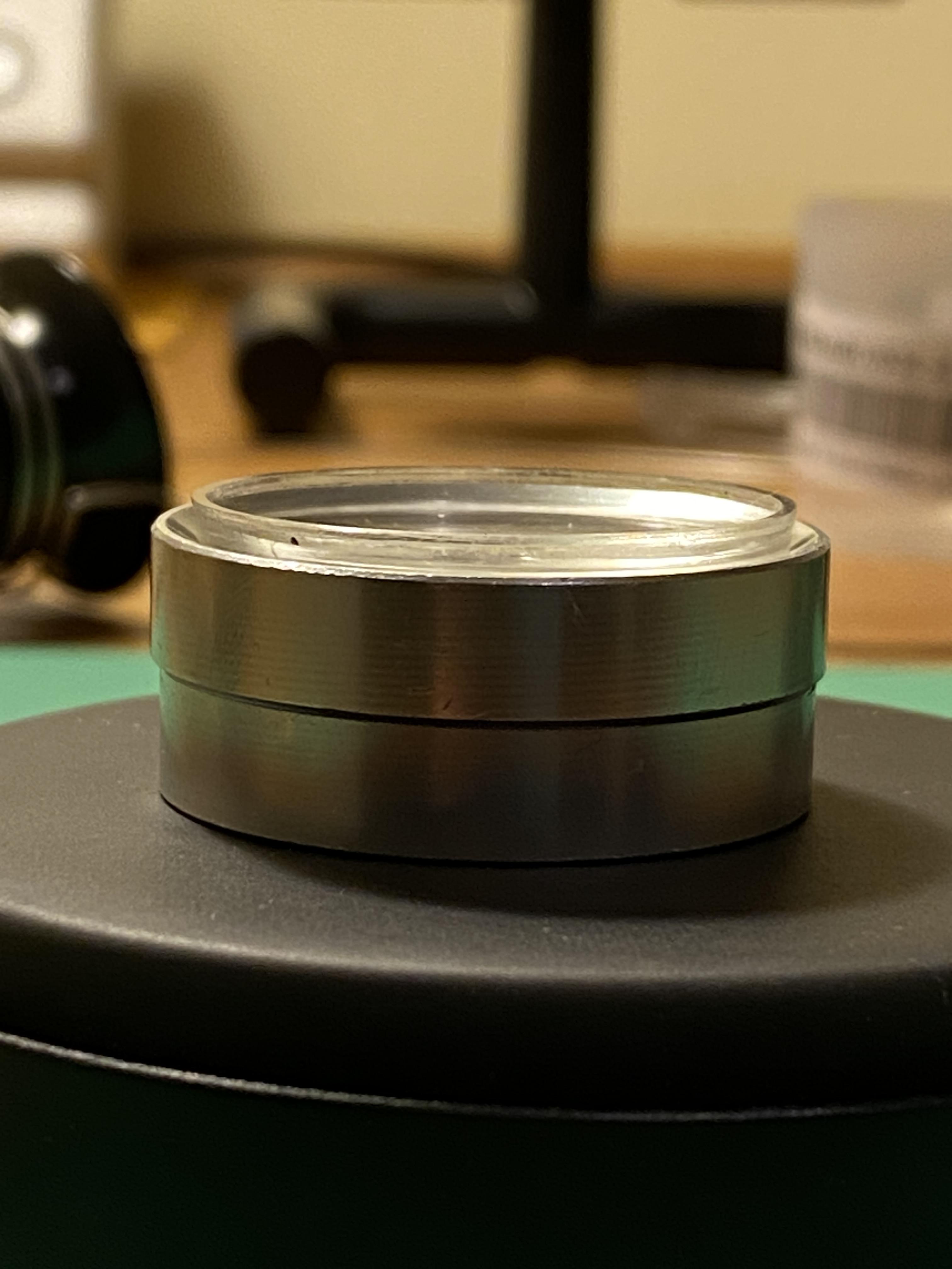

I have attached photos of what I was doing - although I should say that I just tried it again and it worked.
The watch is an old Rotary one I bought to practice on. Took the crystal off with a crystal lift and using the press to put it back on as a test.
As the movement is in the case I used one of the flat dies for the base and the 35mm die on the top. The crystal measures 30.9 - is the a direct link between the crystal size and die size?
I think I may have used too big of a die in the top last time (still trying to get a feel for how to size the die to the crystal).
I could put have put this crystal back with the lift of course but I understand that for the tension ring crystals it’s best to use a press to insert them.
For me if it comes out with a crystal lift it goes back the same way.
If you're using the press the die should be slightly larger than the O/D so would have expected you'd be using the 32mm.
If the case back is fitted I'd use a domed die so it sits inside and is central.
