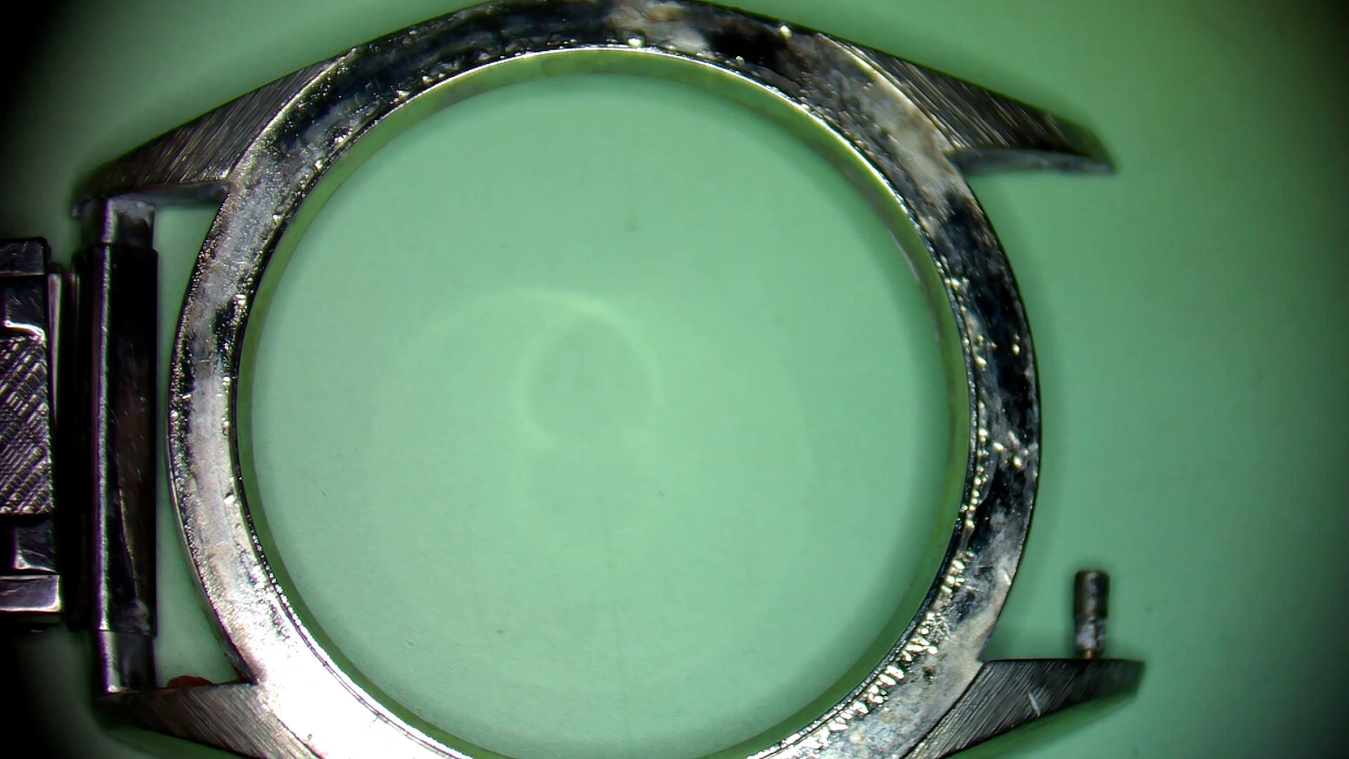

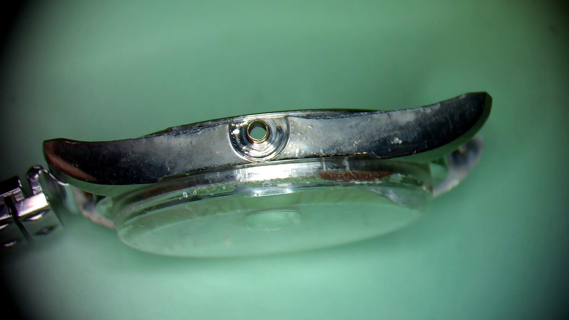

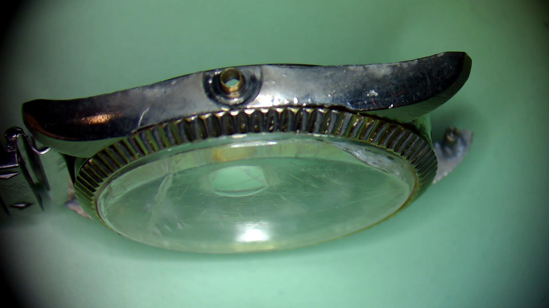

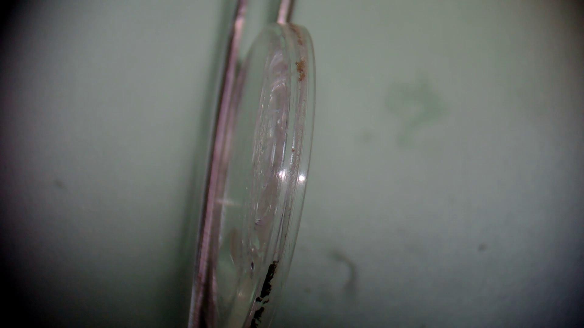

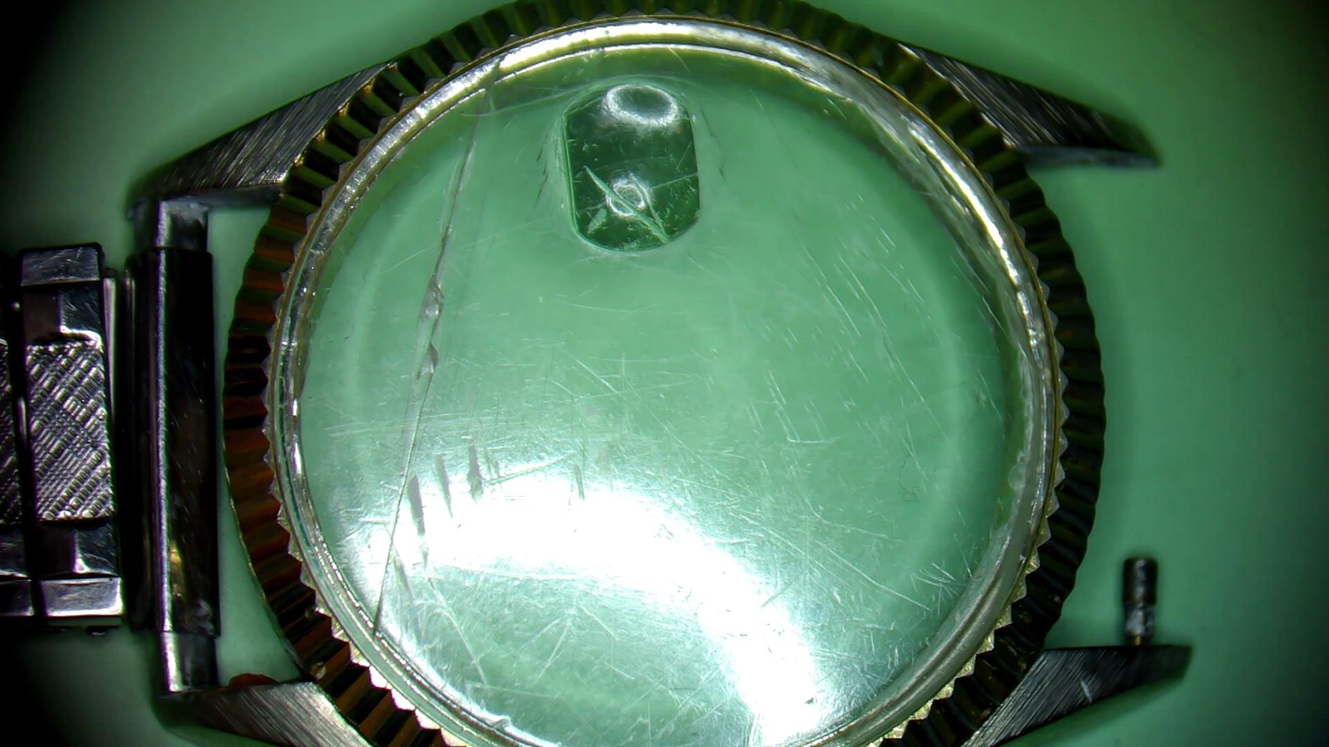

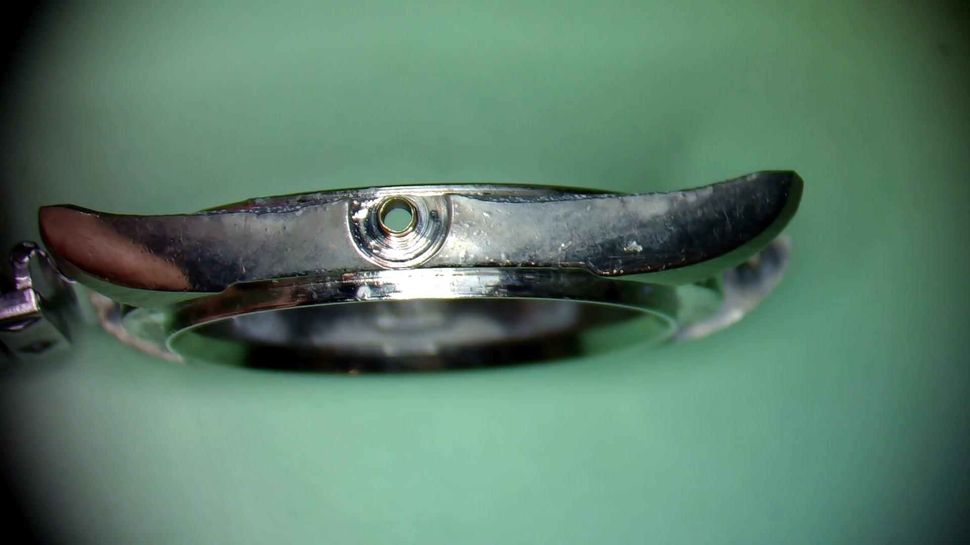

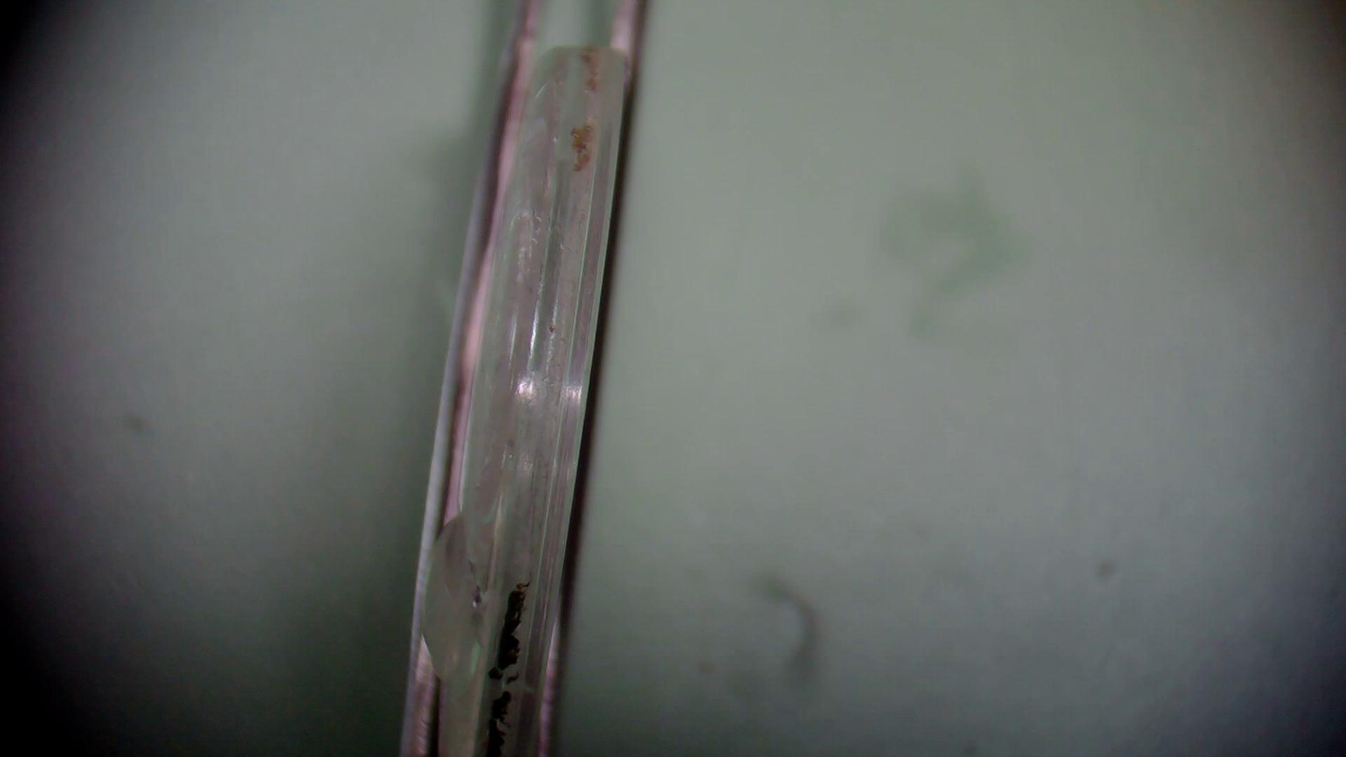

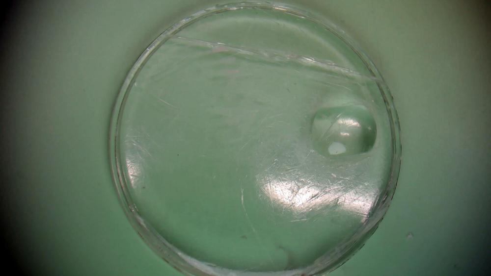

Hello. I'm looking at two types of crystals from Cousins supply house in the UK. Both are the same size and material, except one is SR (Steel Ring) and the second is GR (Gold Ring). I don't know what the terms mean in relation to the watch I'm working on. I plan on gluing the crystal into a metal bezel. Which one do I need to purchase? It's an inexpensive watch. I've written to Cousins directly, however they won't advise on the type of crystal I need - even after including pictures.  Can someone advise me if I'm on the right path or can you suggest an alternative?
Thanks in advance for any help that can be provided.
The Cousins Item Numbers are G22738 + G22739
Current Crystal is acrylic - at least that's what it feels like to me.
Outside Diameter = 31.09 mm
Inside Diameter = 29 mm
Height = 3.81mm
Domed Surface
Cyclops
Acrylic
Glued in place to Bezel
Bezel glued onto watch
The ones you're looking at on Cousins are Tension Ring Acrylics hence the Silver or Gold to match the watch case.
Why are you planning on gluing it in place as most domed crystals are tension fit either with or without a ring?
Edit
What's the diameter of the case opening and what does it look like?
I think you'll be better looking at something like these.
https://www.cousinsuk.com/product/high-dome-with-calendar-lens-sternkreuz-cl-clh
Edited by AndyGSi
This is more awkward as the key dimension is the I/D of the lens but most are listed with O/D only.
20 minutes ago, mcoulton said:
The diameter of the case opening is 29.58 mm.
Is this the I/D of the lip or O/D?
Edit
Here's an example of what you'll possibly need.
Edited by AndyGSi
I think you're in for a bit of trial and error with this and would need to add the date bubble to a blank lens.
You may get away with a Sternkreuz HW or HWS
