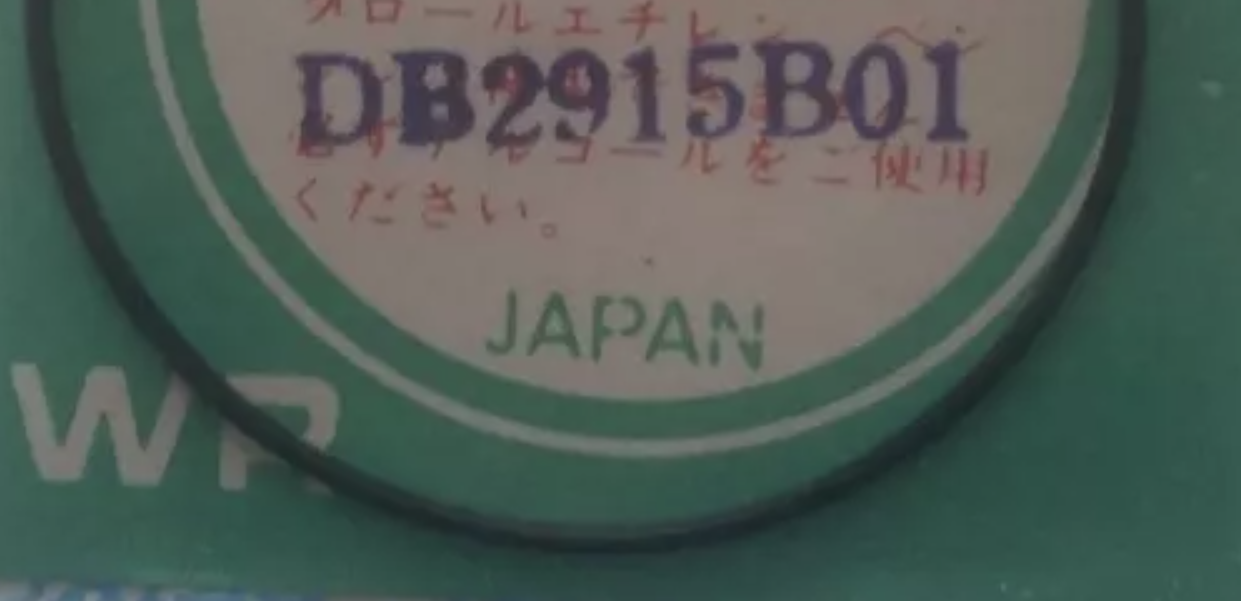

Looking for Dimensions of Seiko DB2915B01

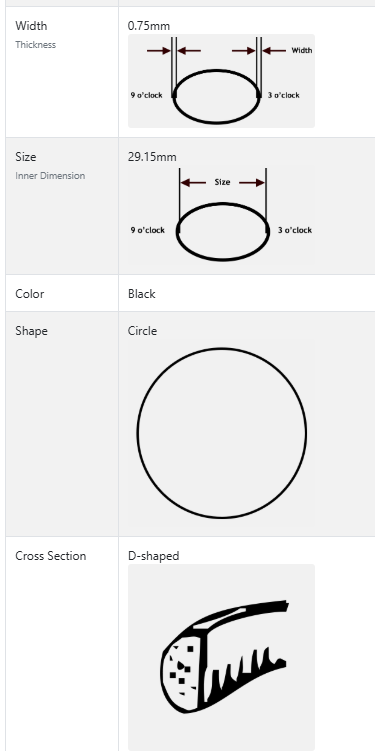

Have a look at this discussion where I show what I use.
